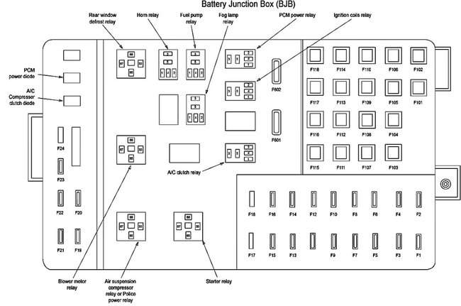

What do i do for a code p1633?
2008 MERCURY GRAND MARQUIS
191,700 MILES • 4.6L • V8 • 2WD • AUTOMATIC
NIGHTBLADE53142
Engine light came on one day so i checked the code but i am unsure what i need to do about it. Any advice or help would be appreciated.

Yep, this means the voltage in the system is too low, when the engine is running do you have a battery warning light on? If so the alternator might be to blame as it is not charging.
P1633 - Keep Alive Power (KAP) Voltage Too Low
You can use this guide to confirm the alternator is working okay and if so, I would replace the battery.
Please go over this guide and get back to us.

Battery light would come on once in a blue moon but when i tested my battery and alternator the tester said they were good, but the battery is starting to get old so i could try replacing that.

Okay, also, check all fuses int he under hood fuse panel, you might have one that is out.
This guide can help:
Please go over this guide and get back to us. Check out the images (below).
