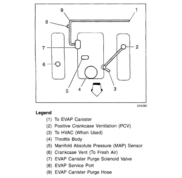

I attached a vacuum diagram.
Can you upload a picture of the three way valve?

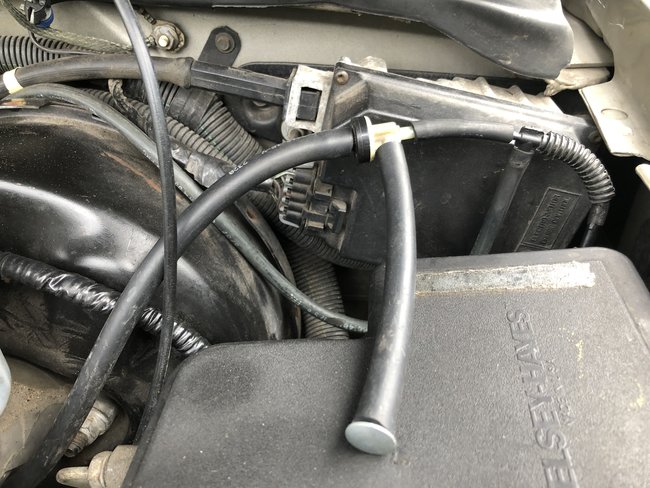

Here is the three way value I was talking about. The long line to the left connects to the manifold not really sure where the one short one was, it was like that when I bought it. And the one to the right goes down and wraps into the electrical wires harness but do not know where it comes out at.
Oct 1, 2018 at 2:57 AM
That line is for the operation of the vacuum motors inside the truck. That is a vacuum check valve that uses manifold vacuum to the control head for the AC.
The blocked off line is okay. originally, there was a big vacuum tank. The replacement was this valve and they said in the instructions to block off the line.
