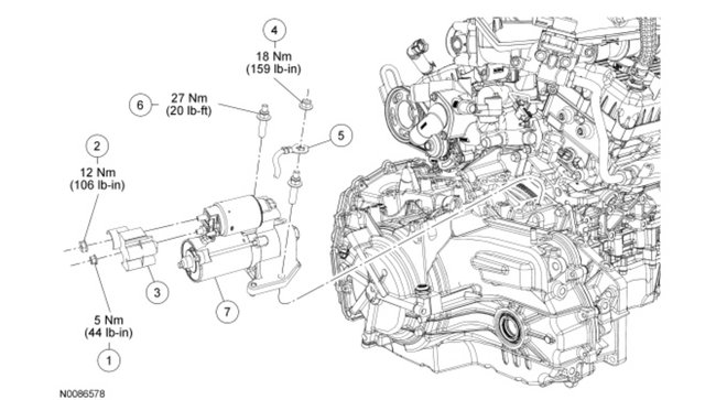

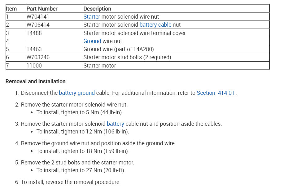

When the starter was replaced, what brand was it? it sounds like it failed again, which is common with cheap rebuilds. I would check for power at the trigger wire (small wire) when in the crank position, or smack the starter in the crank position if you have power or the starter starts to work it is bad, I would get a AC Delco or Motorcraft unit. Here is how to change the starter out, instructions are in the diagrams below. Also use the guide above to help you test the trigger. Check out the diagrams (below). Please let us know what happens.

It was actually done at a Ford Dealer. I would assume they put in a decent starter.
Jun 16, 2022 at 11:37 AM
  • 55,710 POSTS
Yes, they should of, but we still need to see if there is power at the trigger wire when in the crank position, even good parts can be defective. Please follow the guide above.
