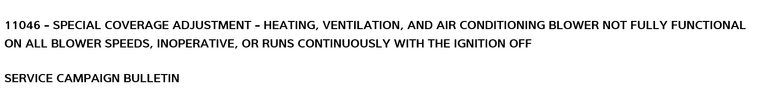

the other day I was out driving and using the air conditioner a lot when I got home I shut my vehicle off then the next day it would not crank, bought a new battery it started right up. then two days later when to go run errands and it would not do anything. I noticed last night after charging the battery and stating the truck and then shutting it off the back seat on the roof inside the vents were blowing air. my spouse and i took out the air conditioner relay and fuse and it still did it, along with if you push the button for fog light all my lights inside truck go away. I also smelled rubber burning for like thirty seconds the day before it died. What is wrong with it? what is draining the battery? I am desperate I have doctor appointments and my spouse works all day.

there is a tsb on this so call a dealer they may fix it for free. see picture for number to give to dealer they may install a new harness from control to resistor . it melts together after time and does what you are experiencing.

it is not a recall it is a campaign. check with dealer and yes if it will not shut off it will drain a battery in no time. pull hvac or blower fuse to try to stop it. one inside car other under hood.

no call a Chevrolet dealer not a used car dealer, but the harness and resistor is problem.

if it is coming through the front vents rear hvac will have no effect look down by the blower on pass side and disconnect either the resistor or blower.

no it would be the blower or something wrong in front causing the back to work. if you go to www.gmpartsdirect you can find the harness and resistor it is a little over a hundred and fifty dollars to fix the harness if you choose to do it your self. You should really have a mechanic scan for codes as it may be a module that is calling to keep the blowers on as well.
