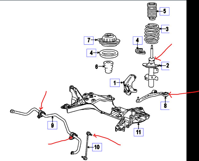

Bumping noise on passenger side front wheel when driving on any uneven road?
Jun 25, 2023 at 10:37 AM
  • 55,691 POSTS

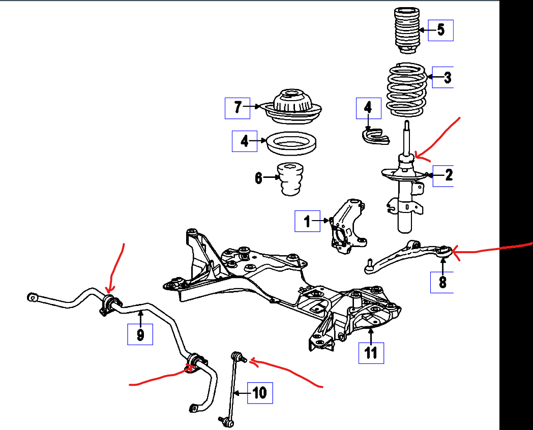

This is common when the strut or sway bar link or frame mount goes out, I would lift the front of the car and use a flashing and a large pry bar to check the suspension components, here is a guide that will help with images below to aid you as well:
