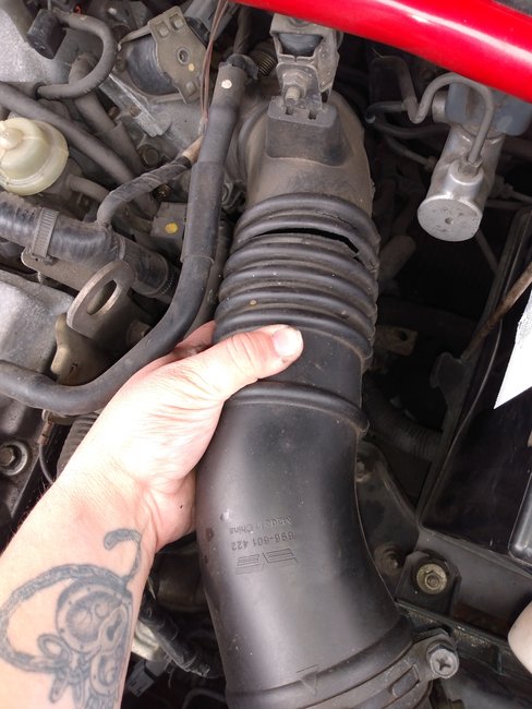

I saw this was broken. Will this affect anything? Someone told me i need a new starter. Could that be true? He plugged a reader to it and said there's no codes coming up.

That is the air intake tube that runs between the air filter box and the throttle body. It will certainly help it run better, but there is a good chance it has nothing to do with a no start. It will need replaced simply because it is allowing unmetered air to enter the engine. This will cause a lean fuel mixture and a check engine light to turn on.
As far as the starter is concerned, you mentioned that it is cranking but not starting. To me, that indicates the starter is working, so I don't feel that will change things. It sounded normal in your video.
