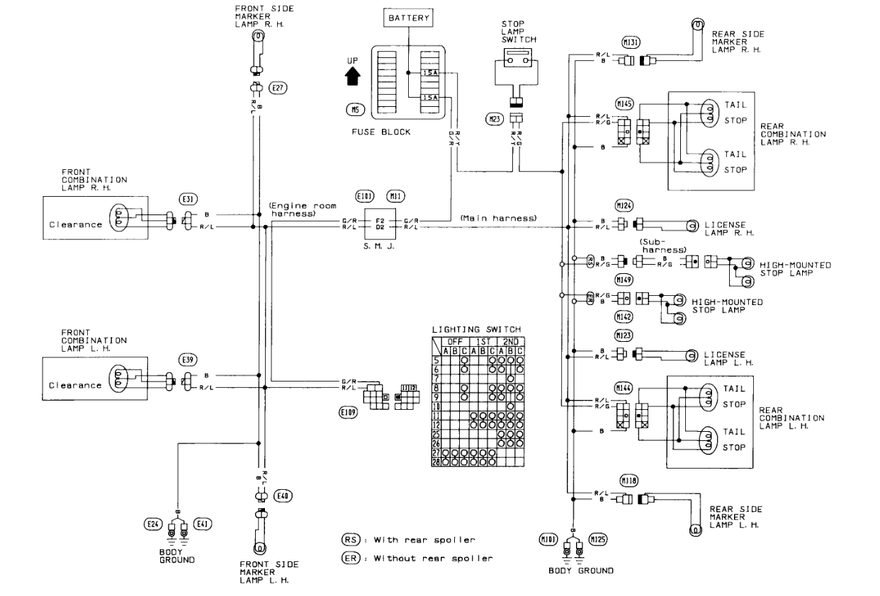

What color wire is for the brake pedal and it's location?

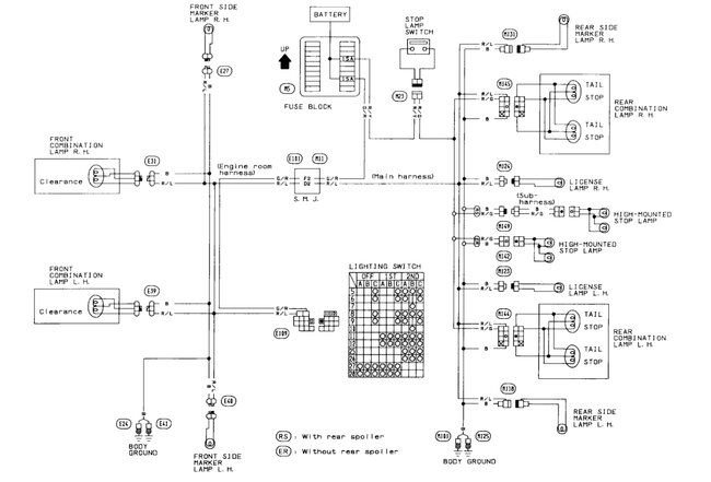

Sure, the wire colors for the brake light switch is red/tan and red/green. Here is the wiring diagrams for the brake lights so you can see how they work. Check out the images (below). Please let us know what happens.
