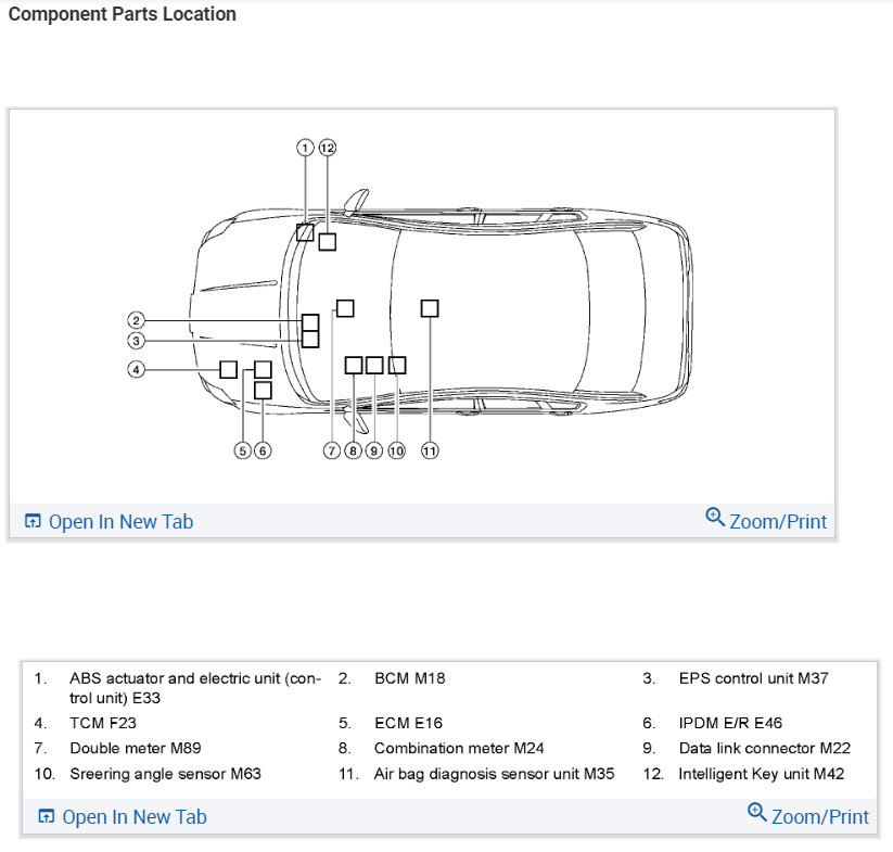

Could it be electrical? because a mechanic tell me to change the brain box.
Mar 13, 2019 at 12:48 AM
  • 55,616 POSTS
That would do it. here is the location of the ECM you will need to have it programmed to the car should cost about $130.00. Check out the diagrams (below). Please let us know what happens.
