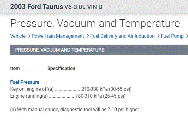

You may want to consider checking the fuel pressure to make sure it is within the manufacturer's specifications. You will need a fuel pressure gauge, but most parts stores will lend one to you.
Here is a link that explains how in general it is done:
I attached the manufacturer's specs below for fuel pressure.
Let me know as much as you can or if you have other questions.
Take care.
See pic below.
