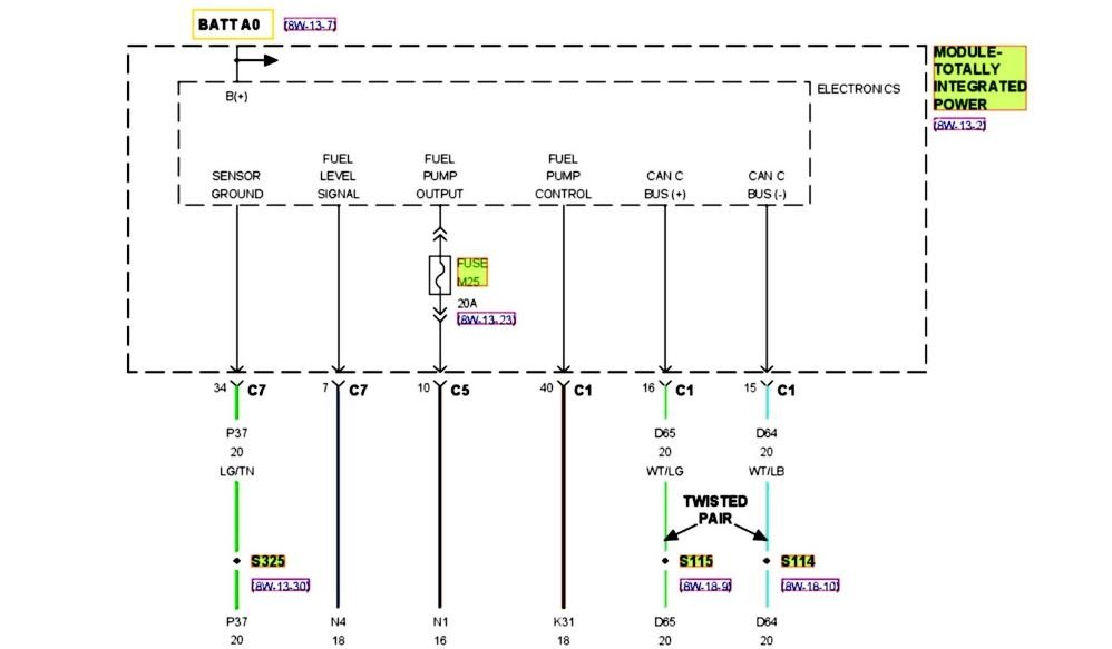

I replaced fuel pump and a couple of relays. We have spark and air. It will run for a few seconds on starting fluid. I can't think of any thing else. Please help!

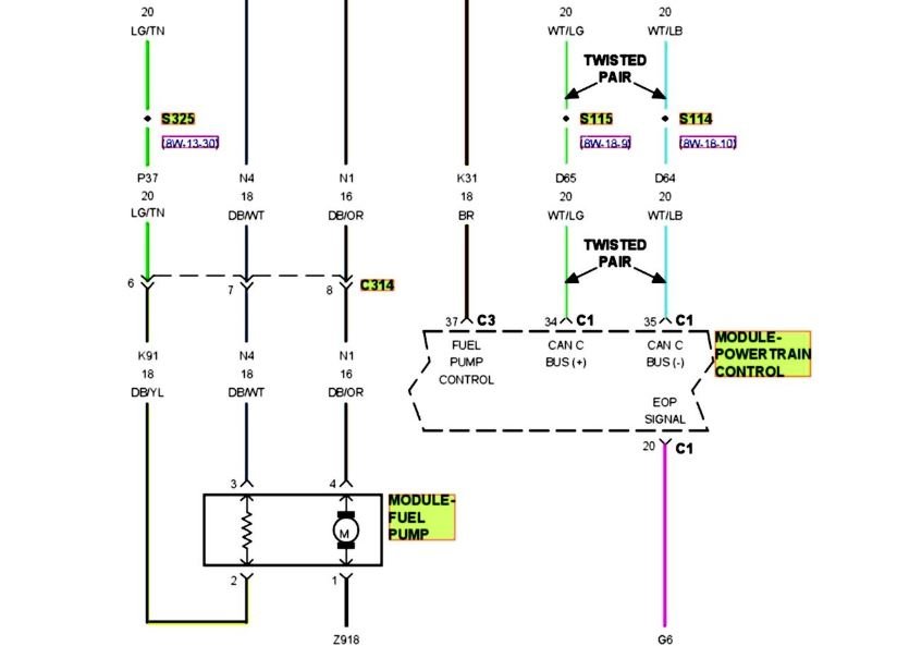

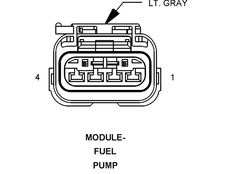

Well I have no power to the fuel pump. And all the wires look fine. Any ideas ?
Jan 6, 2019 at 1:06 PM
The TIPM or the fuse box controls the fuel pump. check the fuse listed in the diagram for power on both sides when cranking.
