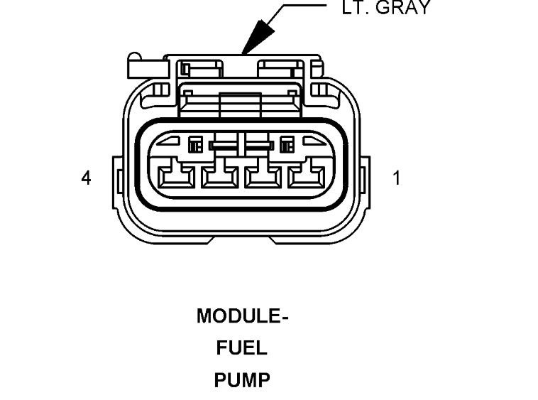

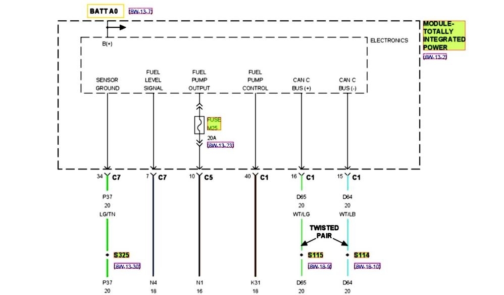

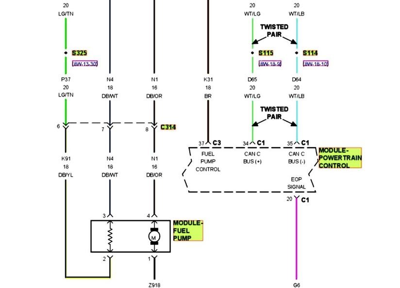

Well I have no power to the fuel pump. And all the wires look fine. Any ideas ?
Jan 6, 2019 at 5:06 AM
The TIPM or the fuse box controls the fuel pump. check the fuse listed in the diagram for power on both sides when cranking.
