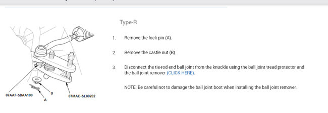

What can be the cost and the exact problem? My car hit the curb by the right tire and its right tire tilted rightward like i have turned the steering a little bit right, but the left tire is straight when the steering is completely straight.
Dec 18, 2022 at 9:51 PM
  • 55,865 POSTS

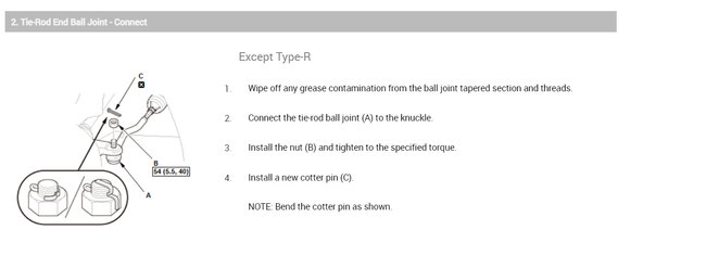

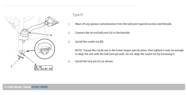

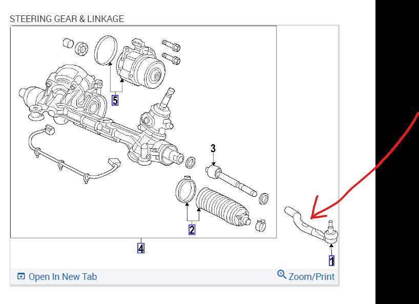

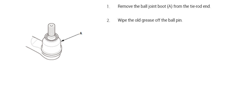

It sounds like you bent the tie rod end which is common when this kind of damage happens. We would need you to upload images to be sure once the car is raised up.

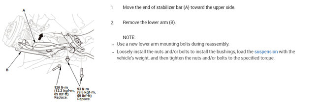

It could be the lower control arm that is bent as well. Check out the images below so we can start fixing the problem. Let us know what happens and please upload pictures or videos of the problem.
