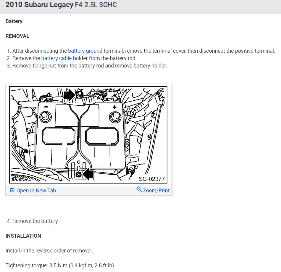

Please someone help me and explain what can cause this? The car is staying outside in a parking. Every time it started for the first ignition turn. it is -9C outside but it started in colder conditions as well.

Thanks for the video, it helps a lot. It looks like the battery needs to be replaced. here are two guides to help confirm the failure and walk you through the battery replacement:
and
https://www.2carpros.com/articles/how-to-replace-a-car-battery
Check out the diagrams (below). Please let us know what you find.
