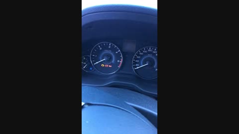

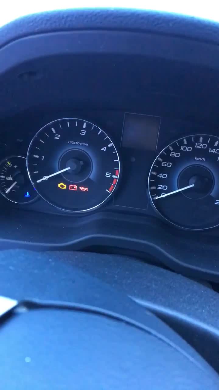

Water temperature light flashing red and blue., car will not crank over
2010 SUBARU LEGACY
159,000 MILES • 2.0L • 4WD • MANUAL
NORBERT87
Please someone help me and explain what can cause this? The car is staying outside in a parking. Every time it started for the first ignition turn. it is -9C outside but it started in colder conditions as well.

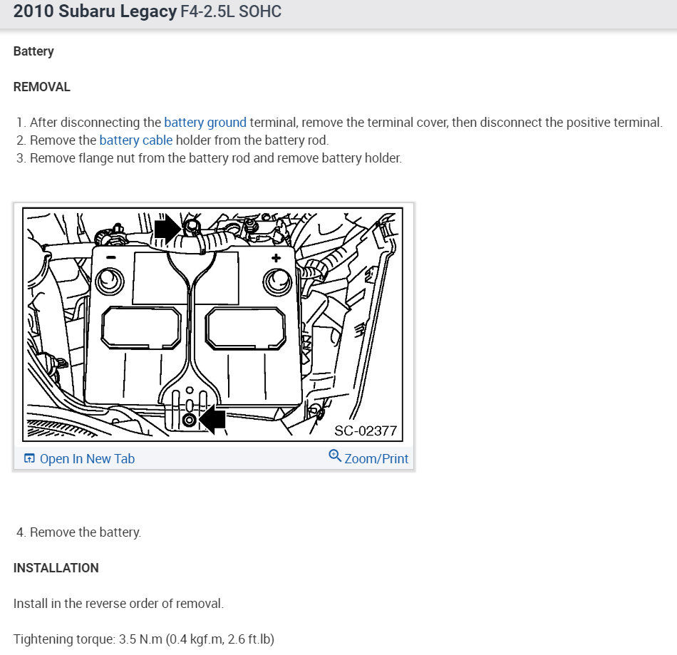

Thanks for the video, it helps a lot. It looks like the battery needs to be replaced. here are two guides to help confirm the failure and walk you through the battery replacement:
and
https://www.2carpros.com/articles/how-to-replace-a-car-battery
Check out the diagrams (below). Please let us know what you find.

If your battery is okay a controller is going out. Let's do a CAN scan to see what's going on. You can get a CAN scanner (Controller Area Network) from Amazon.
https://youtu.be/u-4syLc-ifQ
and
Please go over these guides and report back.
