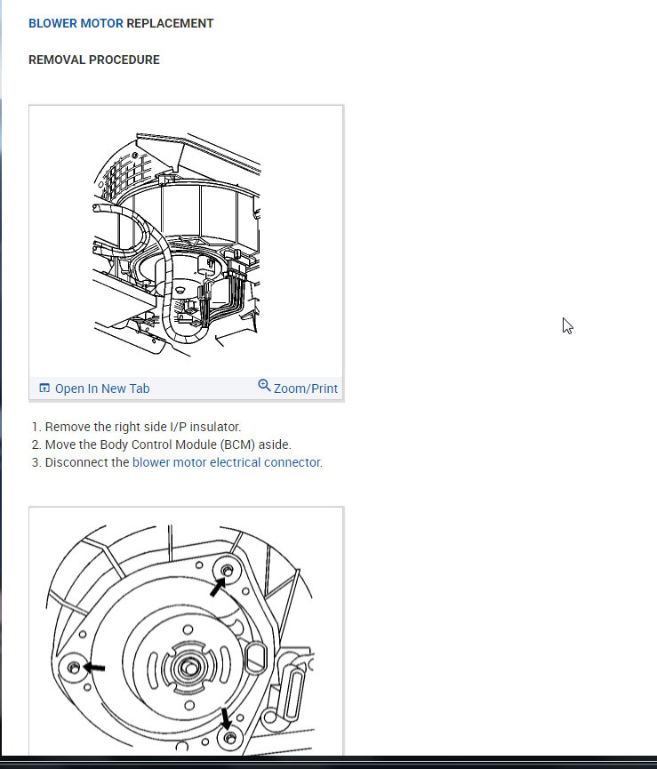

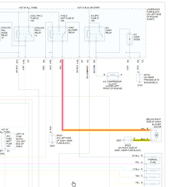

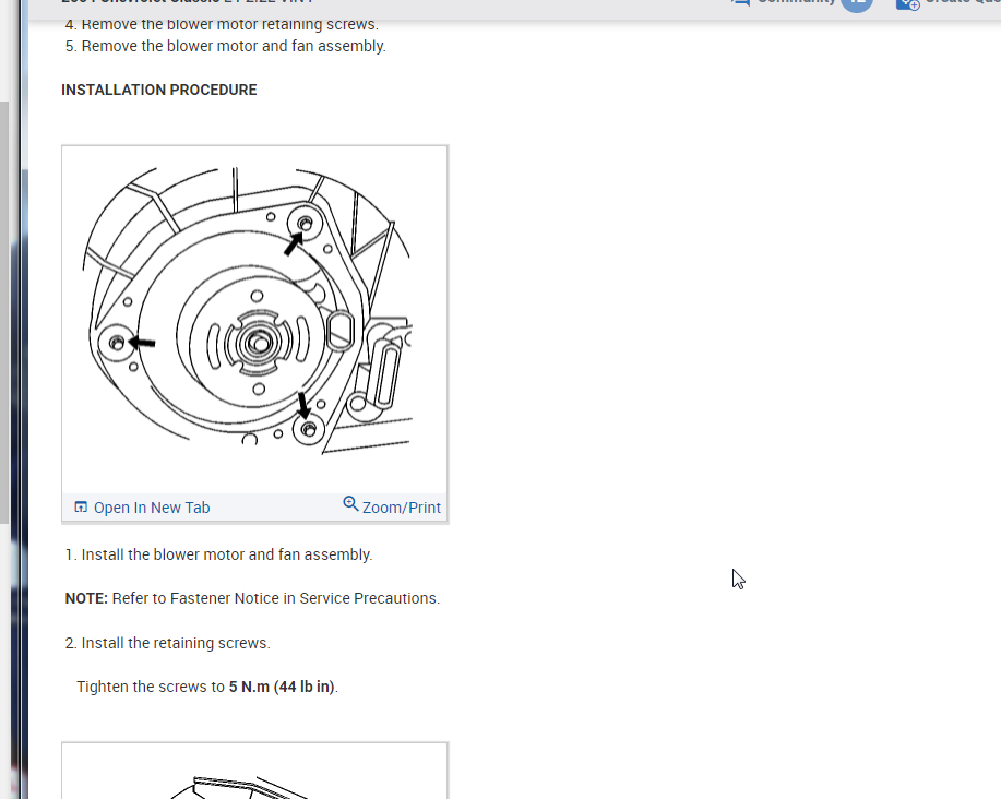

Some blower motors say only when replacing a two terminal motor. I have no idea how to check if I do or don't and i don't know what it means. Some don't show that but I thought someone can help so I know which to buy.
May 30, 2021 at 11:11 AM
Normally all blower motors are two wire so you would be safe with going with this if it says it fits your vehicle.
Here is a guide that will help with replacing these in case this helps:
https://youtu.be/1eau7hCuuJ8

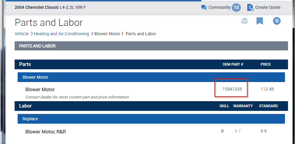

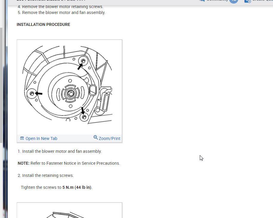

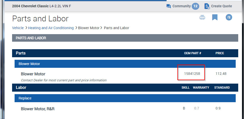

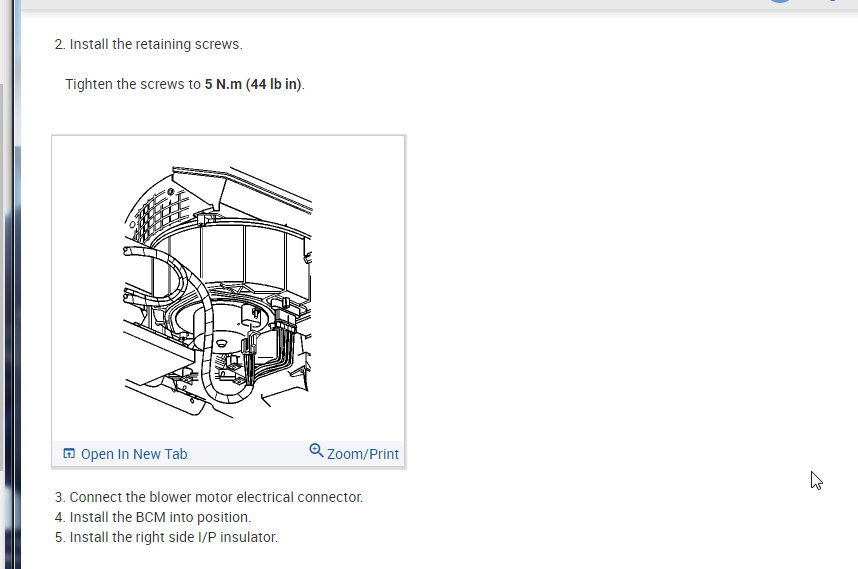

However, below is the process to replace the motor from the manual and I included the OEM part number of the blower motor which will give you either the OEM part or an equivalent.
Please run through this info and let us know if you have other questions. Thanks
May 30, 2021 at 11:41 AM
TAMIA BRAY
Thank you so much I was so lost. I believe my blower motor is located underneath the front passenger side but seems to be the same method. Thank you I will let yall know if I have any more questions later. I'm replacing the blower motor and blower resistor.
May 30, 2021 at 12:06 PM
That is correct. It is behind the dash on the passenger side. Please let us know how it turns out or if you need other info. Thanks
