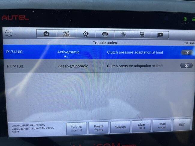

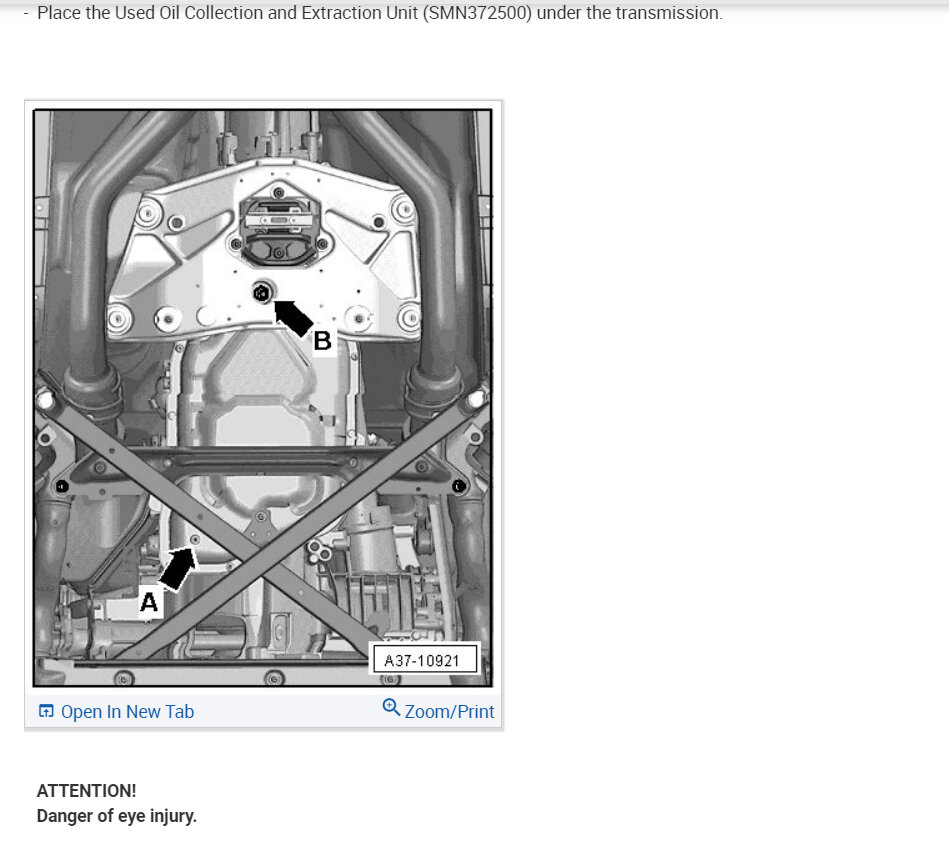

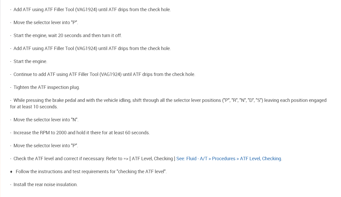

CVT, drives excellent, but i see these codes P1741?
Oct 18, 2022 at 7:18 AM
  • 55,433 POSTS

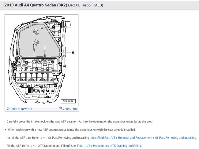

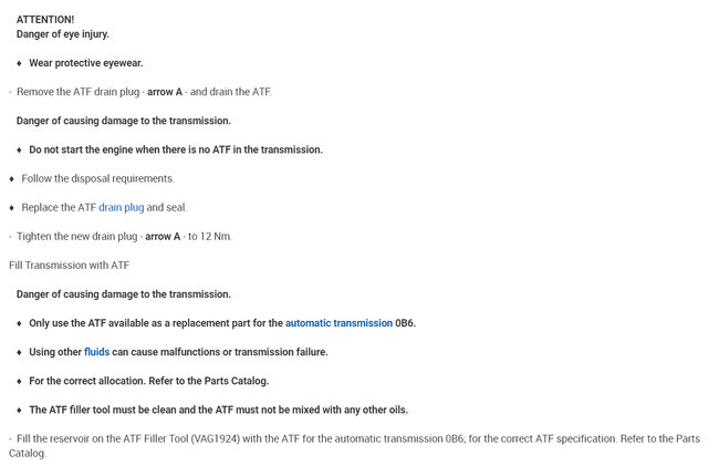

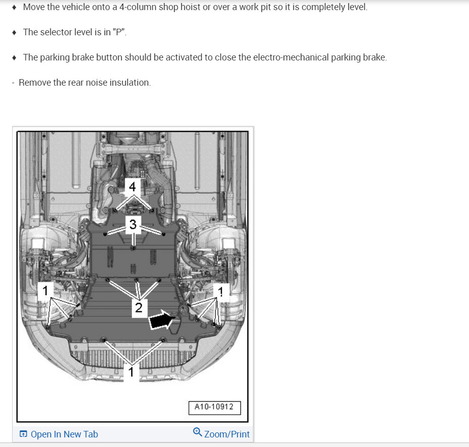

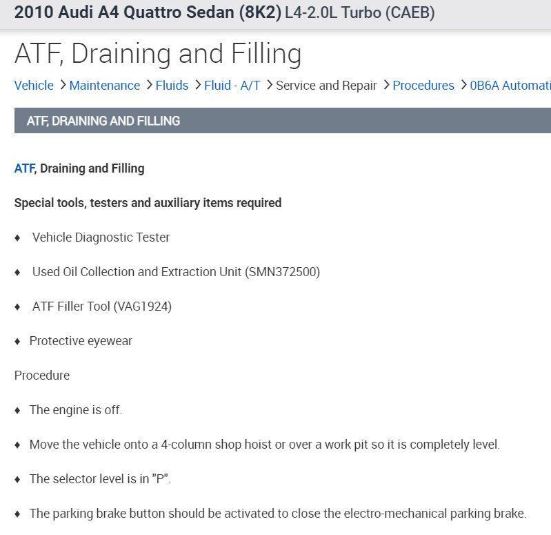

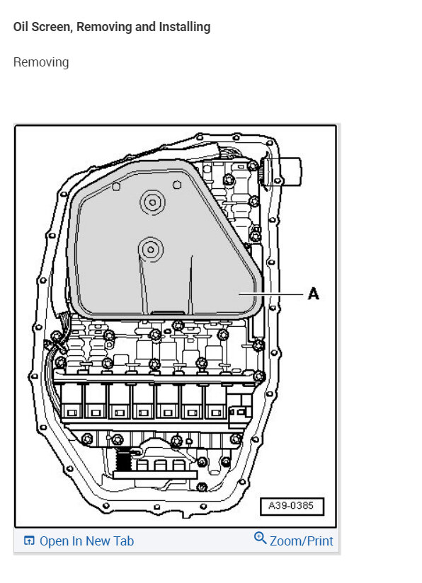

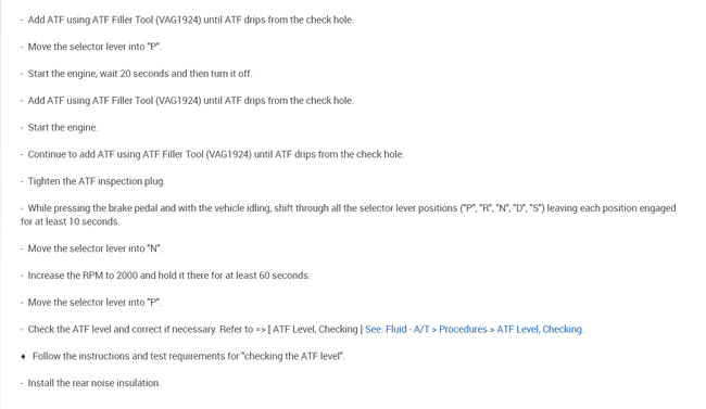

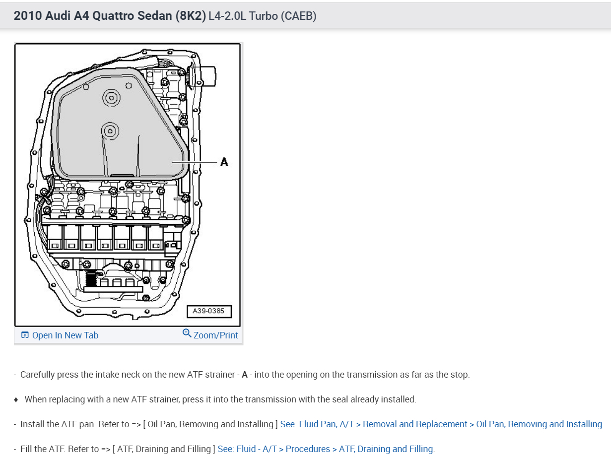

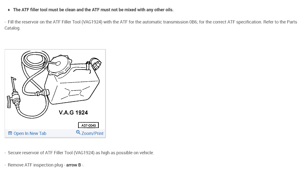

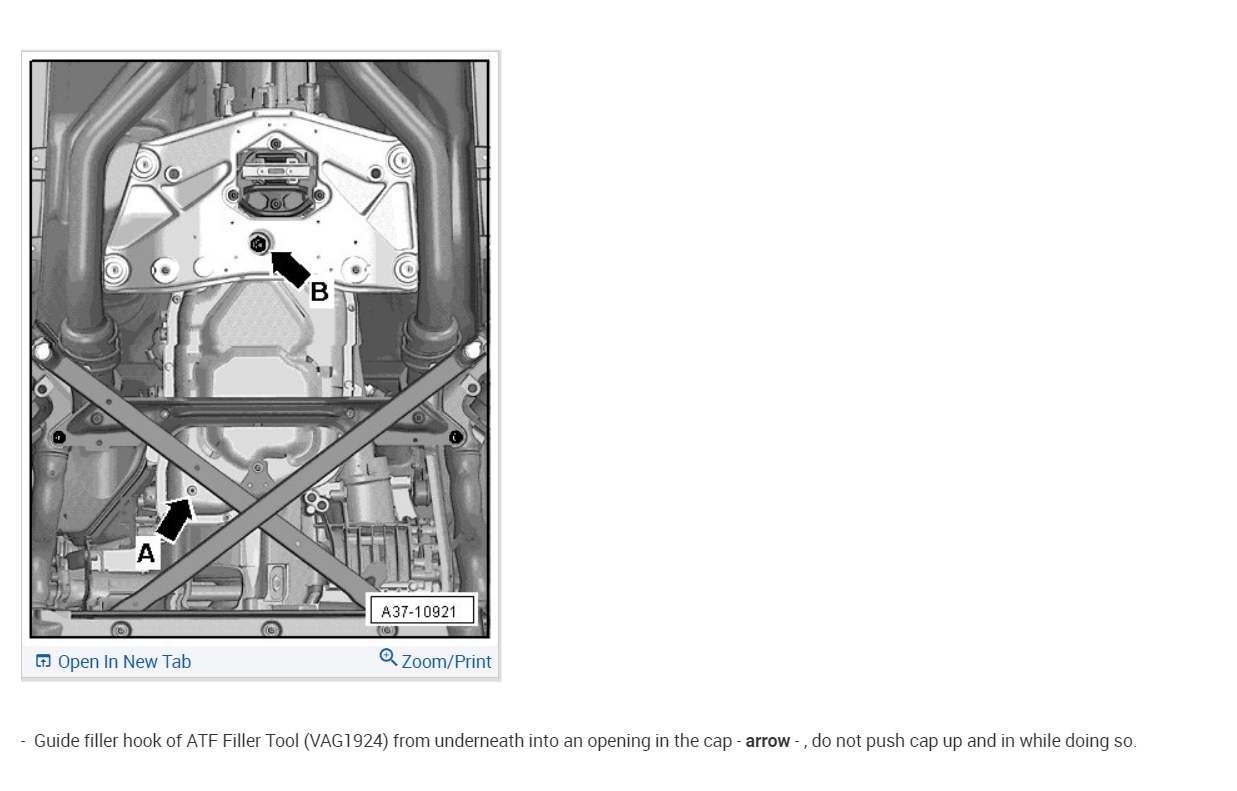

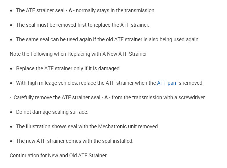

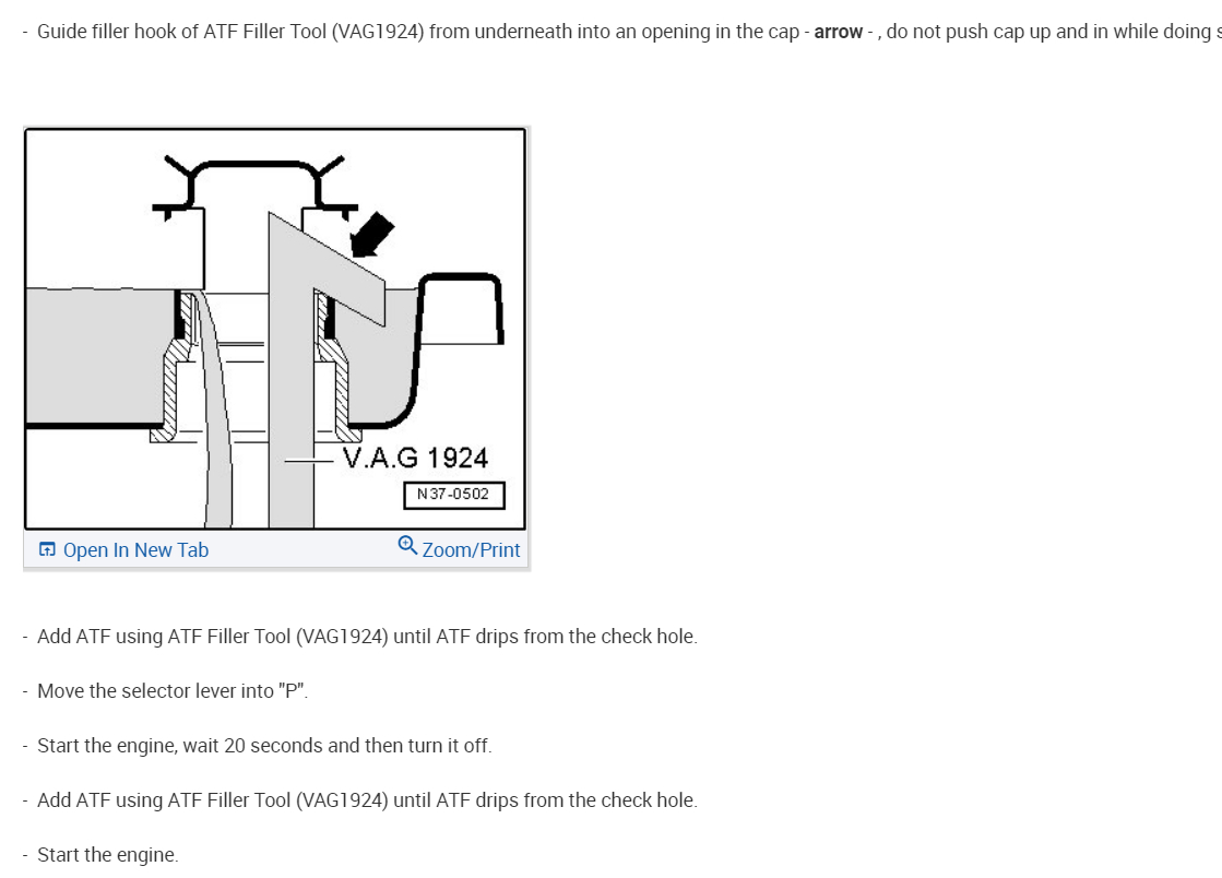

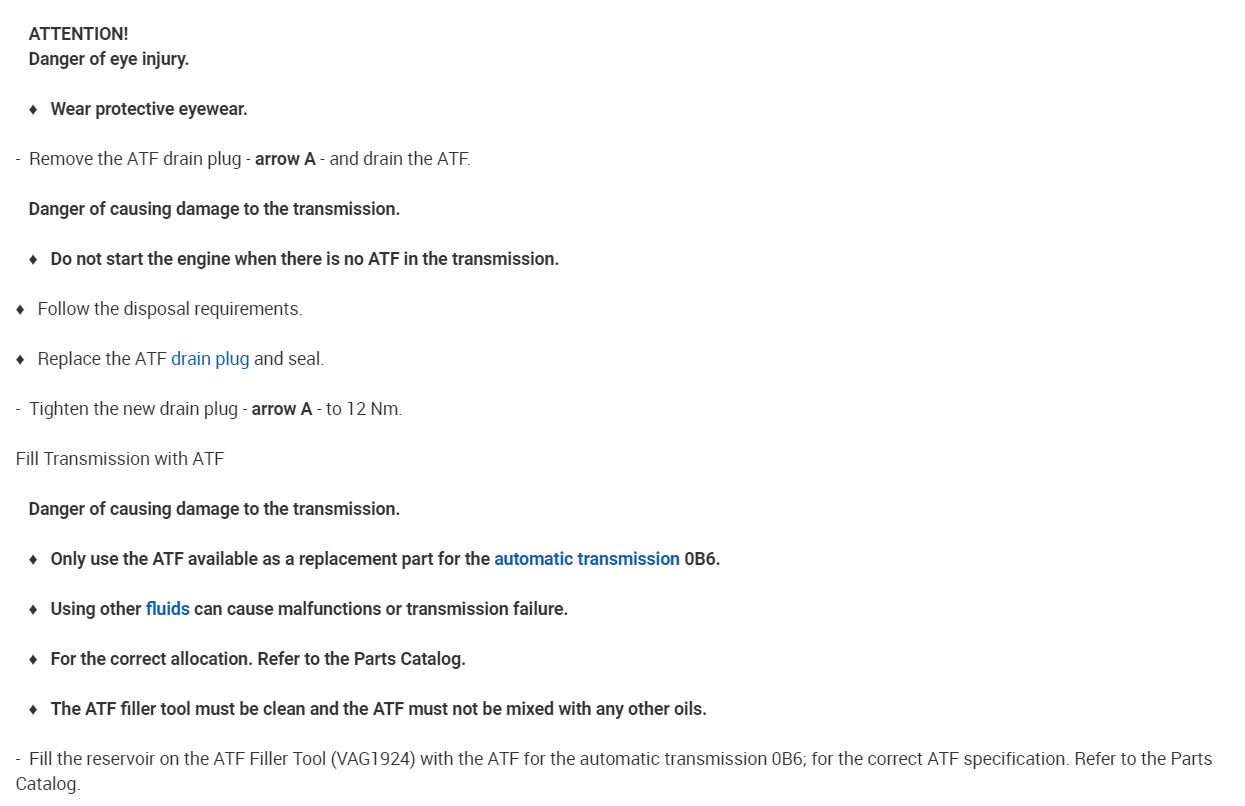

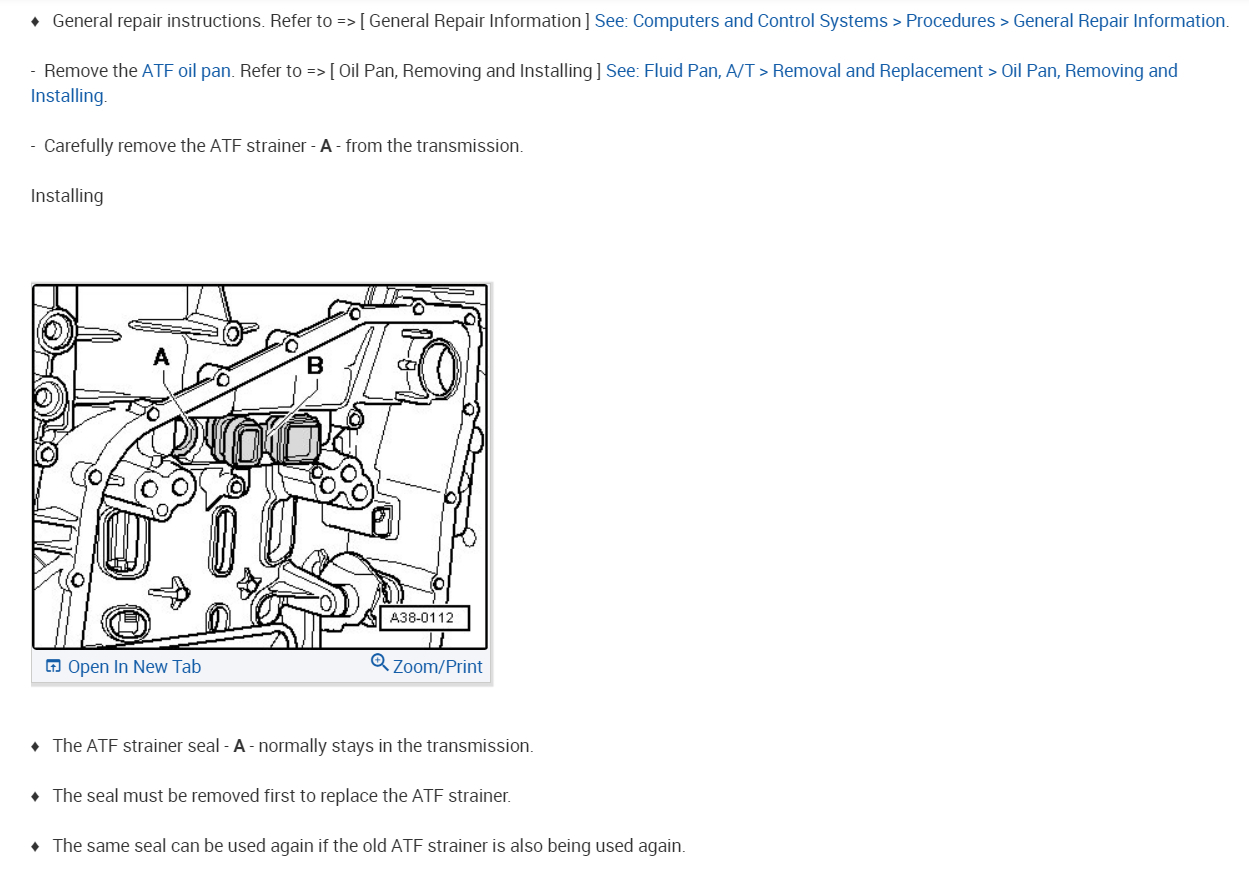

The P1741 code is for low level or dirty transmission fluid or a faulty torque converter clutch solenoid. So, I would check the fluid level and condition. Here is how in the images below. I would try this first it usually fixed the problem. Check out the images (below). Let us know what happens and please upload pictures or videos of the problem.
Oct 18, 2022 at 11:34 AM
BHAMDOC1973
  • 2,007 POSTS
Thanks, but the transmission has no pan on these cars.
Oct 18, 2022 at 11:38 AM
  • 55,433 POSTS
Yep, sorry about that we have no information on this car.
