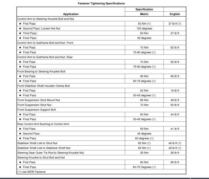

What are the torque specs for the inner and outer tie rods
2013 BUICK VERANO
90,000 MILES • 4 CYL • 2WD • AUTOMATIC
DOSEYDOGGY
I cannot find anything that shows what are the inner and outer tie rod specs for car. Please help!
Oct 7, 2018 at 2:01 AM
Good afternoon.
I attached a list of torque specs for you for the front suspension. Check out the diagrams (Below). Please let us know if you need anything else to get the problem fixed.
