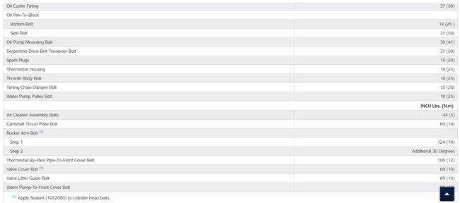

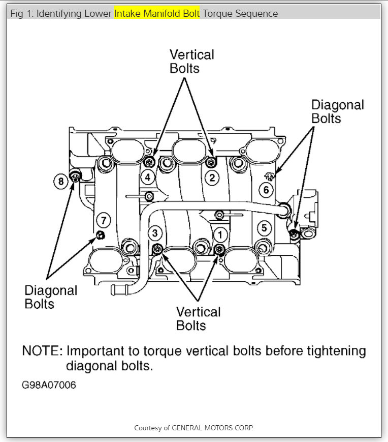

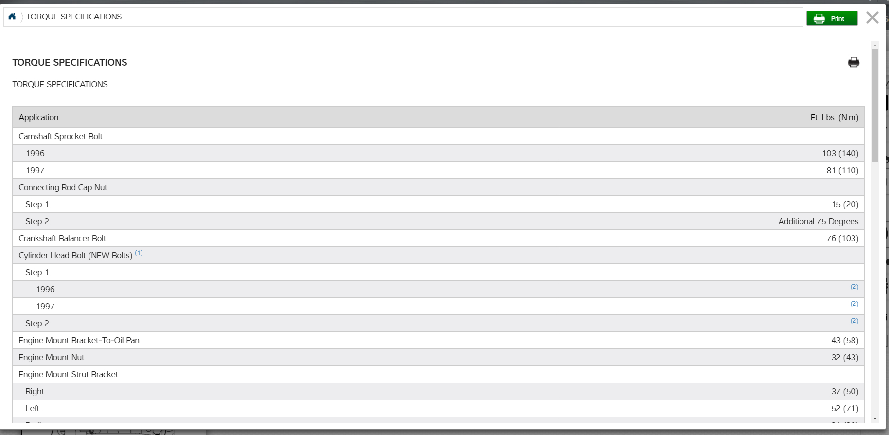

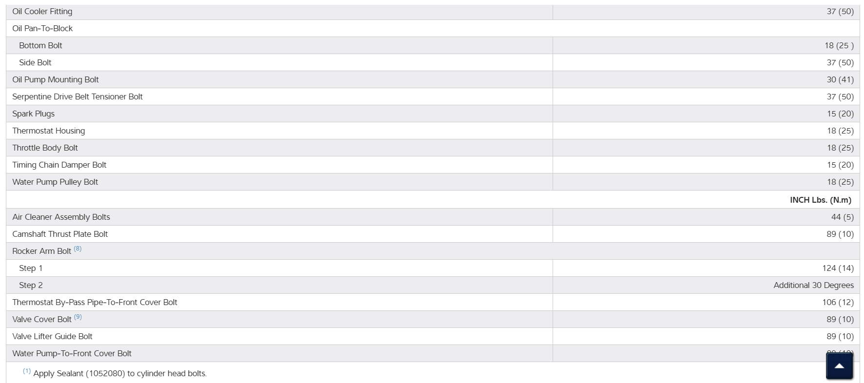

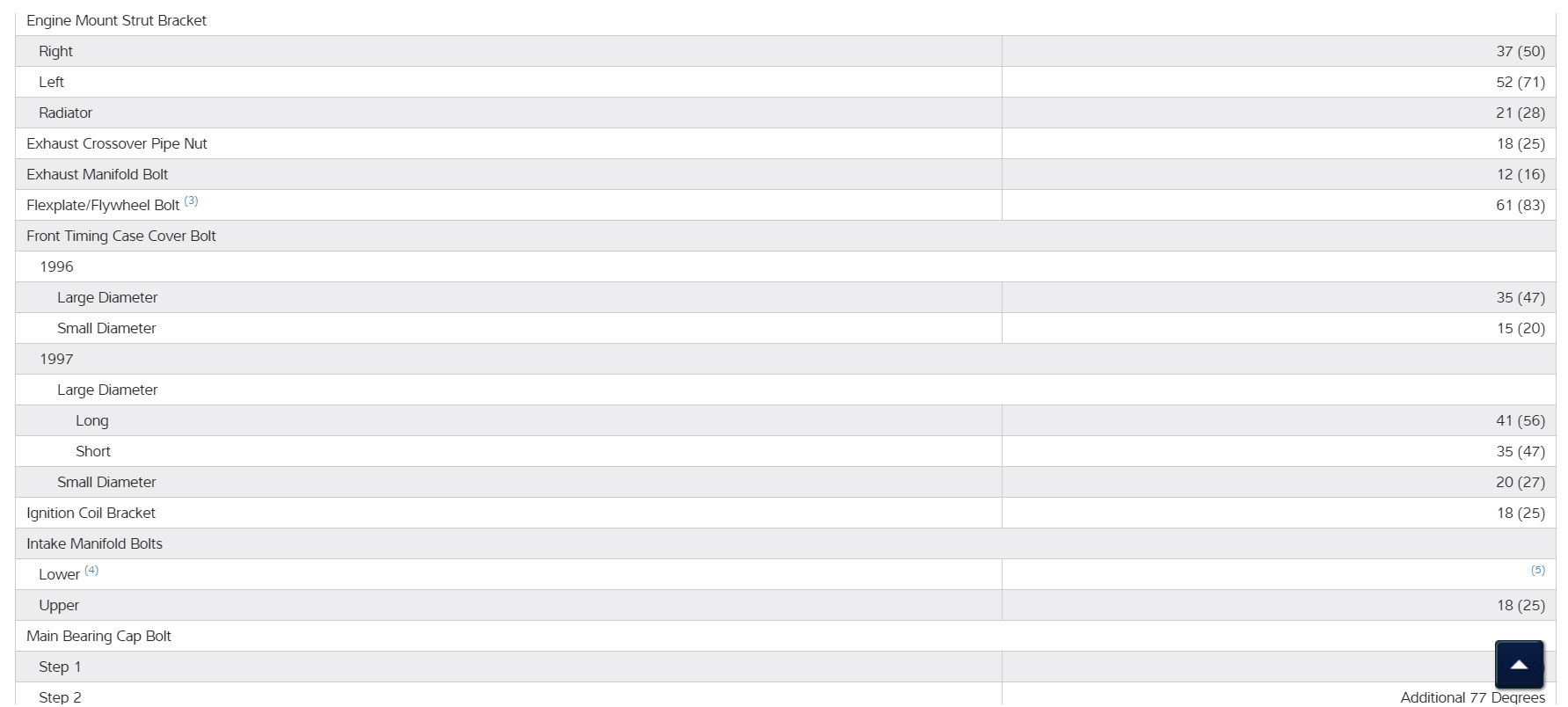

Yep that is a big job glad you are doing it though. Here is a guide that can help others see what its like doing an intake manifold.
https://www.2carpros.com/articles/replace-intake-manifold-gasket
Here is a video on how to use a torque wrench.
https://youtu.be/juOClONIWeY
Here are the bolt sequence and torque specs (below)
