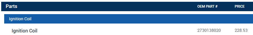

just asking what's the OEM plugs wires and coil packs for my car?

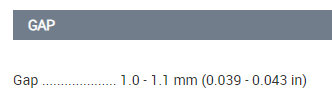

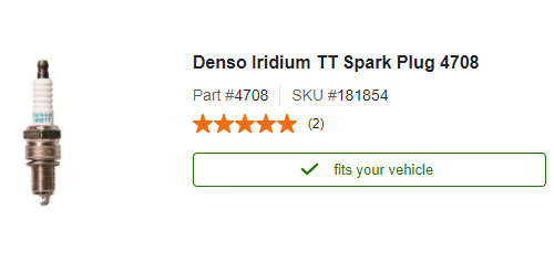

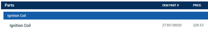

Here is the information you requested. Your vehicle does not have spark plug wires. Your car is coil on plug style eliminating the spark plug wires. Here is a tutorial showing how to replace spark plugs:
https://www.2carpros.com/articles/how-to-change-spark-plugs
I've attached pictures below showing the Hyundai ignition coil part number and the recommended Hyundai spark plug including the gap and torque. Hope this helps and thanks for using 2CarPros.
