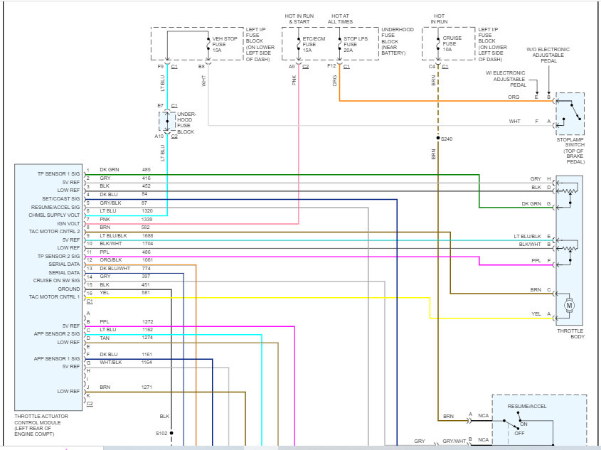

What and where are the four fuses that are located for the cruise control?
Oct 10, 2022 at 8:07 AM
  • 110,244 POSTS

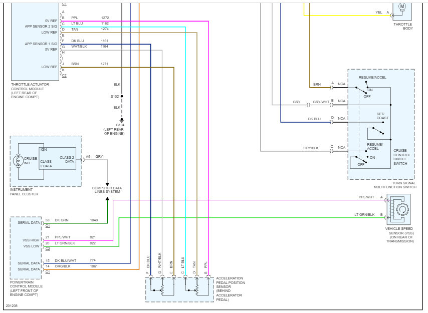

I attached the entire wiring schematic for the cruise control below. There are four fuses identified at the top of the first pic. However, there is only one identified as cruise control. The others are part of the circuit, so yes, they need to be checked.
When you check them, in addition to checking the fuse, make sure there is power to and from them.
Let me know if this helps.
See pics below. Note: The schematic was cut in half to make it readable for you. I did overlap them so you can follow from one to the next.
