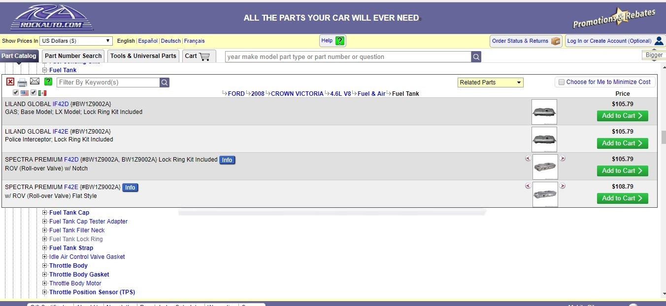

I have a 2008 Ford Crown Victoria Police Interceptor with flex fuel. Romeo. I just had my tank drop due to the tank straps breaking from rust and now the tank leaks. I am having trouble figuring out what aftermarket fuel tank will fit my model. From what I can see a spectra premium f42e will fit, but the whole roll over valve-flat style and roll over valve- push in style are confusing me. There was one that said it was notched also. While the Police Interceptor flex fuel variation says it fits my vehicle but does not specify ROV or a notch. Does my vehicle require a Police Interceptor with push in style ROV or no? I just do not want to order the wrong tank because I am swapping everything from old tank onto new tank and they must fit together. I am also getting a lock ring pump seal, straps and hardware and fuel filter. Just FYI. Please help me decide what cheaper aftermarket tank to get. Please oh please!

I would use the ROV style.
I found it at Rockauto for just a little over $100.00. You do not need the notch. I used to work on the police cars and this is a direct fit.

Just to be clear, you recommend the spectra ROV flat style (f42e) and not the Liland Global Police Interceptor (IF42e), correct?
Sep 2, 2018 at 11:10 AM
Correct.
