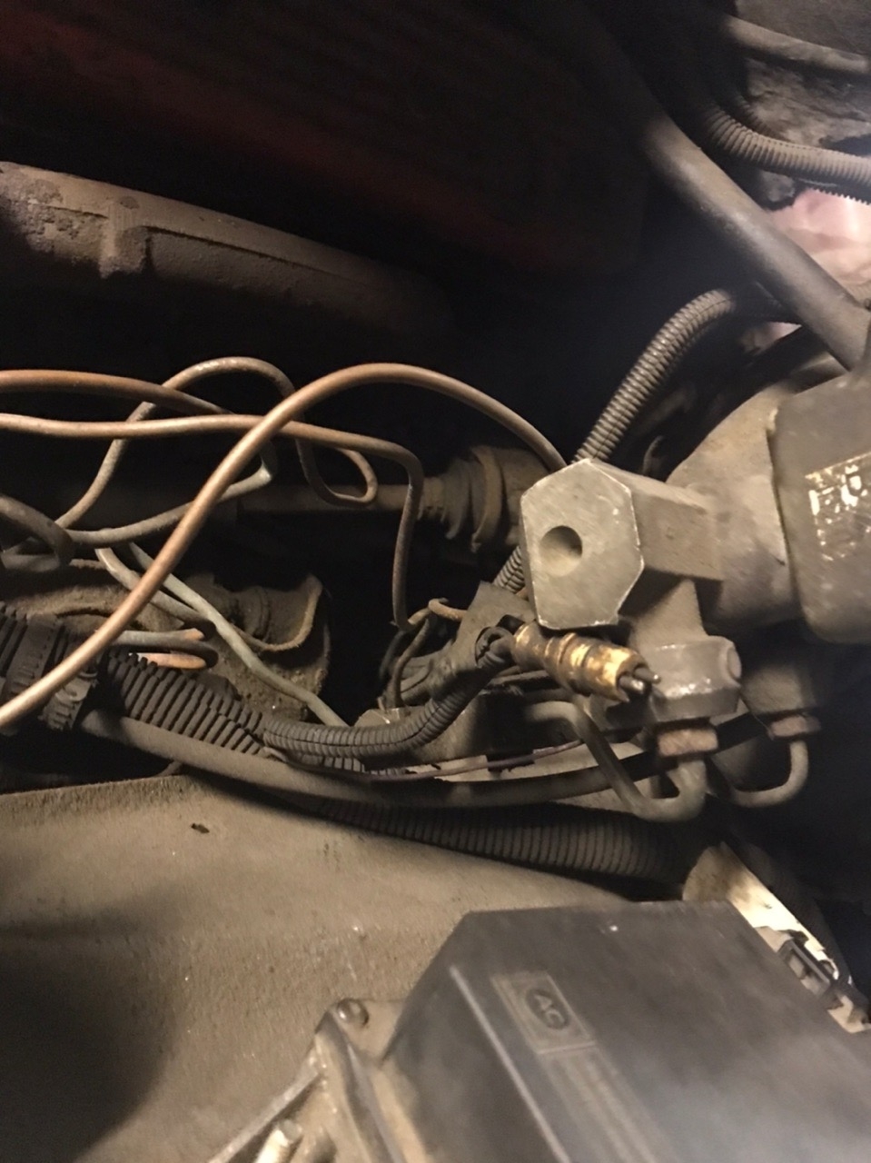

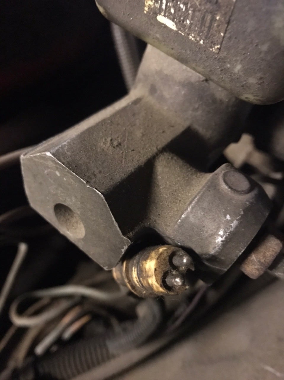

today saw the thing next to the brake master cylinder.
Oct 2, 2019 at 10:52 AM
Good afternoon,
Is it attached to anything? Looks like it is just laying there.

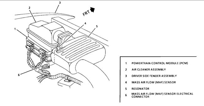

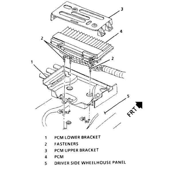

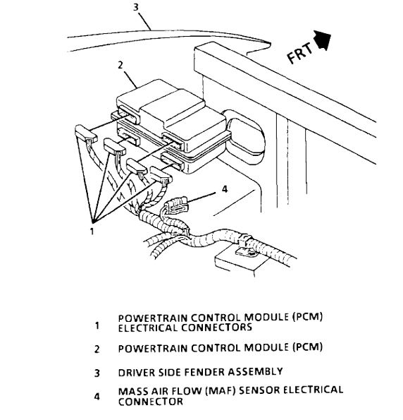

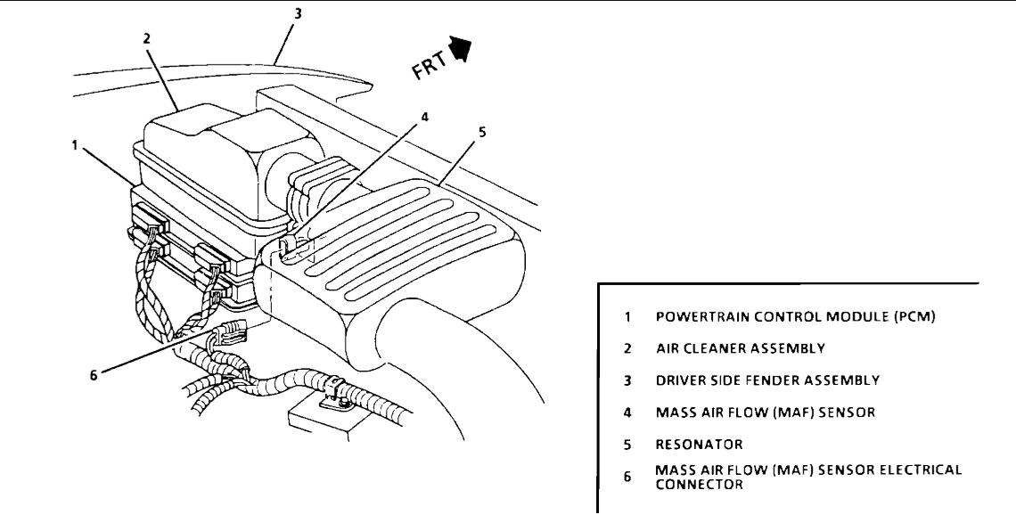

Check is on.
Oct 3, 2019 at 1:02 AM
Please explain? Do not understand.
Oct 3, 2019 at 2:03 AM
ANONYMOUS
  • 0 POST
The check burns, self-diagnosis does not work. that is, if you close A and B then the check will not burn at all and the cooler will spin and nothing else happens.
Oct 3, 2019 at 2:09 AM
Do you mean the engine will not start?
Do you mean the ECM will not respond to show codes?
Oct 3, 2019 at 2:11 AM
ANONYMOUS
  • 0 POST
Yeah, I mean, the self-diagnosis doesn't work.
Oct 3, 2019 at 3:17 AM
Okay, sorry.
If you jump the 2 pins and it will not flash codes at the check engine light, that indicates a bad ECM. You will need to replace it.
