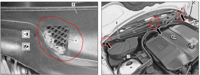

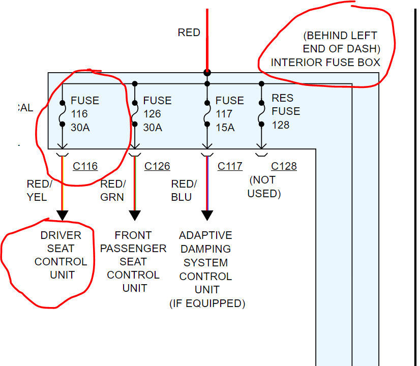

I bought a car from the auction that has this wet floor/moisture on the inside of the windshield whenever it rains. Is that usually clogged up drains? Can you tell me where the drains are on this car. Also, the power seat does not work, where is the fuse for it? The wet floor is only on the driver side on the bottom left...I also hear whooshing water sound when driving.
Dec 14, 2019 at 7:59 AM
  • 110,248 POSTS
I attached a picture below. On the left part of the picture (pic 1), you will see the deflector, and on the right, it shows the drain locations.

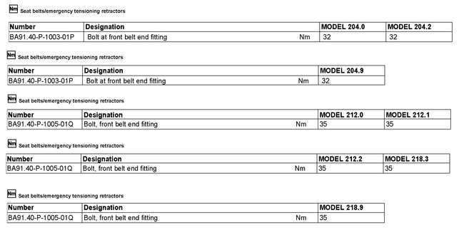

As far as the fuse, it is in the vehicle fuse box. See pic 2

There is no fuse box behind the left end of the dash, i know many Benz have it but weird that this doesn't.
Dec 20, 2019 at 10:03 AM
NASER NASER
  • 836 POSTS
Since she doesn't have memory seats the driver side power seat fuse is in the trunk number 45 was blown, 30a, replaced it blew again, am pretty sure this has to do with the water that was leaking in in the floor, where should I start looking? I looked under driver seat and its dry, connections look good with no corrosion or moist.
Dec 20, 2019 at 10:31 AM
NASER NASER
  • 836 POSTS
As soon as i connect the wire for the motor that is located on the back bottom of the seat the fuse blows, the wire when disconnected has juice to both wires.
Dec 20, 2019 at 11:02 AM
  • 110,248 POSTS
It sounds like the motor is bad. If you have power and what you described happens, something has to be shorted out in the motor. However, I have seen the pins in the connector bend and short. By chance, did you check those?

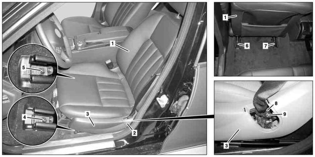

Its very tight space and no way to remove the motor or seat i doubt, what can be done in such case?
Dec 20, 2019 at 12:26 PM

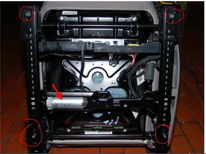

  • 110,248 POSTS
The seat itself is bolted with 4 bolts. Take a look at the attached pic for their locations.
Dec 21, 2019 at 11:07 AM
NASER NASER
  • 836 POSTS
Ya i know but the motor is bad and i cannot move the seat to expose all the bolts, i did remove many seats in the past am familiar

I can only see the back bolts of the seats and can remove them.
Dec 22, 2019 at 1:22 AM
  • 110,248 POSTS

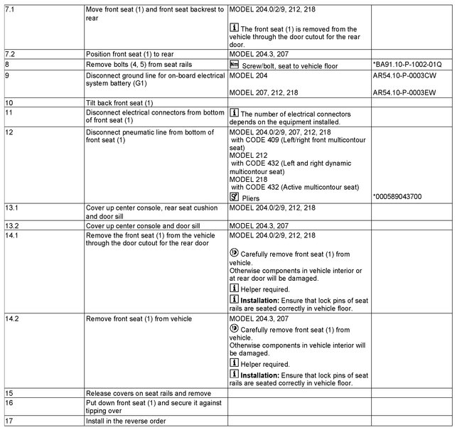

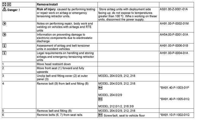

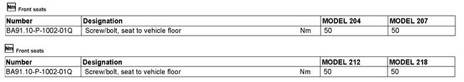

Take a look through this and see if anything helps. Note: The actual directions are in the pics below.
_________________________________
2008 Mercedes Benz C 350 (204.056) V6-3.5L (272.961)
AR91.10-P-1000CW Remove/Install Front Seat
Vehicle Body and Frame Seats Service and Repair Removal and Replacement AR91.10-P-1000CW Remove/Install Front Seat
AR91.10-P-1000CW REMOVE/INSTALL FRONT SEAT
MODEL 204, 207, 212, 218
pic 1
Shown on model 204.0, left front seat (1)
1 Front seat
2 Belt end fitting cover (model 204.0/2/9, 212, 218)
3 Outer cover
4 Screw
5 Screw
6 Screw
7 Screw
8 Belt end fitting (model 204.0/2/9, 212, 218)
9 Screw/bolt (model 204.0/2/9, 212, 218)
pic 2
pic 3
pic 4
pic 5
000 589 04 37 00, Pliers
pic 6
______________________________________
Let me know if any of that helps.

yes sir am. aware of all of that I removed benz seats before, my problem is that since the seat doesn't move It won't let me see the front bolts, I have to move the seat back but am not able to.
Dec 22, 2019 at 11:01 AM
  • 110,248 POSTS
If you remove the rear bolts, can you slightly move the seat enough to access the motor?
Dec 23, 2019 at 1:29 PM
NASER NASER
  • 836 POSTS
All good, the bottom of the cushion has 2 bolts that once removed you can see everything, the motor was hanging with 1 grommet, i moved it and it worked, maybe it was touching the frame, ordered another motor as those grommets aren't sold separately.
