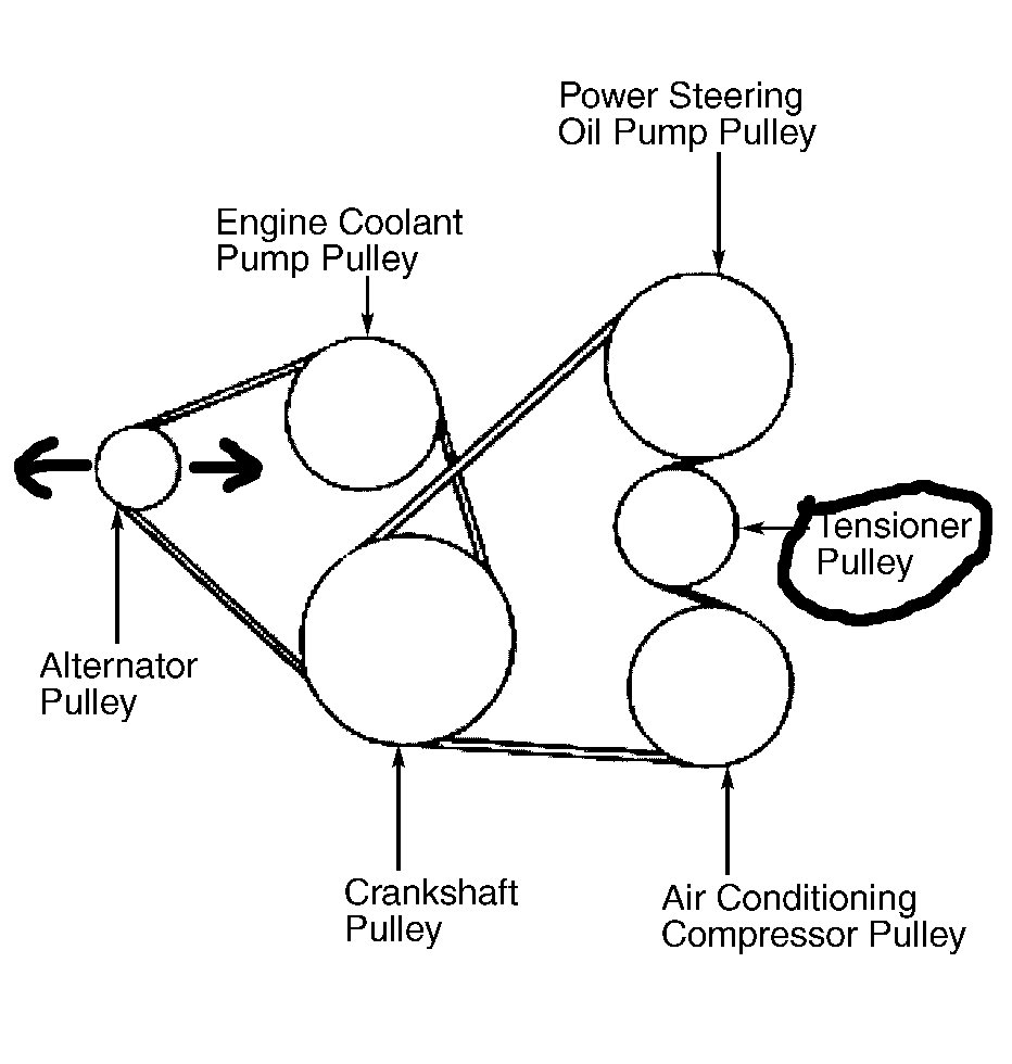

I am just trying to replace water pump and cannot seem to find the tension belt release.

There is a tensioner between the AC/power steering pulleys for that belt. For the water pump the alternator is the adjuster.
Image (Click to enlarge)
