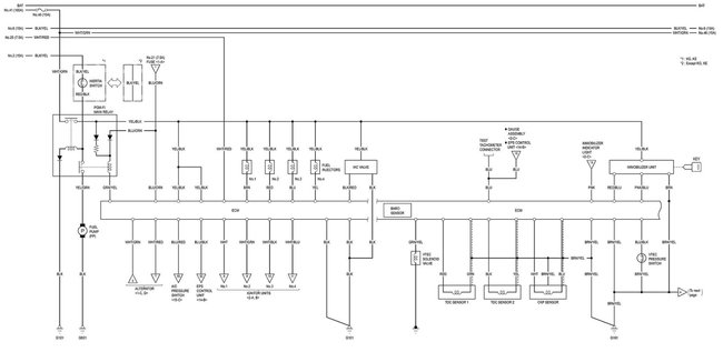

Crashed, engine will not start. Fuel pump is not making any sound. If it does not have switch then were should i start?

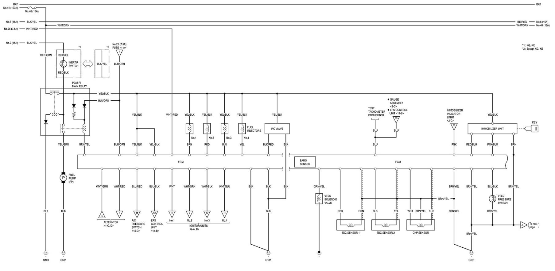

Looking at the wiring it shows an inertia switch for the fuel pump. The actual location is sort of vague but it looks like it is behind the center of the dash.

Was it the switch or?
Dec 19, 2018 at 9:09 AM
LOWRY
Open glove box or just take it away. And behind console there is bigger black button. Clicks in and pump works.
