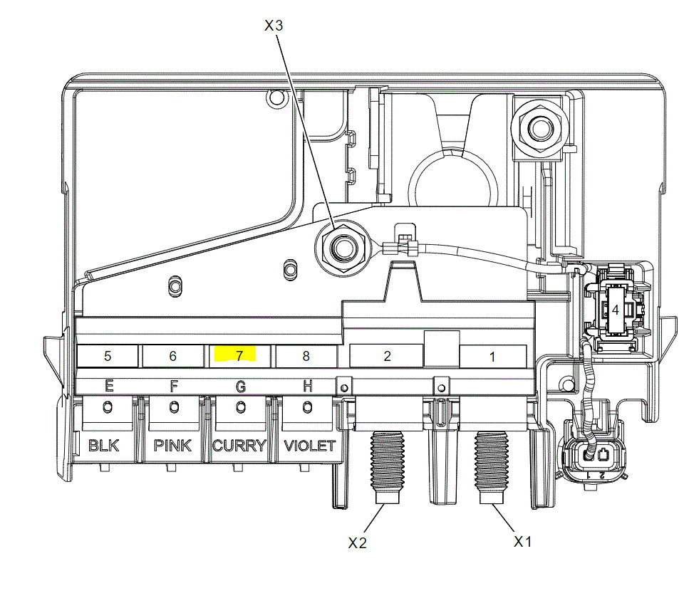

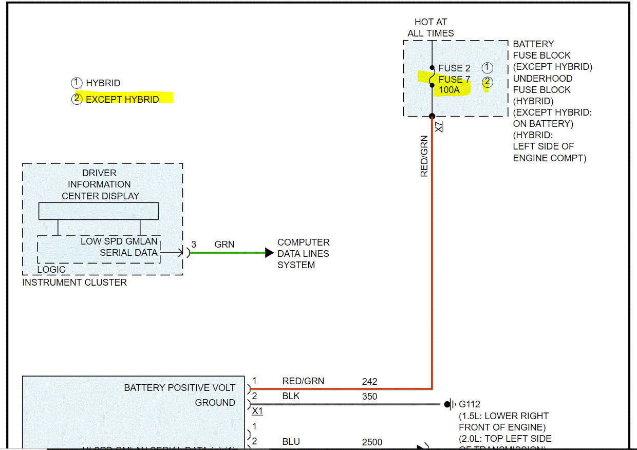

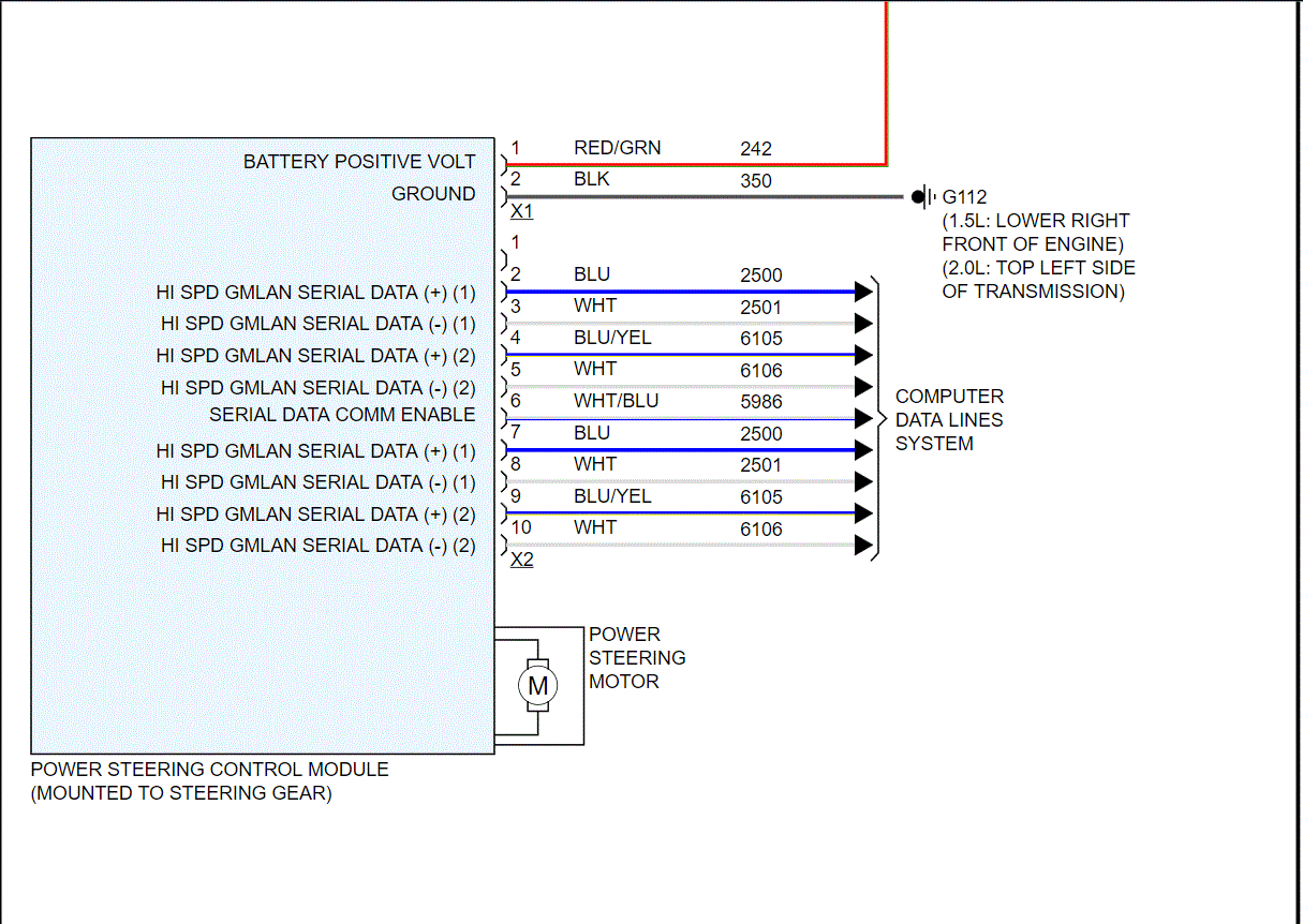

See pics below. Pic 3 shows fuse location in the battery junction box.
