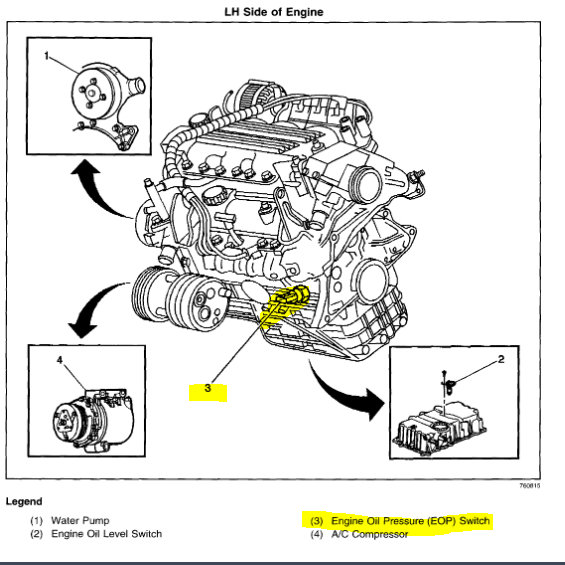

The idea that you have an oil leak, and the pressure code is present leads me to think the sensor is bad. Often times when they fail, oil is pumped through the sensor into the connector and then all over the place. LOL
As a result of the leak, oil pressure usually drops because there is a leak at the sensor, so it can't build proper pressure.
I attached a pic below. It shows the oil pressure switch location. If you open the hood, look toward the rear of the engine on the side. See if you can locate that switch. See if it is all wet with oil in that location.
See pic below.

Will check it now as long as I can figure out which is the LH side of engine as diagram says. I think I can figure it out, though.

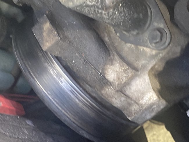

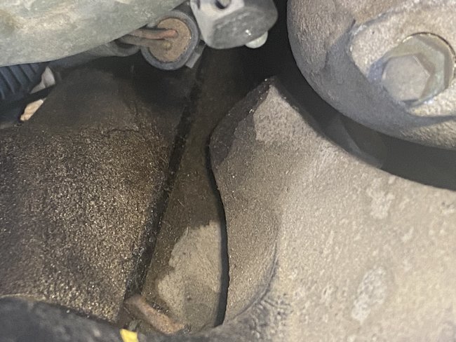

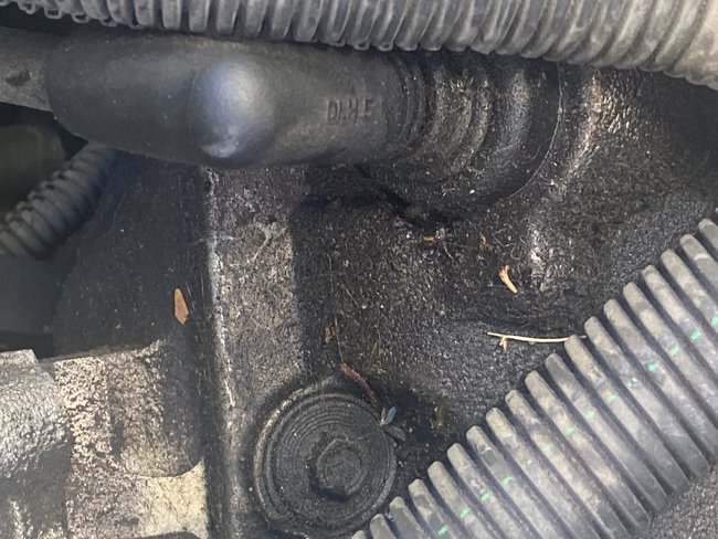

So, I didn’t figure out where op switch was but there is oil everywhere around in there on both sides of engine. I’m posting a couple of pics.

Oil everywhere in there!

I do see the oil. Believe it or not, I've seen a lot worse. LOL Regardless, it needs attention.
In the first picture, where did you take that pic from? Also, if it is on both sides, there is a chance it is coming from the valve covers. However, I still suspect the oil pressure switch with the present code. I believe pic 2 is looking downward at the A/C compressor. Again, a leaking valve cover can cause that.

Pics are from both sides and there is also dry (not fresh oil) where I think a head gasket would be maybe? They did change the oil pressure switch when it was at the repair shop last time due to the 1186 code. So, could the transmission code be due to a valve cover problem? I’m getting confused. Is a head gasket cover the same as a valve cover gasket? I had a Honda with a blown head gasket or maybe it was a valve cover gasket. I remember talk about maybe a cracked head which would have meant replacing the engine. But they did the head gasket thing at a cost of $600 on my Honda Accord. It has been awhile since that happened and I got rid of that Honda. So, for what happened today, it couldn’t be that maybe the fuel not getting where it’s supposed go? I’m just amazed how good it drove last night with no problem and then today it began all that as soon as I pulled out of the driveway. The gas gauge changed quite a bit when I get the car level after my it's been in the steep driveway.

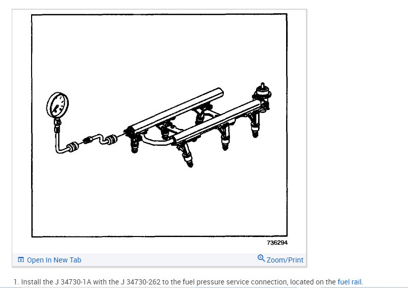

As far as the issue is concerned, you may want to consider having the fuel pressure tested. I don't feel the transmission code would lead to the vehicle shutting off. I have a question. Does the engine restart right away after it stalls or is it delayed?
Here is a link that explains in general how to test fuel pressure:
You would need a fuel pressure gauge, but most parts stores would lend you one. Let me know if you are comfortable doing this.

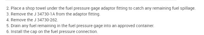

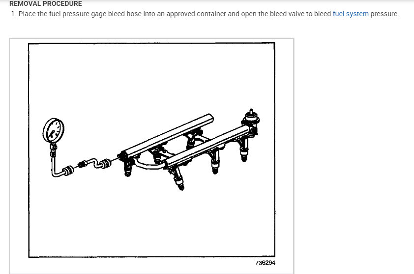

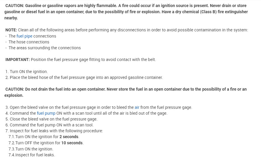

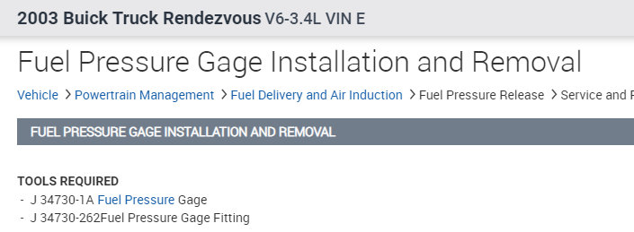

The switch may have been leaking and what you see now is the residual from the leak. As far as checking fuel pressure is concerned, the port is at the front of the fuel rail. See pic 1 below.
I also attached the directions for installing the fuel pressure gauge and the removal.

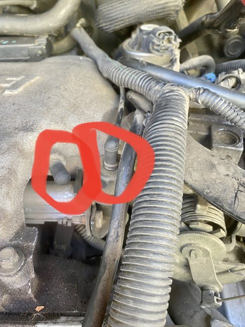

Is this the fuel pressure regulator in the right and the thing to connect pressure test hose to on the left?

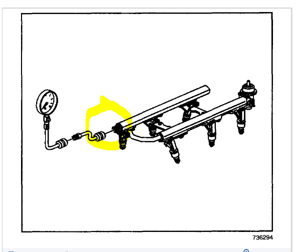

LOL... You're not chatty. As far as testing pressure without a test kit is unlikely to be valid.
In your pic above, the circled item on the right appears to be the fuel pressure regulator. The circled item on the left is not the Schrader valve (where the pressure gauge attaches).
The Schrader is on the end of the fuel injector rail. See pics above. It will have a cap that unscrews.

As far as the test port is concerned, it will be in front on the fuel rail closest to the firewall. The fuel pressure regulator is on the opposite rail and the opposite side.
If you could take a few pics of what you see and upload them, I should be able to copy your pic and identify the port.
