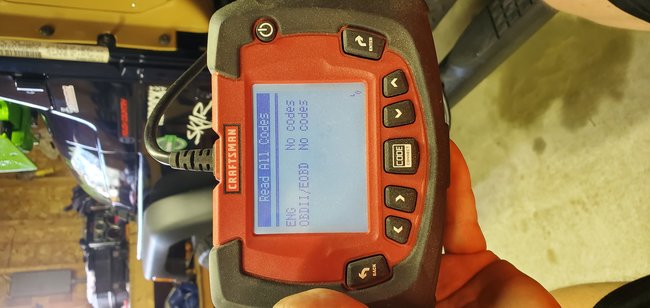

We need to run the codes first so we can go in the direction of the trouble code. These guides can help. Also does the fluid look red not a pink milkshake? Does the speedometer work?

Thank you for your reply, the fluid is fine now (upon initial inspection when I got home it was the tell-tale milkshake which is why I immediately drained it), normal red and to the full line. The speedometer does work, everything does. There is no Check Engine light, nor are there any codes on my reader. It's not a high dollar unit but it's reading clear as of now.

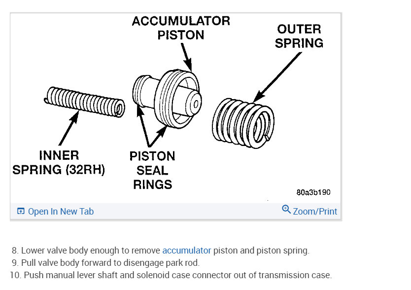

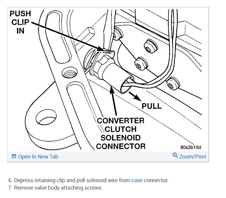

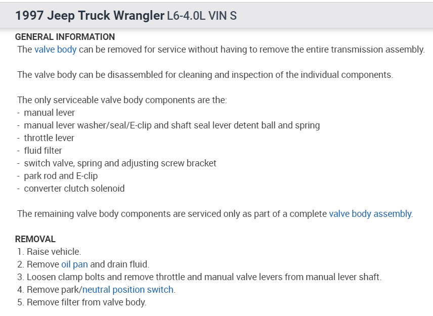

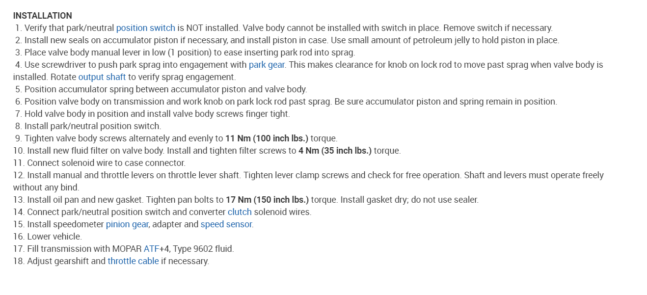

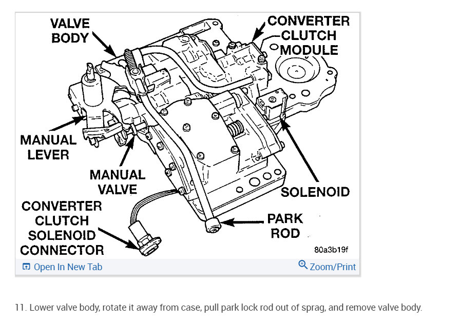

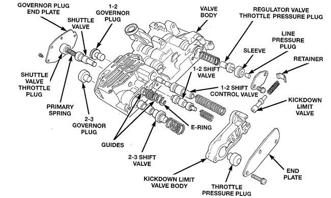

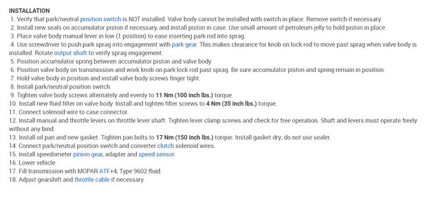

Okay, this sounds like you have a valve body that is not working or has a broken spring, these are easy to remove and get a rebuilt unit for. Here is the location of the valve body so you can check it out in the diagrams below. Check out the diagrams (below). Please let us know what you find.
Jul 9, 2022 at 2:27 AM
MIKE MAXWELL2
That's where I was hung up, is I didn't know the throttle and manual levers needed to come off to get it to drop. I only have access to this vehicle on occasional weekends, so it may take me a while to respond here, but this is very valuable information. Thank you, sir.

After much wrenching and multiple trips up north, she' back! I had one heck of a time getting that top bolt off the shift mechanism, but I finally dropped the front drive shaft and gained the extra room I needed to drop the valve body. Installation of the Solenoid, rebuild kit for springs and rings on the Accumulator Piston, whole assembly bolted right back up. Fresh fluid, fingers crossed, VIOLA All things back to normal! Just a minor adjustment needed for some reason on the shift cable assembly because she won't quite lock into Park, but it's all good. I appreciate your input, thank you.
