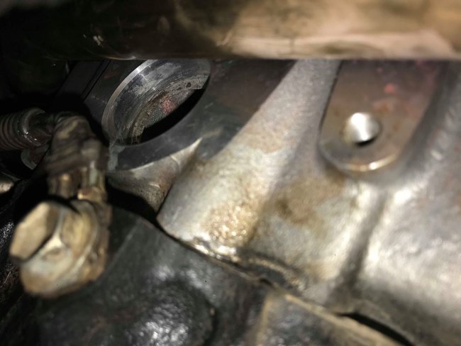

I had a recon engine put in - a 1KZTE.
I did about 8,000 km and the Welch plug popped out at the back of the head.
I had a 1kzte engine installed on 15 April 2018
On 15 September Welch plug at the back popped out. I was towing an empty 3 ton trailer I have done 17,000kms on it I have since found out the radiator had numerous leaks at the top and bottom.
Would it have it been the radiator that caused this?
There is no other fault and I have had the engine block looked at
What caused this to occur?
Engine is now stuffed.

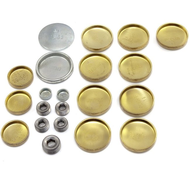

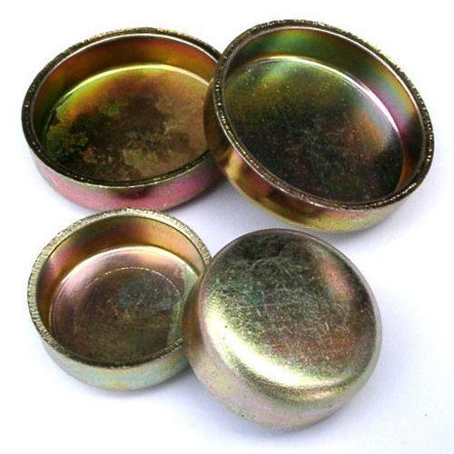

There are a few types of plugs used on engines. There are the Core plugs these look like a cup with straight edges. Then there are Welch plugs, these are simple domed round parts, then there are threaded pipe plugs. Those are the ones in the images attached. In the last picture you see an engine kit for a GM, it uses all three types, as do most engines made these days.
I have seen radiators with plugs in them but not often. If they use one of those styles of plug it could come out under pressure to prevent other damage. Because this is a diesel the compression pressure is much higher. If the head gasket was compromised that pressure could easily push out a core plug or break a radiator. However a bad radiator could have leaked enough to cause an overheat which could also do the same. Determining which way things went would require a full inspection and even then it would be a toss up if it was correct.

The Welch plug was missing from rear of cylinder head.
It was a Recon long fueled exchange engine.
I have been told even if you pull it apart it is not going to tell you much.
The mechanics who installed the engine did not service radiator in installation.
I did 17,000 kms and had two services.
No coolant leaks were noticed, however when I towed a trailer for the first time, this is when the car seized.
I have been told it could be the radiator and I have also been told, it could be the Welch plug because they should not pop out.

That should have been a cup style. From the appearance of the bore that can be seen it looks like the plug that was used was a bit undersized. Also looks like they used a bit of sealer, which is not uncommon but really should not be needed if it is the correct plug. Another possibility was that the plug was not installed straight into the hole. If they are installed at an angle they will not seal properly and can fail.
You did not find the plug by chance? It would show far more.
