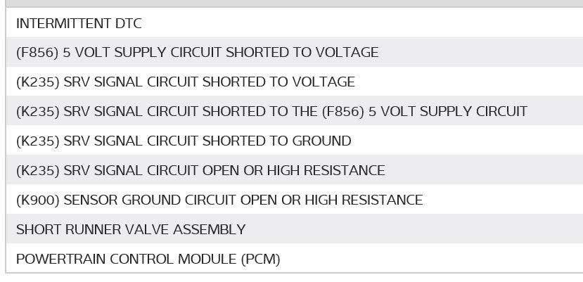

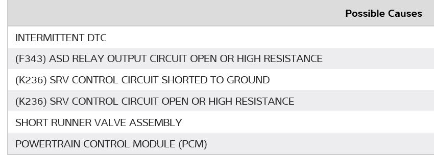

my car started running rough skipping etc., and loss of power. i went to Autozone and came up with three codes. 2 P2017 and 1004 Autozone said the codes showed issue with the fuel system being faulty. either pump or injectors etc. i know it needs spark plugs and there seems to be an exhaust leak.
Jan 6, 2020 at 2:16 AM (Merged)
HMAC300
  • 48,601 POSTS
you only listed two codes not three, but the ones you did list are manifold tuning valve and either pump or injectors. see pictures for causes, but really a mechanic should check this out.
