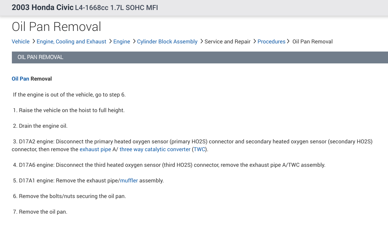

Front of car smells of a strong odor and I can’t really describe. Maybe burning oil? I checked under the hood and didn’t see anything unusual. However, I did check the oil level and it was low on the dipstick. So then I checked underneath the car and saw a slight wet spot underneath the engine or whatever the part is called. Either way, I think oil is leaking and I’m not sure where it’s coming from, or why it’s happening. Overall, I don’t know what the problem is. I also don’t know where to begin, with a problem like this. I just desperately want know what the problem is so I can get it fixed while it’s still the holidays.

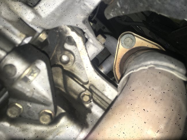

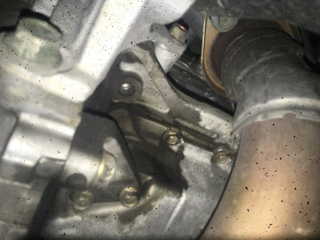

TEE MYSTER
Thanks for the quick response, Alex. I looked under the hood and this is where I noticed the spot of the leak.

TEE MYSTER
Here is a better image.

SCGRANTURISMO
  • 4,897 POSTS
Hello again,

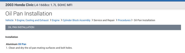

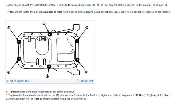

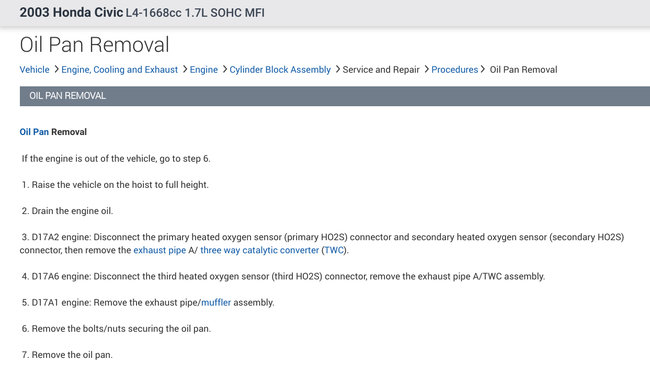

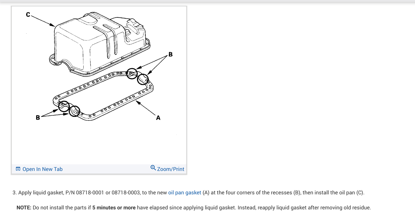

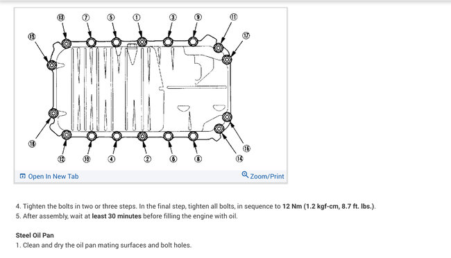

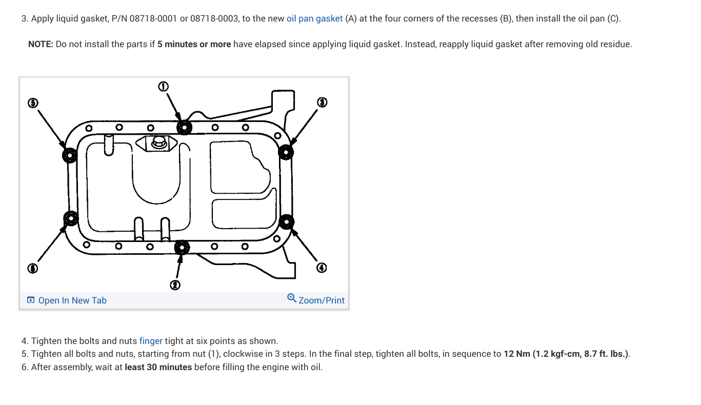

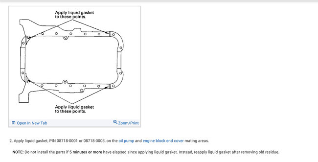

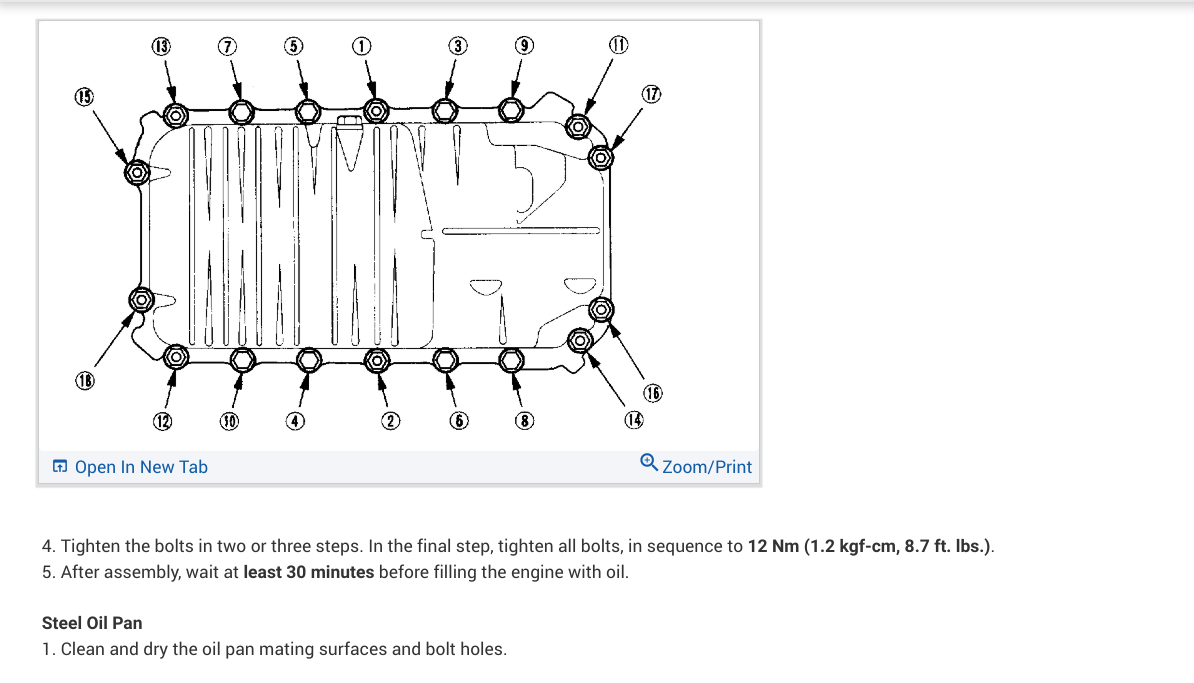

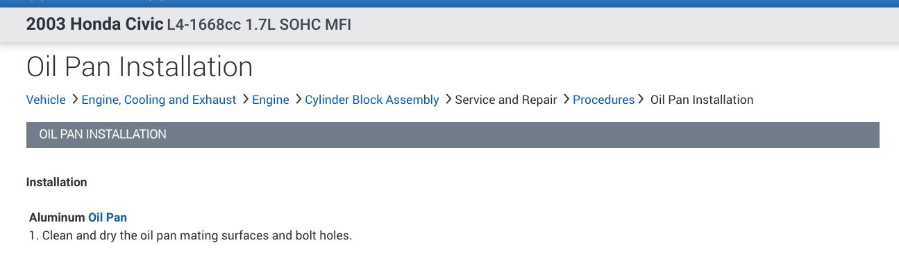

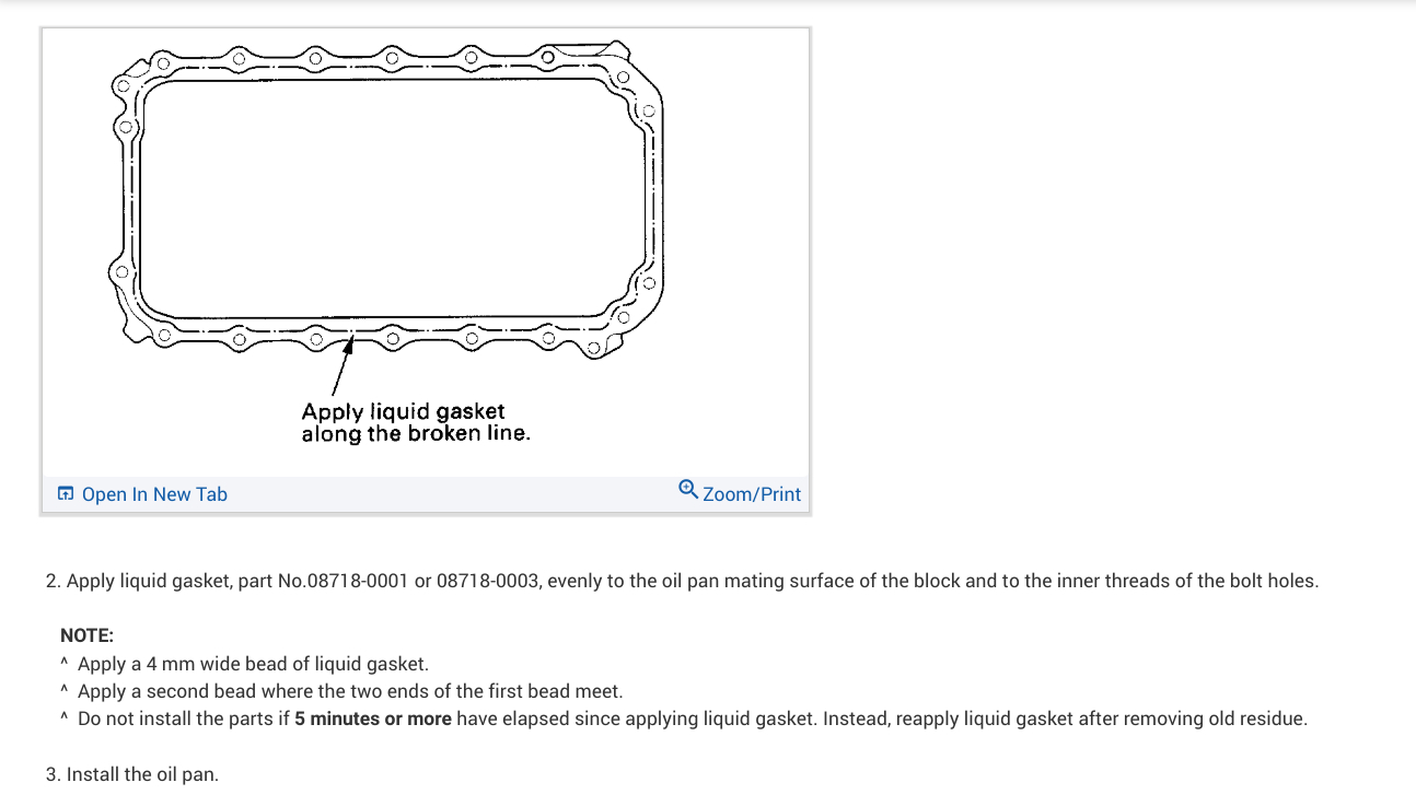

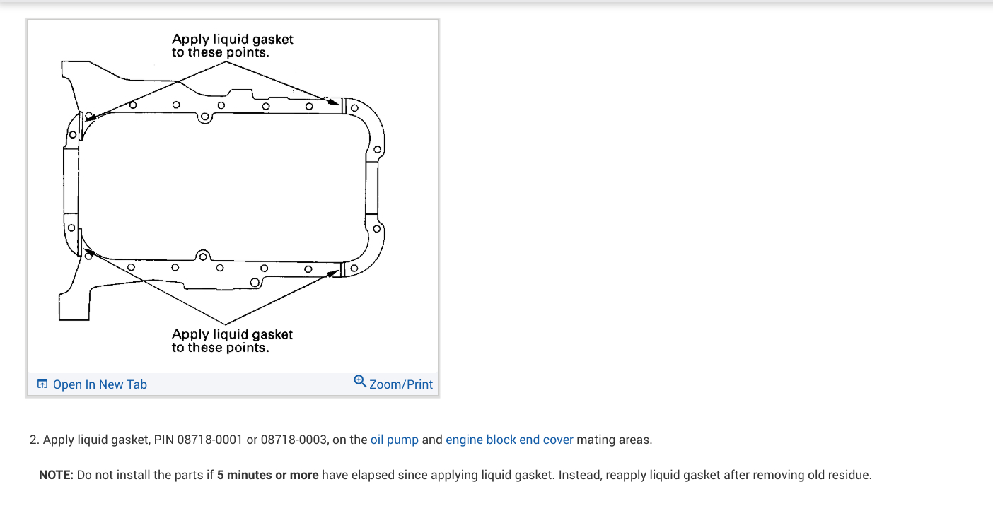

Okay, so that's not a terribly hard gasket to get to, it's the oil pan gasket, which is one of the more common gaskets to fail, so no worries there. In the diagrams down below I have included the instructions for the removal and installation of your vehicle's oil pan. The instructions don't have a pre-made gasket, and call for the use of liquid gasket. I recommend that you use a product made by Permatex called "The Right Stuff". It's a little more expensive, but worth it. Please go through these guides and get back to us with how everything turns out.
Thanks,
Alex
