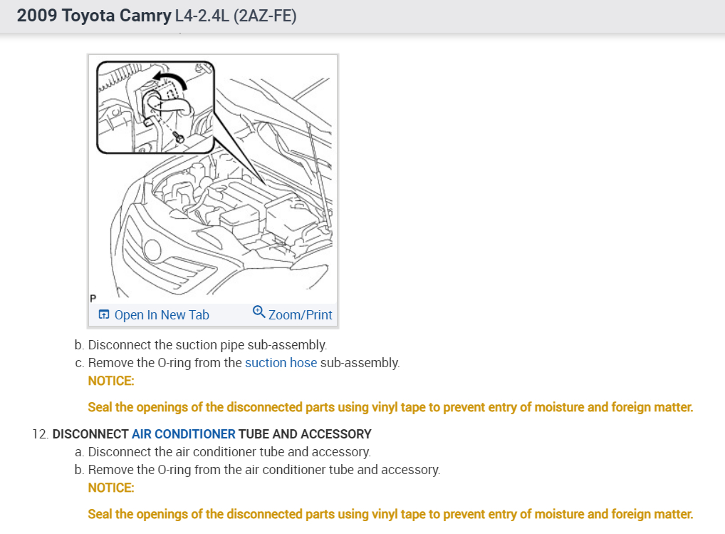

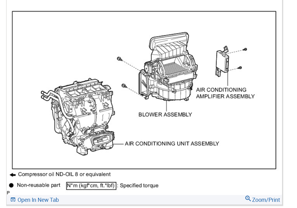

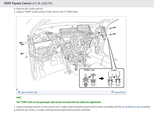

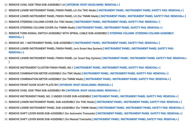

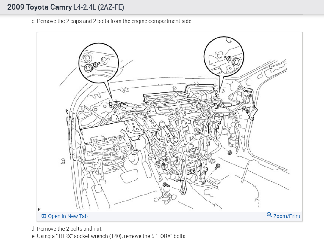

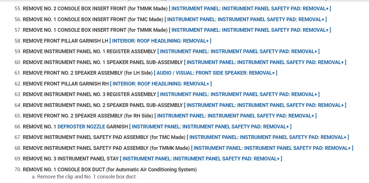

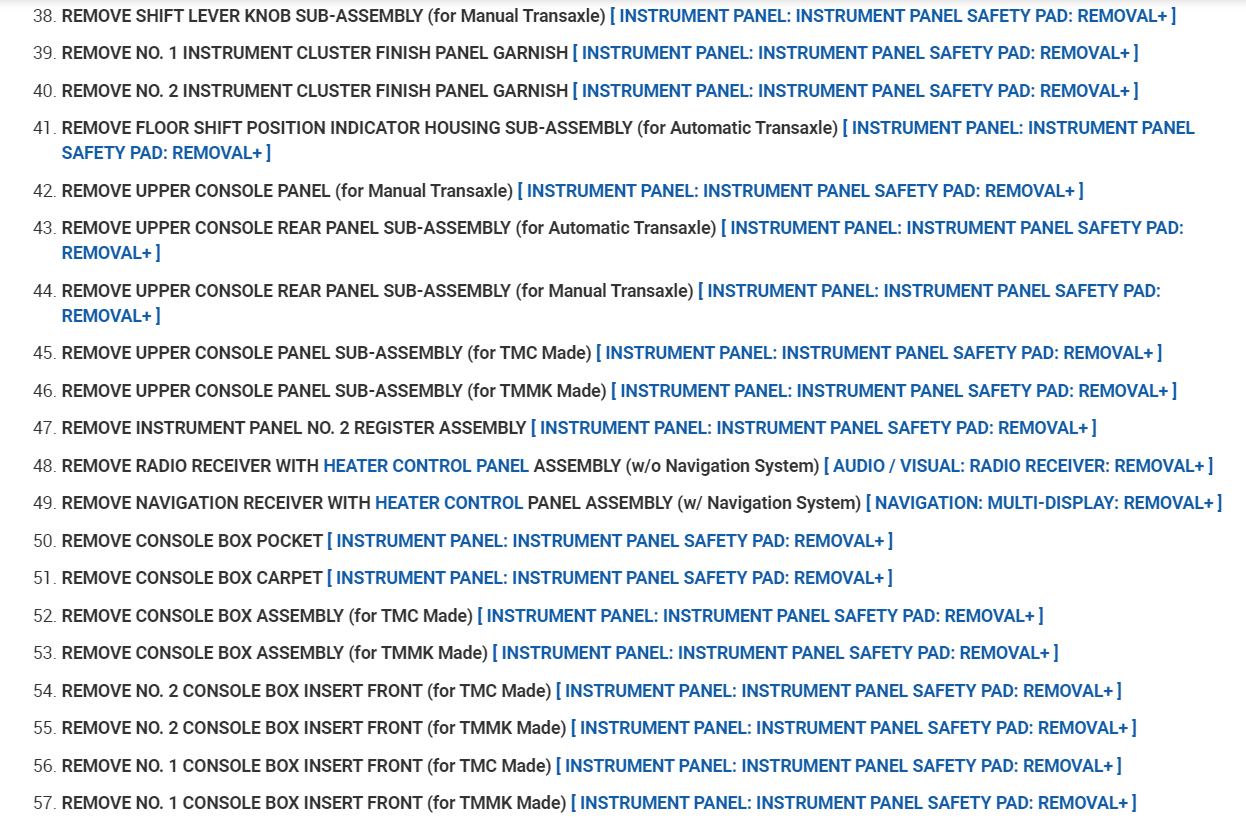

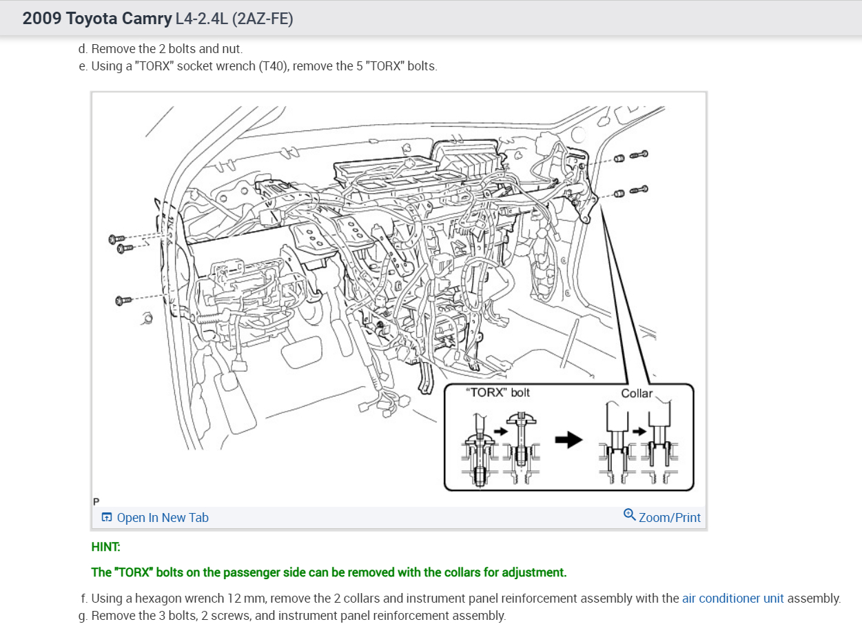

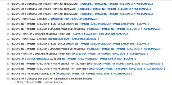

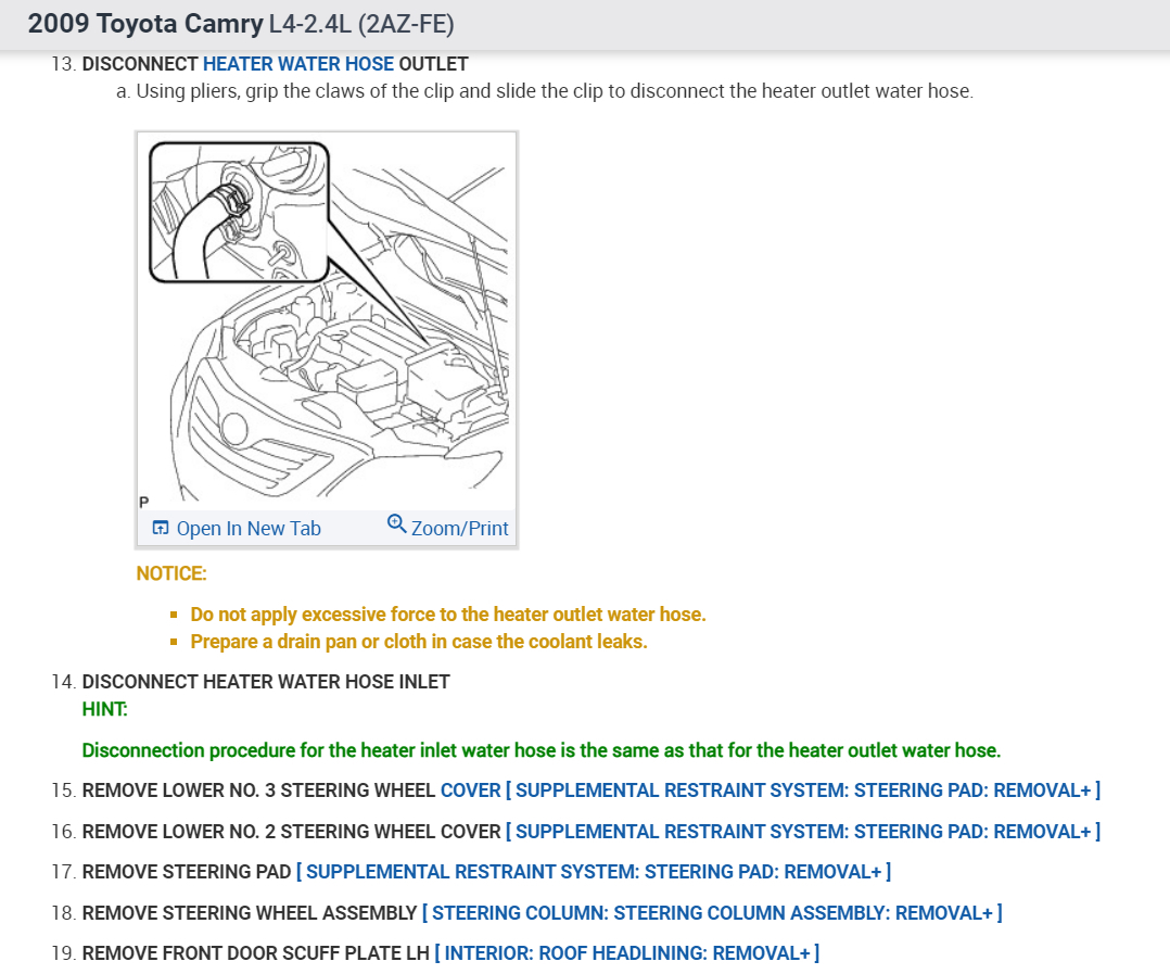

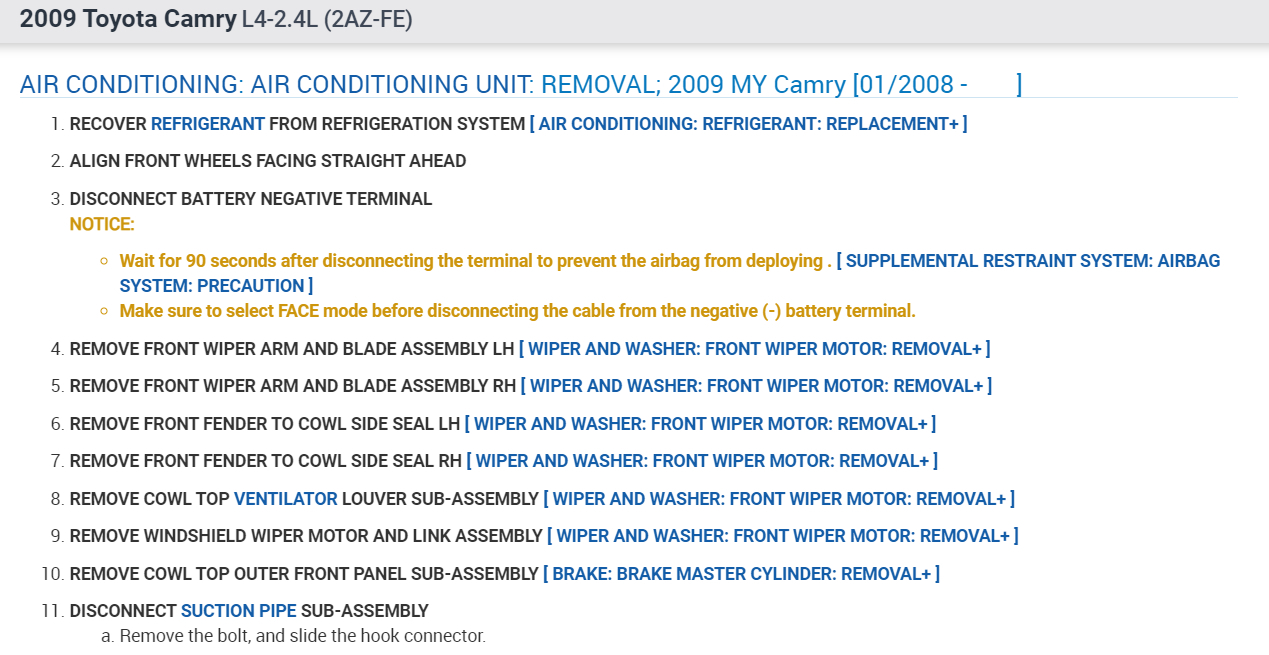

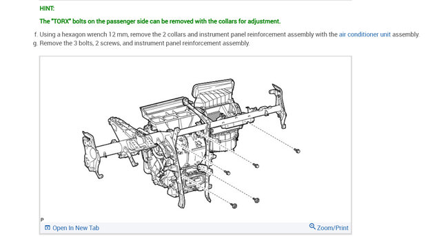

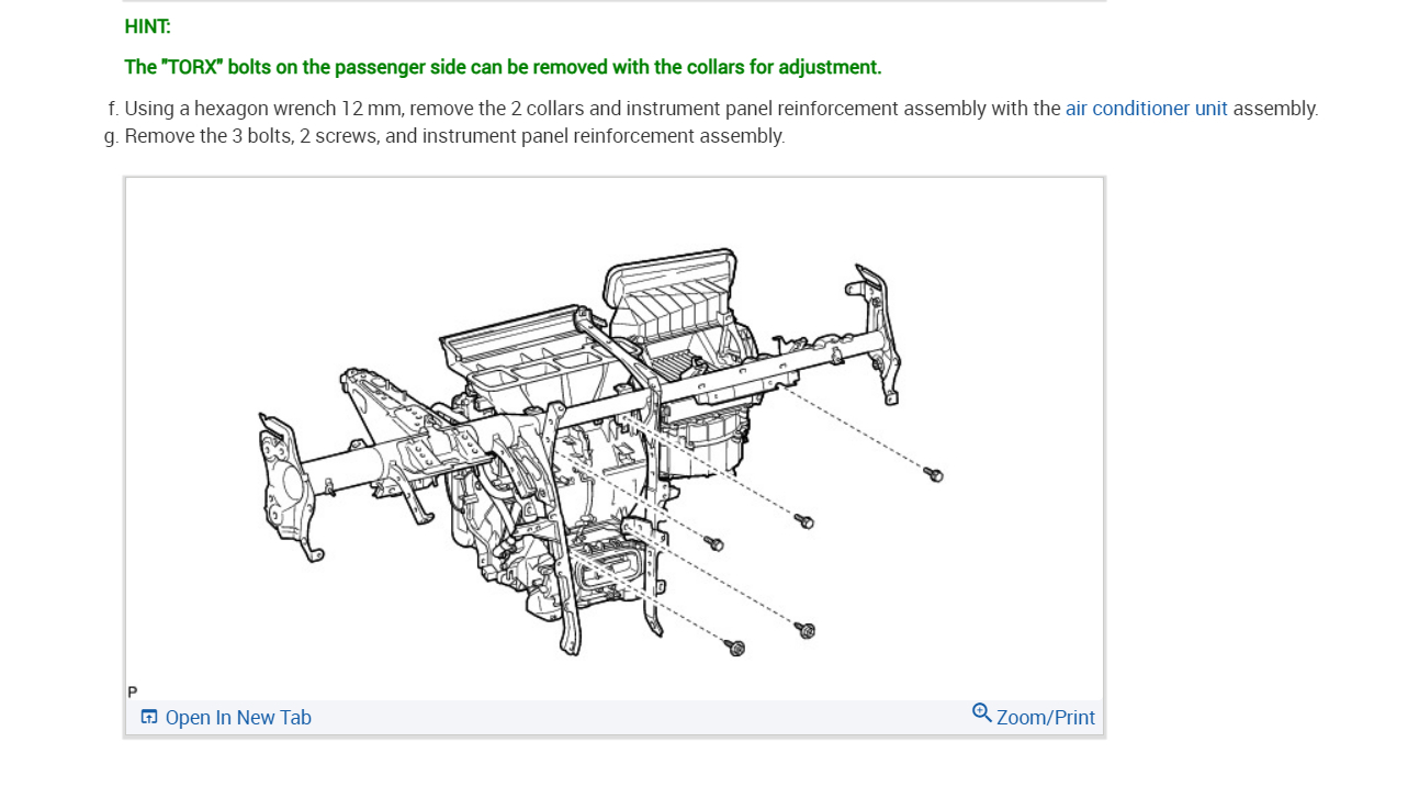

It sounds like the heater core is starting to leak, can you please check the passenger's side floorboard for coolant?
Please go over this guide and report back.

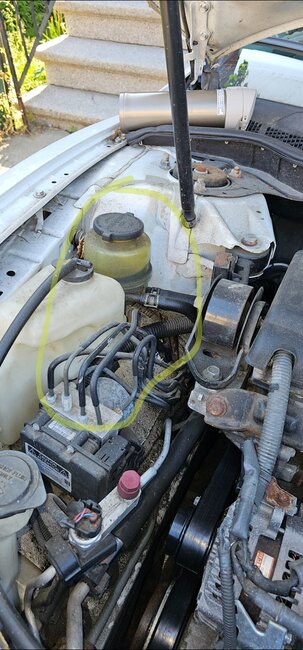

So, I looked under my hood and took a picture and I think that step 4 may be an issue. How would I address that?
Jun 4, 2023 at 7:10 PM
FABIAN CHARLTON
  • 53 POSTS
That hose look damp.

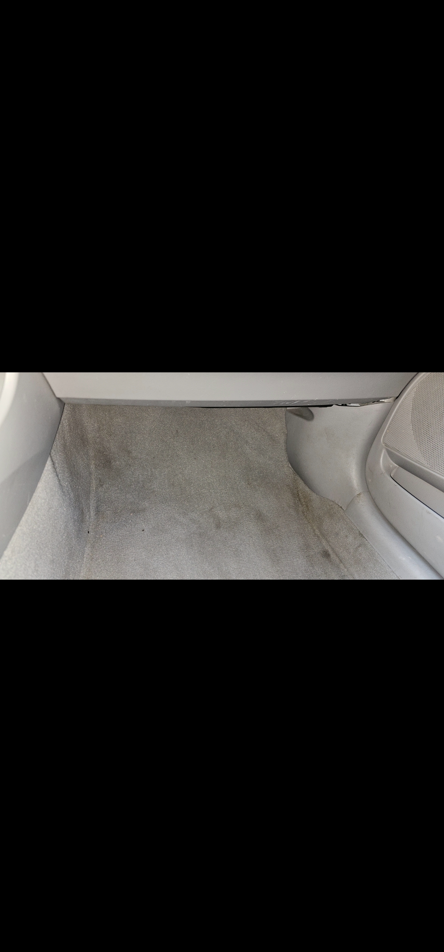

  • 54,832 POSTS

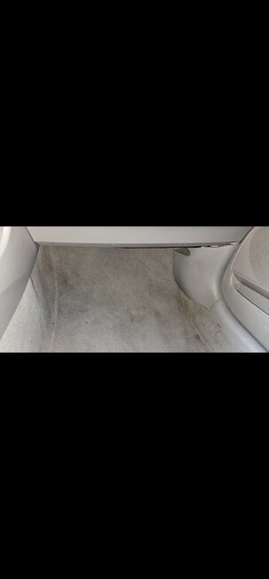

That looks normal but it is hard to tell from the image. Can you check the passenger side carpet under the mat to check for coolant? Can you upload more close up shots?

FABIAN CHARLTON
  • 53 POSTS
There is no leakage.

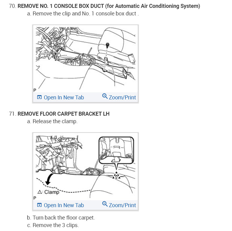

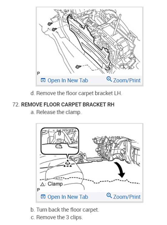

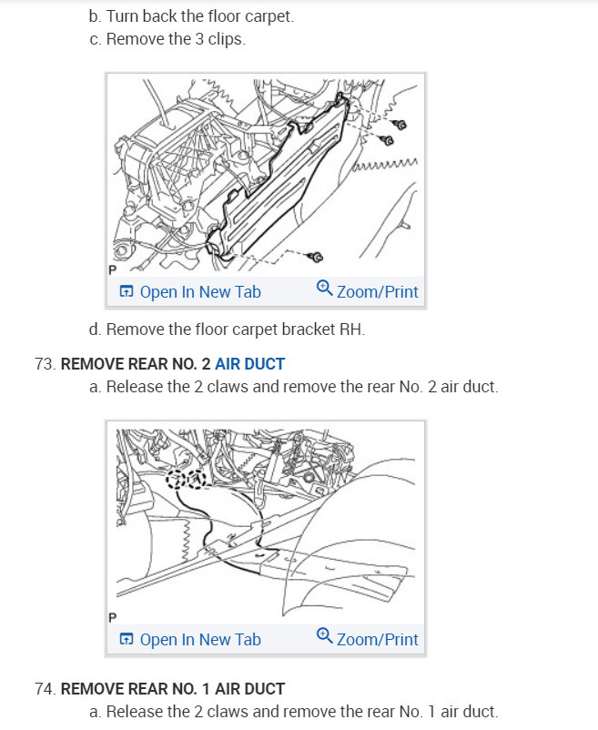

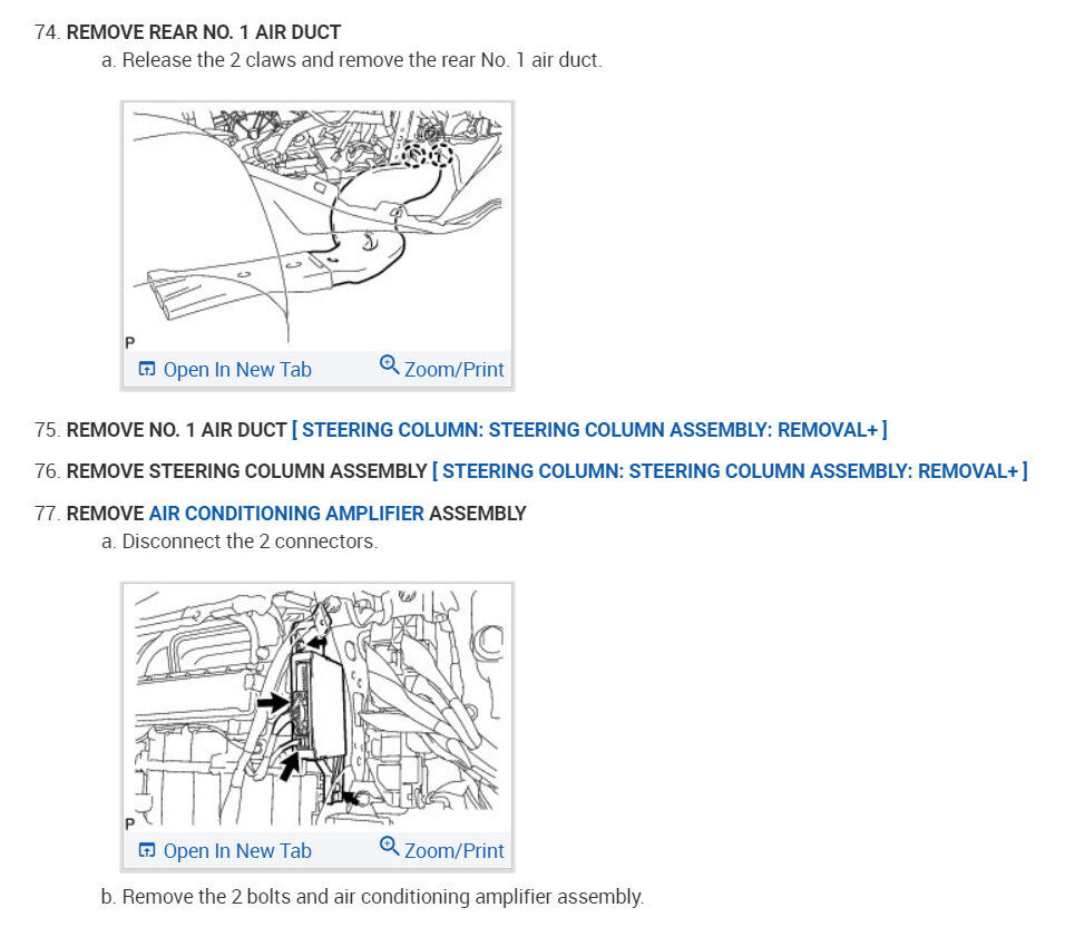

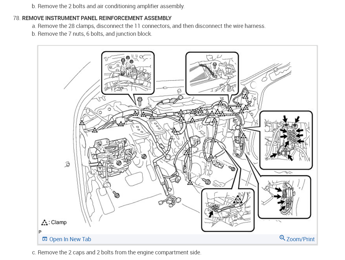

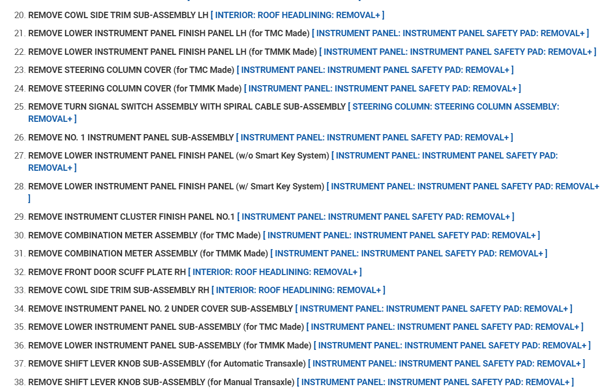

The only way is to remove the heater core for inspection. You will need to start by disconnecting the battery and draining the coolant and A/C system.
Here are videos to help:
https://youtu.be/4EqdrBVb0sY
and
https://www.2carpros.com/articles/coolant-flush-and-refill-all-cars
Jun 19, 2023 at 10:51 AM
