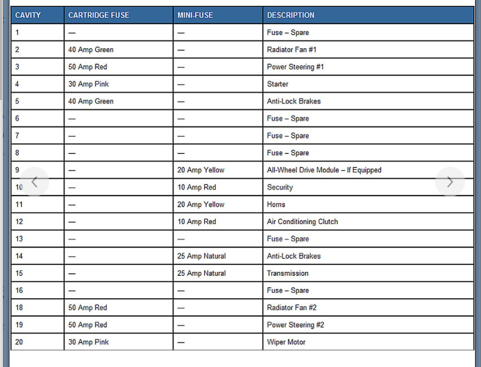

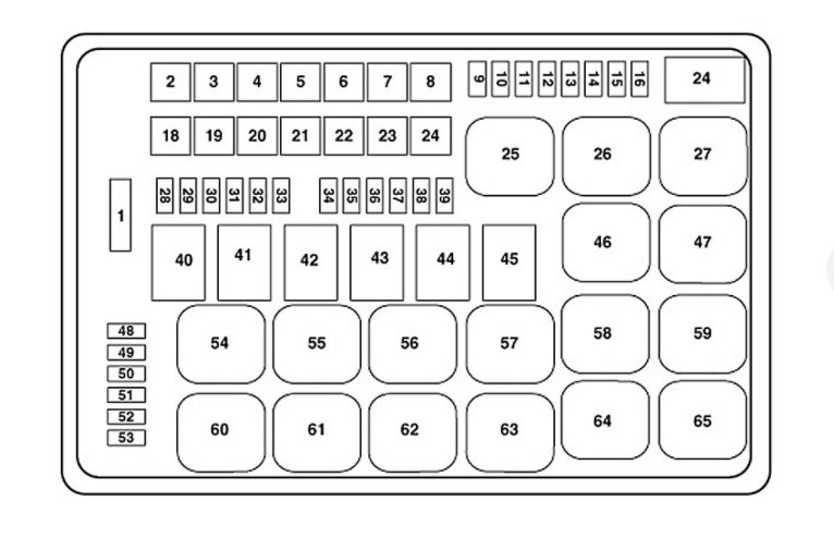

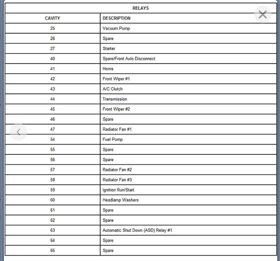

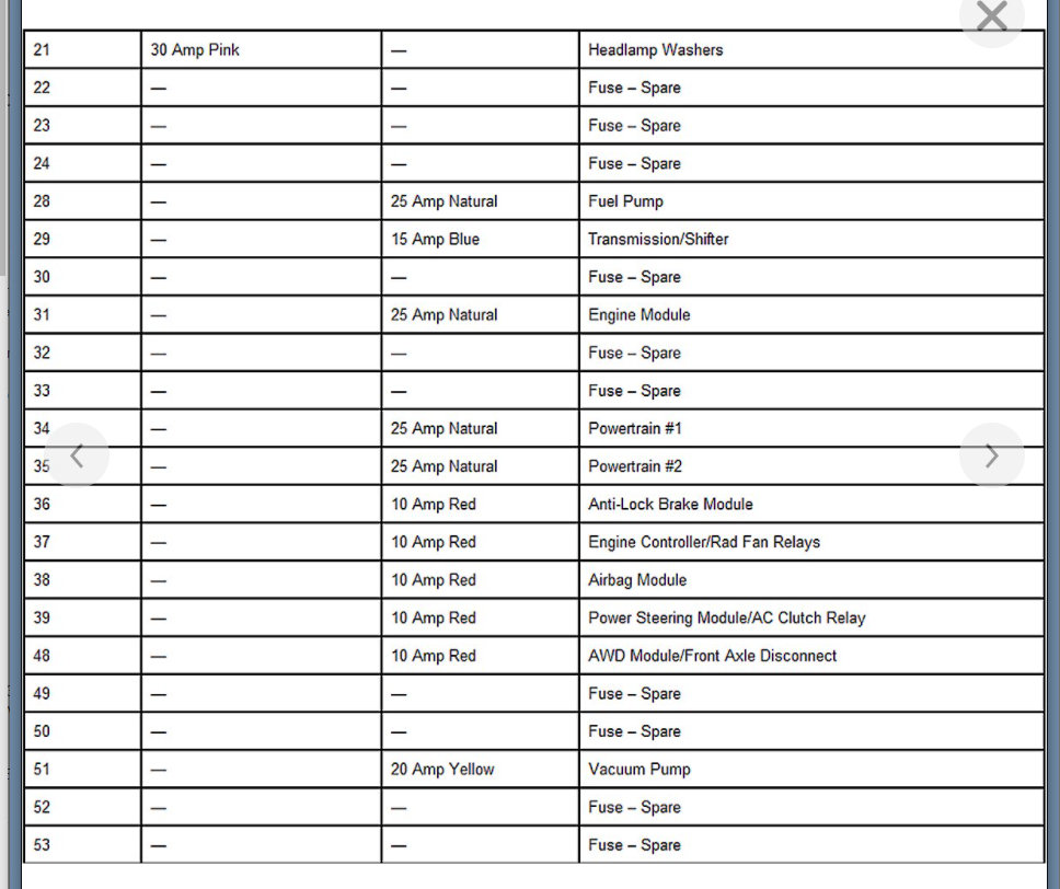

I smell something burning. I need a guide to help check the fuses and I need to know where they are and what they go too?
Oct 12, 2019 at 4:34 PM
Experienced Mechanic
18,907 POSTS
I am attaching the guide that will help with testing and replacing fuses.
Below you will find the detail about the fuses from the manual. Please let us know if you need more info. Thanks
