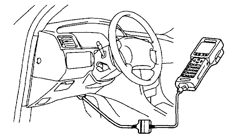

That sounds like it could be related to the idle air control valve (IAC). Here are directions for testing idle speed. Do this first. It requires a scanner,
_____________________
COMPONENT TESTS AND GENERAL DIAGNOSTICS
INSPECTION
CONNECT TOYOTA HAND-HELD TESTER OR OBDII SCAN TOOL
a. Remove the fuse cover on the instrument panel.
b. Connect a TOYOTA hand-held tester or OBDII scan tool to the DLC3.
c. Please refer to the TOYOTA hand-held tester or OBDII scan tool operator's manual for further details.
3. INSPECT IDLE SPEED
a. Race the engine at 2,500 rpm for approximately 90 seconds.
b. Check the idle speed.
Idle speed (w/ Cooling fan OFF): 700 ± 50 rpm
If the idle speed is not as specified, check the IAC valve and air intake system.
4. DISCONNECT TOYOTA HAND-HELD TESTER OR OBDII SCAN TOOL
___________________________________

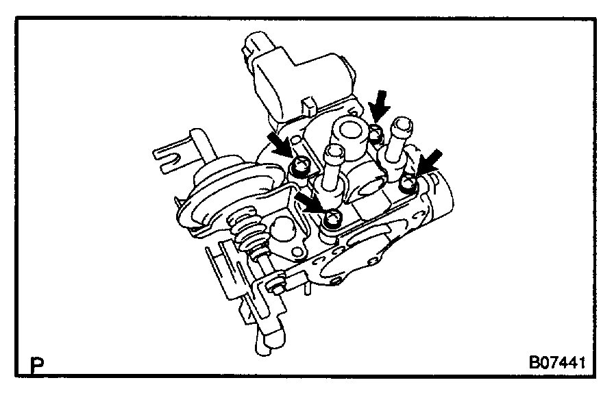

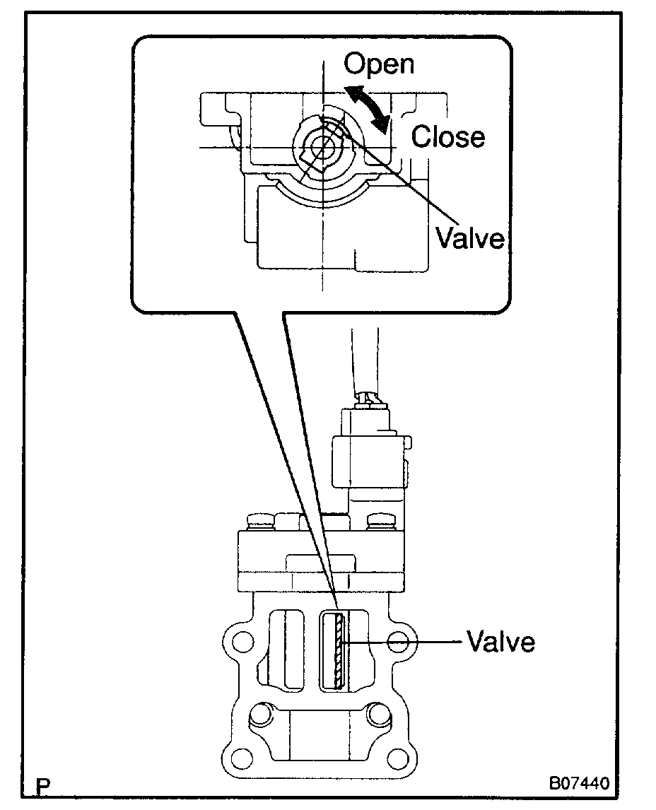

If the vehicle fails the test, check the idle air control valve located on the throttle body. Here are the directions for inspecting. See pic 2
IDLE AIR CONTROL (IAC) VALVE
INSPECTION
INSPECT IAC VALVE OPERATION
a. Check that the IAC valve is half opened.
b. Connect the IAC valve connector to the IAC valve.
c. Turn the ignition switch ON.
d. Check that the IAC valve moves in 0.5 seconds by order of fully close, fully open and half open.
If operation is not as specified, replace the IAC valve.
e. Turn the ignition switch OFF.
f. Disconnect the IAC valve connector from the IAC valve.
__________________________________________________-

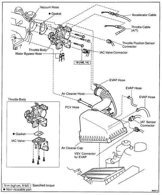

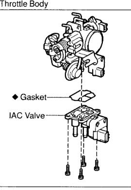

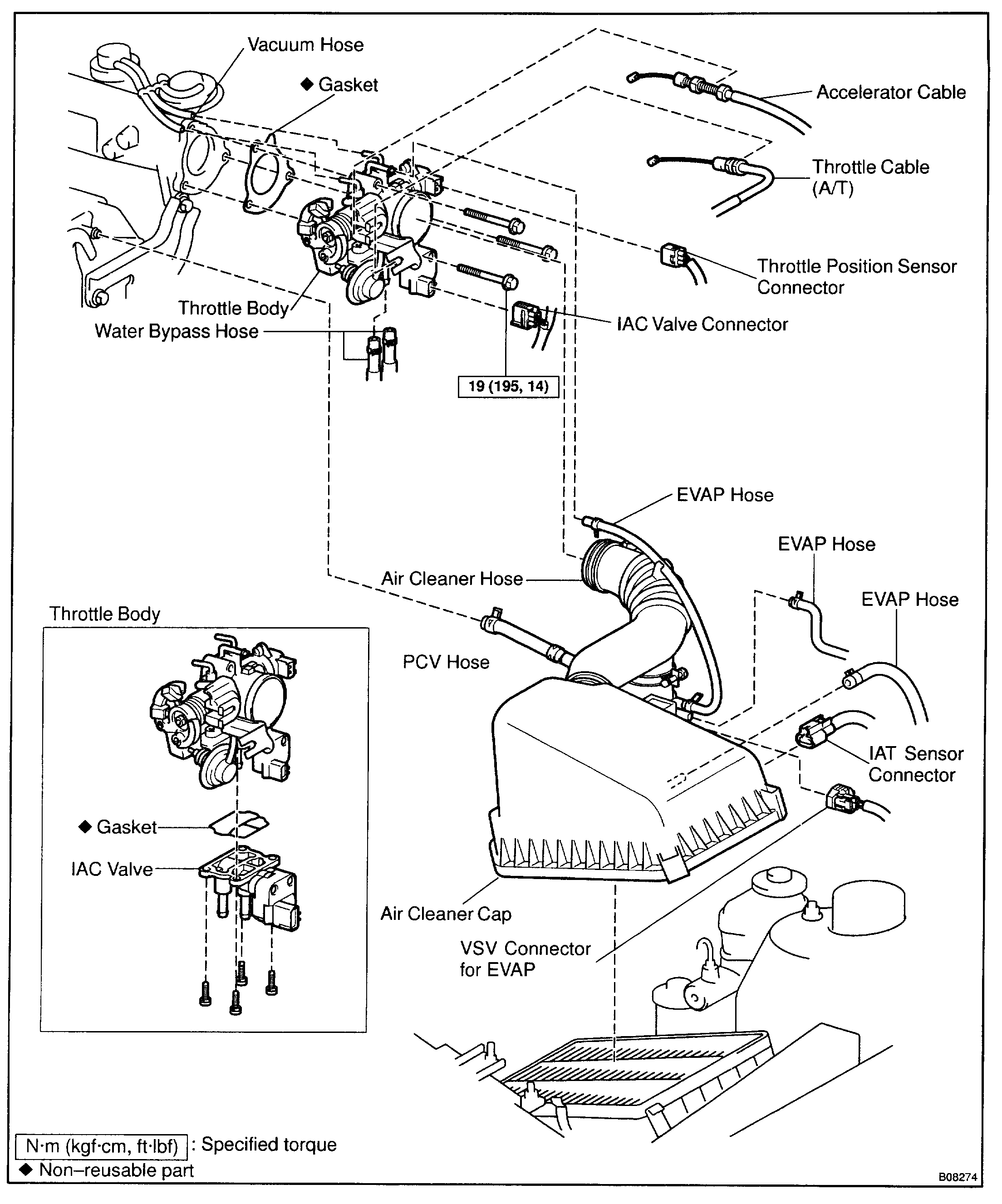

If the IAC isn't functioning properly, it will need replaced or cleaned. Here are the directions for removal and replacement. All remaining pictures correlate with these directions.
REMOVAL AND INSTALLATIUON
Ideal Air Control (IAC) Valve
REMOVAL

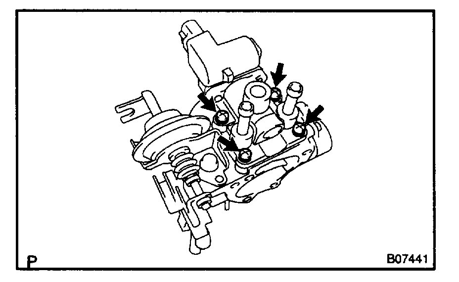

1. REMOVE THROTTLE BODY
2. REMOVE THE IAC VALVE
Remove the 4 screws, IAC valve and gasket

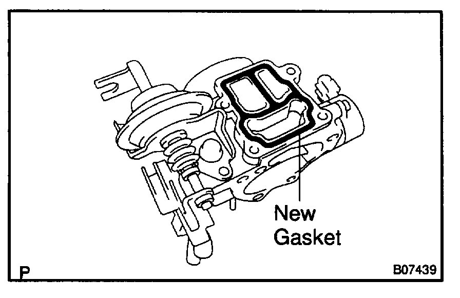

INSTALLATION
1. INSTALL IAC VALVE
a. Place a new gasket on the throttle body.
b. Install the IAC valve with the 4 screws.
2. INSTALL THROTTLE BODY

Got a car's repair manual, and there are IAC test procedures specifically for the model/year and engine (2001 Camry four cylinder, 5sfe). Basically the on-car check is like the following:
- Engine to operating temperature, and gear to Park.
- Be sure idle stable at normal (~700rpm for mine).
- Bridge E1 and TE1 on DLC1 with jumper wire.
- RPM should rise to 900-1300 immediately for five seconds, and then return to normal (700).
My result: RPM increased to 850 and stayed for three seconds, and drop to 620 and pretty steady there. Apparently the IAC failed the test strictly per the procedure. But do the behaviors and the test results indicate that the IAC does have response to PCM? May not be working to designed specs at idle?
I am trying to remove the IAC valve, then can check closer on valve, and maybe do a thorough cleaning. But now got stuck with breaking loose its screws, too tough.

Hi Joe and everyone. Sorry for being late to update. I have been fighting an attempt to remove the IAC for weeks, but still no avail, even with screw extractor. I gave up.
But I tried this alternative: apply batter power to the open and close pins alternately, and spray TB cleaner at the same time. Just wish it could help. After then I indeed observed some change to the idle behavior after cold start - the RPM up and downs not that significant as before, while still erratic.
So this should, plus the fact it failed the test on repair manual, indicate the IAC valve is somewhat faulty. I will live with that as everything is good except for a rough cold start.
