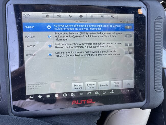

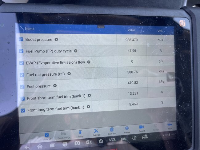

No transmission codes. When i out it in gear and drive it it's sluggish with a weird noise coming from the engine area. Put it in park and it's gone. When i turn it goes and comes. Most likely this mount? Has some engine codes but no check engine lights. I deleted them and they went away.
