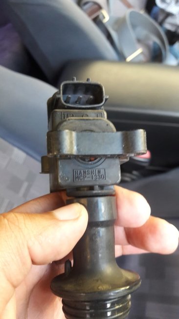

I am out of idea's and I not know.
I bought a Skyline R33 forty anniversary three weeks ago.
I serviced it (changed oil, oil filter and spark plugs) and the car runs fine. I do not drive a lot. Probably twenty minutes to work and twenty minutes to go back home after work.
There are times where I drive more than thirty minutes and after thirty minutes while the car is on, I suddenly hear gurgling noise. I can turn the car off let it cool off completely, and start the car back tomorrow and drive to work and that sound will not happen. It only happens when the car is on more than thirty minutes.
Since I am using water in the radiator I thought maybe changing to a coolant might help. But on forums I see people talking about thermostat and a blown head gasket but I am not sure.
I have tried three different mechanics but they seem to not have time so I am desperate for suggestions and help. What could be the cause?

I drove yesterday for over thirty minutes but sadly no sound. So I went home. I have not driven the car today yet but I will try later on tonight.
Basically this is my car when I start it up: https://www.youtube.com/watch?v=AHx1MOlzlxk
And this is what it sounded like both times I drove over thirty minutes and it happened: https://www.youtube.com/watch?v=yiprCFiFk5Y (sounds exactly like this wrx)
And I feel like it also loses a bit of power.

I have a straight down pipe actually. I drove with a friend today to see if it will happened and it fully happened. just in a second it just changed on me like one of the coils gave up or something, but I am not sure.
listen to this https://www.youtube.com/watch?v=tQKjAuVxRWI
So disgusting.

Yes, it sounds ignition related. I would install OEM spark plugs and coils also service the throttle bore. Here are two guides to help you:

Well, we tested the coils after the car warmed up and started working bad like a WRX and unplugged and re-plugged all coils one on one. Coil three removed and nothing happened while the five other coils removed and the car worked even worse. So my friend who owns an r33 as well put his coil in mine and bam. Worked good as new.
so TLDR: One coil is completely dead and I am going to have to find an OEM coil for now and maybe in the future change all six for a better pack.
Saturday when I am free I am going to drive around and see if it will happen again. If not then the faulty coil would be the only issue I hope!

Yep, that will do it. I would do like you say and replace all of the coils. If one went out the rest are right behind it.
