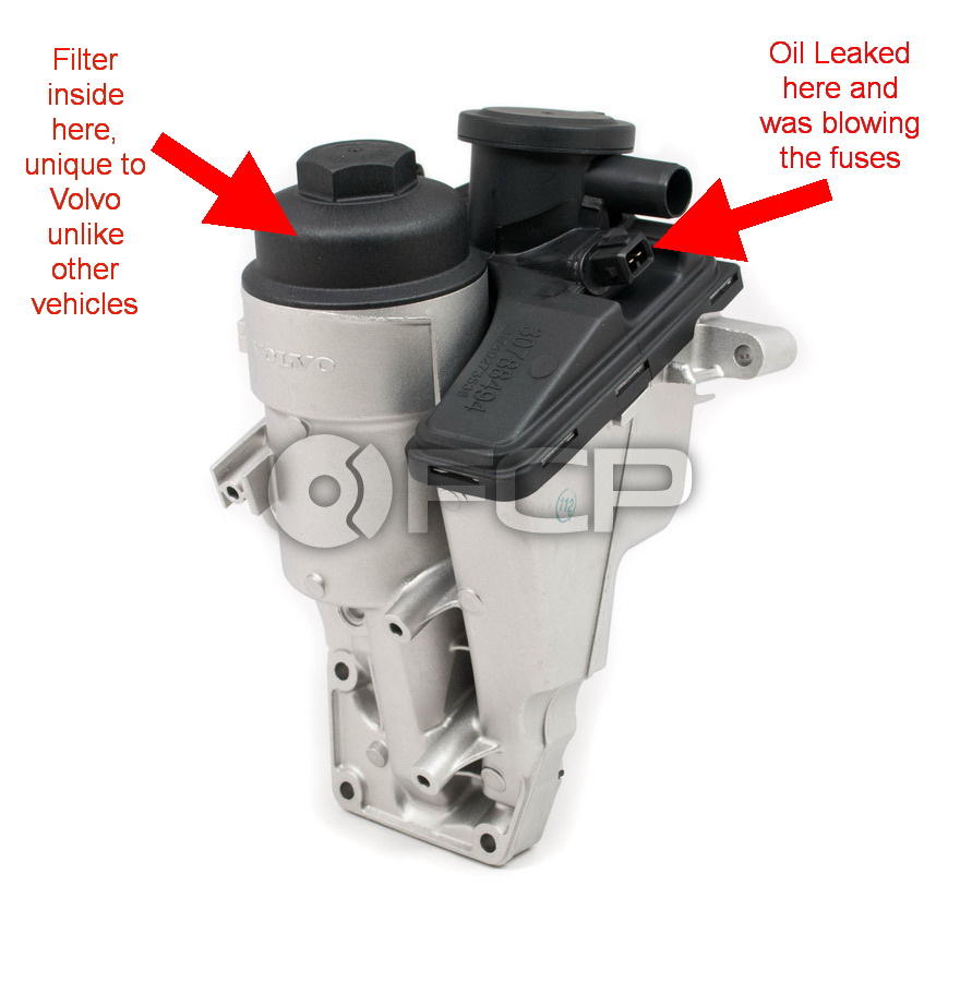

My Volvo Started making a VROOM sound upon acceleration, then I noticed the AC was not blowing cold air...then Check Engine Light Came on!!
Since it was Sunday, I went to Firestone to diagnose it...The mechanic refused to repair it, but gave me some ECM error codes his computer read:
1300- Mass Air Flow Sensor
400- canister Purge Valve
4310- leakage Detected
4350-Leakage detected Heater
6000- AC relay
6400- Cam Shaft Reset
The mechanic said it could be one thing that sets all these codes off...but he has no clue how to fix this.
He suggested I go to a Volvo Specialist, which I do plan on going.
Regardless, I'm eager to go educated to the specialist, any ideas what may be going on, if its something I can do myself? I am pretty handy on DIY work!

I have seen were the fan clutch lockup to make that noise. It could be bad, or the engine is overheating causing the problem. As far as the codes go, I would clear them all and let the system reset to recheck the problem. Could be just a glitch.

I got this car from Beverly Hills BMW, They claimed they had changed the oil and oil filter. I went on driving the car for about 47 months before it started doing this.
Turns out the oil filter was never changed, it's not a conventional oil filter, so somehow the oil leaked in the Oil Housing Unit shorting out the A/C...
Once the oil housing unit was replaced, added new filter and oil...Everything stated working fine!!
Funny how I got a total of 12 error codes due to one component, once one was fixed they all went away!!

Not the Oil itself....The entire Oil Housing Unit had to be replaced!

Because the Oil Filter was very old, it had gathered gunk, and the oil filter leaked out and shorted those two connectors shown in the attached picture.
The shorting was blowing the A/C fuses, eventually the Windows would NOT go up or down....making it a SAUNA in the middle of the summer!!
The oil at this point had gone very low, the car was making a growling sound and was trembling...It almost turned off on me at a stop light.
Having told that "tiny" detail that the car almost turned off on me at the stop light was what made the technician check the Oil Housing Unit and found the problem....
What the Technician saw was that the fuses were just getting blown, one after the other...thus making him think it was some electrical issue and possibly had to open the entire dashboard and start digging to find what was blowing it...that was until I remembered that the car almost turned off on me at the stop light!
