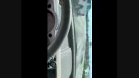

This is a video of what is doing. Thanks in advance.
Feb 26, 2020 at 8:45 AM
It was a little hard to make out but it definitely sounds rotational so I would suggest lifting the vehicle off the ground and support it on a lift or jack stands and then put the vehicle in gear and see if you can isolate where it is coming from. If you no longer hear it then it is either the tires or possibly the bearings.
