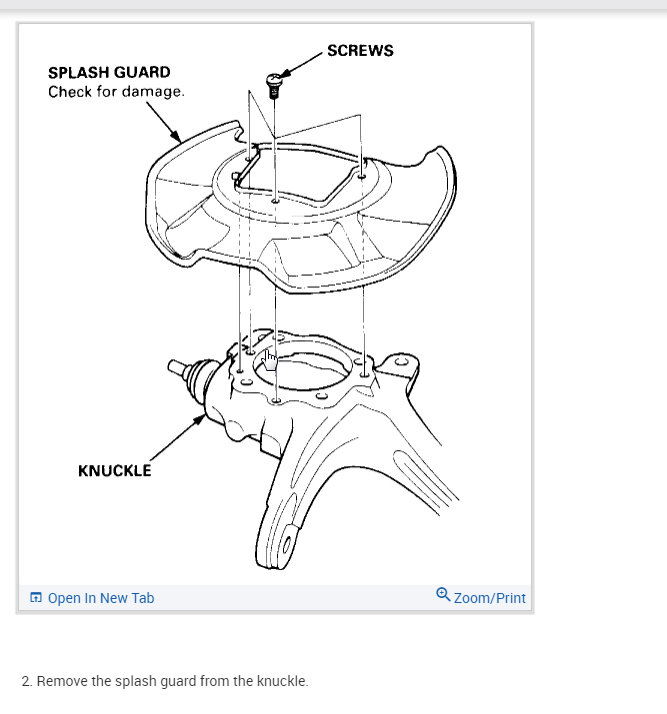

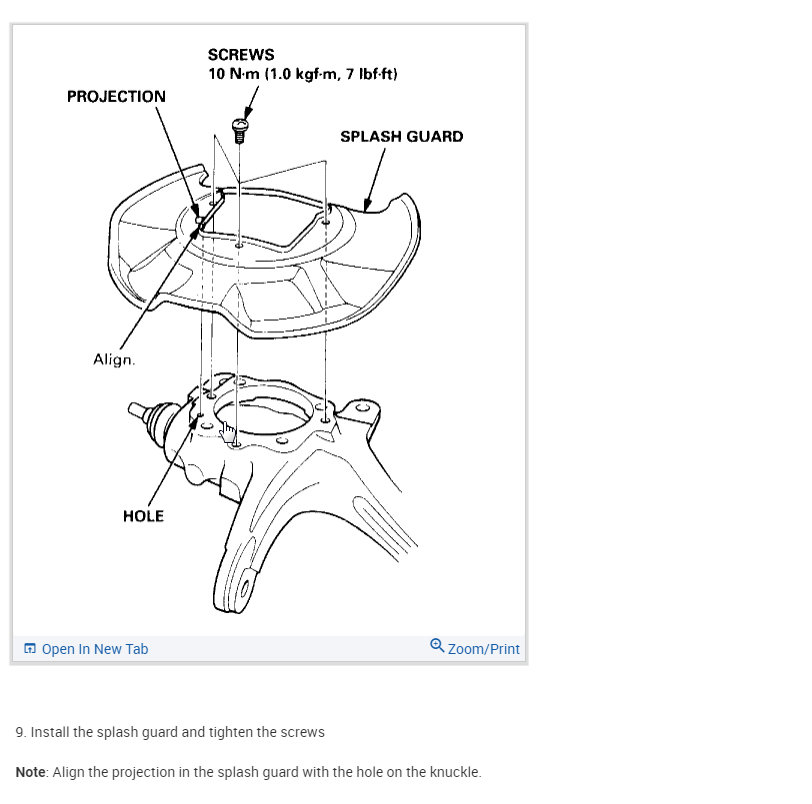

When in motion front passenger side wheel area makes a weird almost scraping sound. I've taken the wheel off multiple times and tried bending the brake splash guard thinking that is where it was coming from and no dice. could it be my tie rod end possibly or some other suspension problem? thank you in advance.

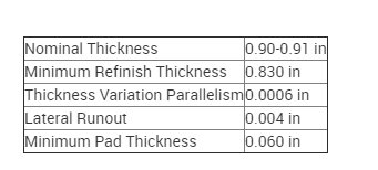

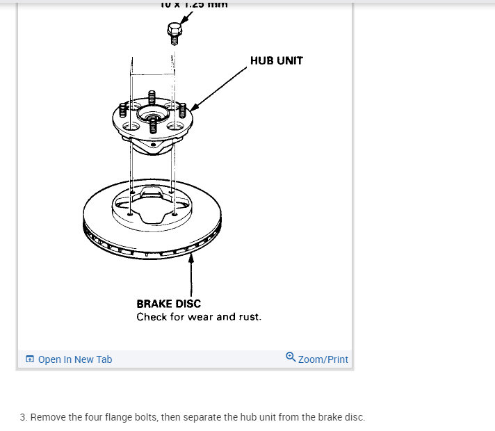

The video did not attach so it you could try that again that would be great. However, if it started after changing the brakes and it is not the baking plate then I would think it is the pads dragging. Did you replace the rotors as well? Also, what type of pads did you put on it? If the composite is high in metal they will make noise when they touch the rotor. This means if the rotors have run out then that is the issue.
Jan 9, 2020 at 10:02 AM
RODOGG3636
  • 5 POSTS
Okay, changed my rotors. now when I tried to drive it's a weird feeling like I didn't get the axle in all the way and there's some play to my tire going up and down. I'm so confused.

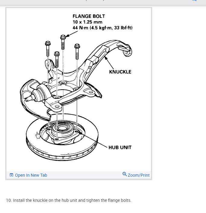

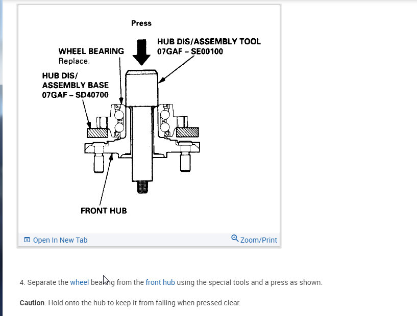

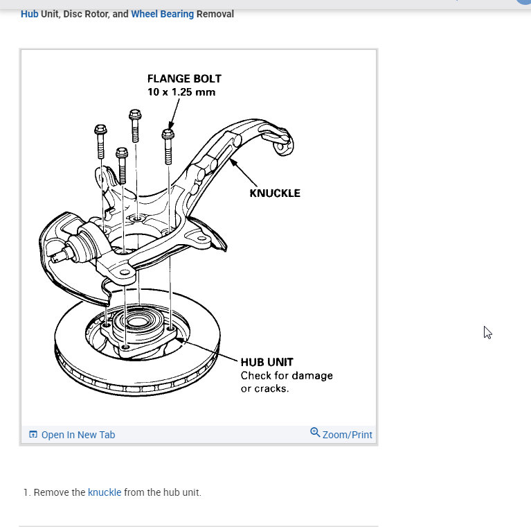

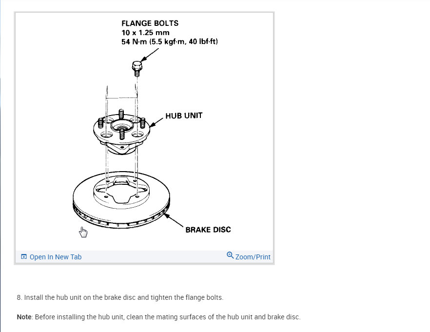

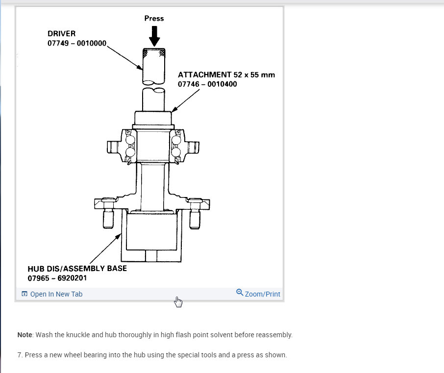

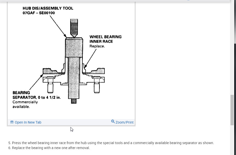

I meant there's play before I lower it back down. but I think I need a new wheel bearing is why.
Jan 15, 2020 at 10:45 AM
Oh. Okay. Yes, if you have excessive movement up and down that is either wheel bearings or ball joints. However, your wheel bearings are a hub assembly and these are less likely to fail in this manner without making noise but due to you other complaint of the noise, this may be the issue.
Jan 16, 2020 at 10:40 AM
