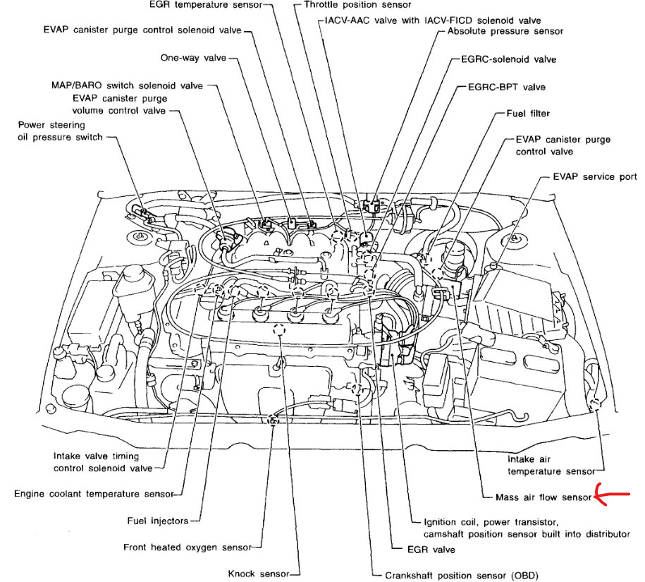

I have been experiencing issues with my car running lean. When I bought the car, it had a misfire. so, I replaced spark plugs, distributor, spark plug wires, fuel filter, and a new o2 sensor. car started to run great, but I noticed it still never got good gas milage these cars average 40, I get maybe 20. so, after about 10k miles on the new ignition system I checked the spark plugs and they were showing signs of extreme lean conditions. With these lean conditions I’m experiencing gas in my oil. The car doesn't blow smoke, and it runs better cold than warm. I decided to check each cylinder after and noticed some decent pitting on each piston, but the cross hatch and cylinder walls seem to be in good shape. I should note the car has always thrown a p1320 primary ignition code before and after the parts and I'm just stumped as to what’s causing the lean mixture in the cylinder and pitting on the pistons and terrible fuel economy put the motor still runs fairly well no misses or noises and I want the car to last as it’s in great shape for a 98.

There is an internal ignition coil that sounds like it is going bad, but I would replace the ignition distributor with 140k on it. Also, I would swap out the MAF sensor as well.
The P1320 code on a 1998 Nissan Sentra indicates an Ignition Signal Primary Circuit Malfunction.

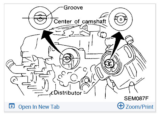

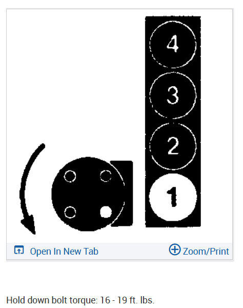

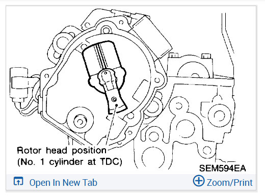

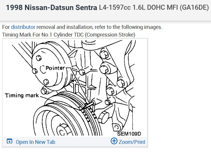

Here is how to change out the ignition distributor and set the timing, I would also make sure the spark plug gap is correct and that you have the correct spark plugs installed.

This guide may help as well.

Ignition Timing - Base 8 +/- 2 Deg. BTDC
Check out the images (below). Please upload pictures or videos in your response of any problems so we can see what to help you with.
