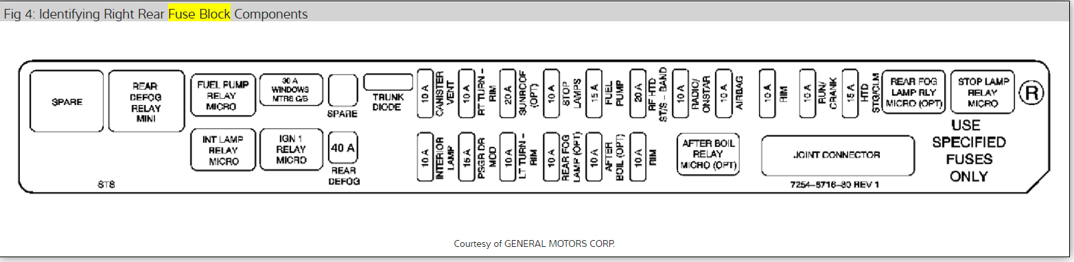

My battery was dead, so i replaced it. Since then the following happens:
Alarm goes off - randomly, with no on near it;
HVAC air - no longer blows on floor or up to windshield, only the main vents (temp control still works). this is all the time;
Car tells me the hood is unlatched, when it isnt - this is random;
Passenger car door wont open from the outside - randomly. Sometimes it works and sometimes it wont
The driver settings will disappear. I have the mirrors/seats/settings set up and every so often, i will get in and it will be set to something different - and ill have to reset it all.

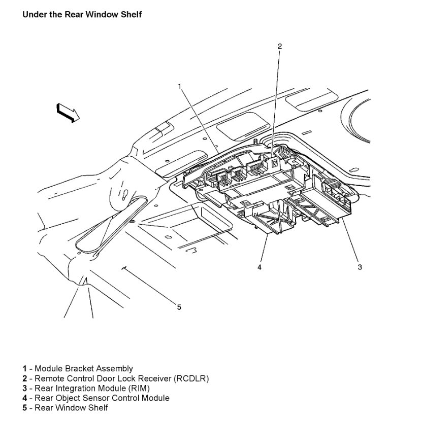

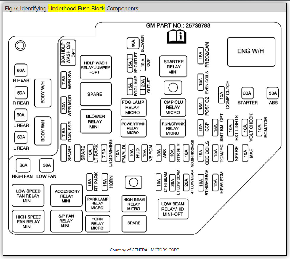

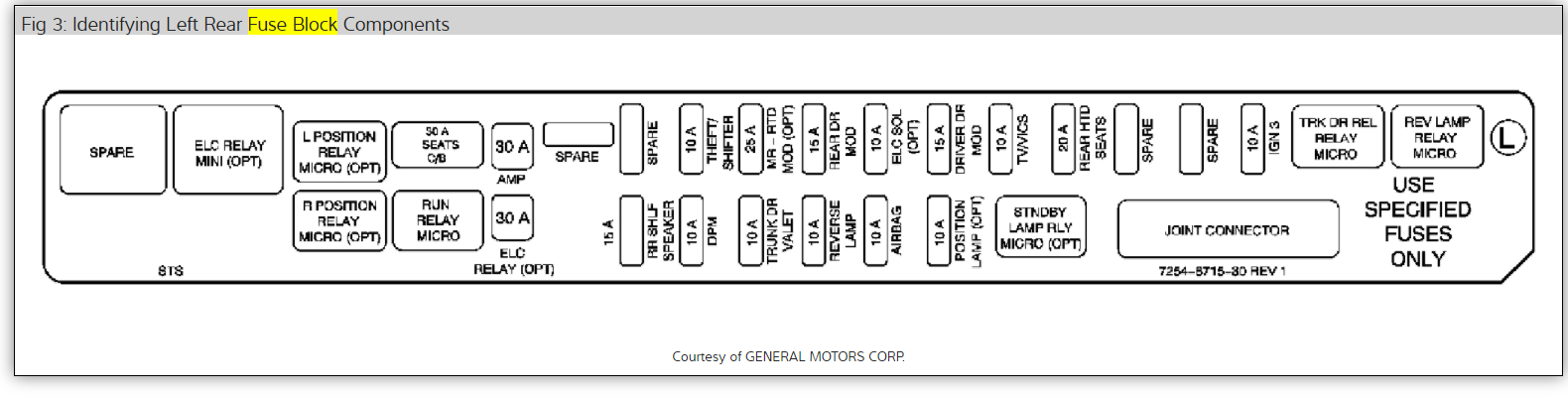

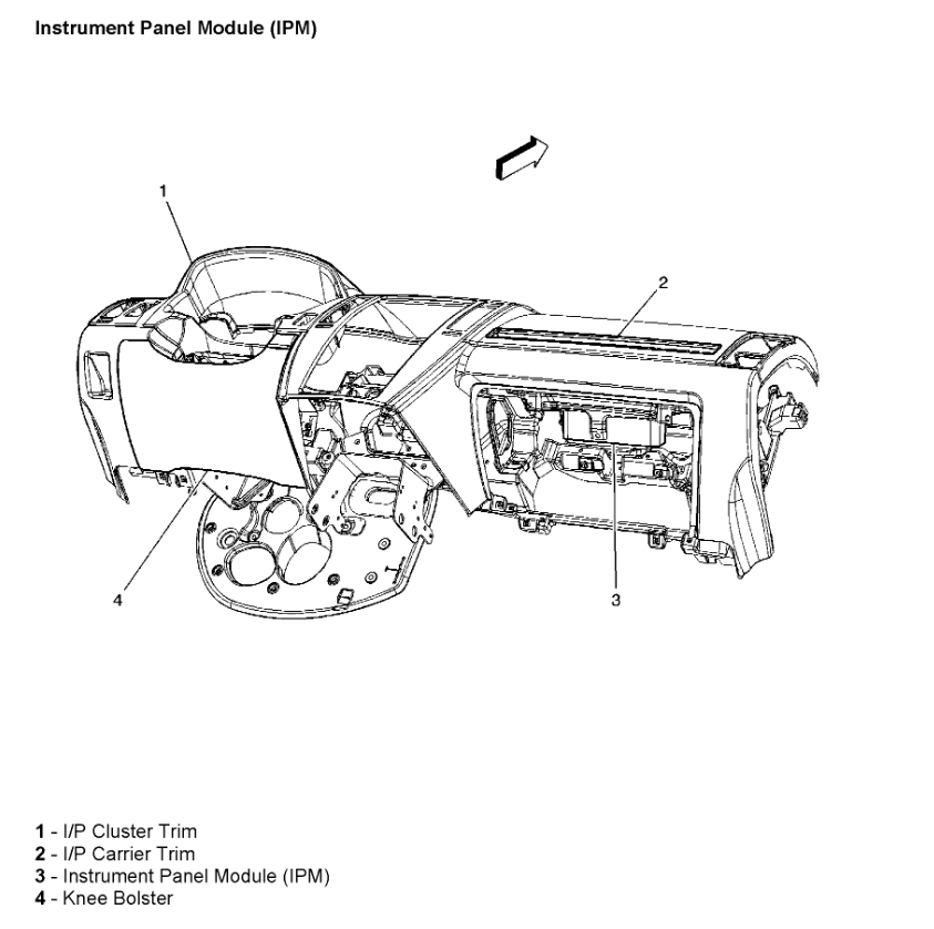

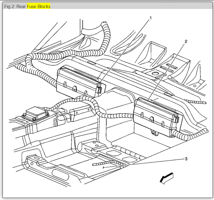

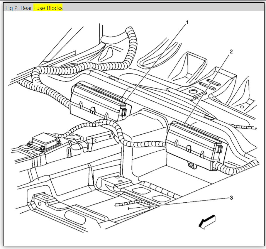

It sounds like you had a voltage spike when connecting the new battery or the car was jumped backward. Anyway the IPM sounds like it is not working correctly but to be sure we need to do a CAN scan which is the new way to fix cars which you can get a scanner from Amazon for about $50.00. Here is a video of the job being done with instructions on how to check the fuses (just in case) and how to replace the IPM below:
INSTRUMENT PANEL MODULE PROGRAMMING AND SETUP
INSTRUMENT PANEL MODULE (IPM) REPLACEMENT
If the instrument panel module (IPM) is replaced, the following procedures must be performed:
1. Setup New IPM
2. Program vehicle identification number (VIN)
3. Brake pedal position (BPP) sensor calibration
Refer to Body Control Module (BCM) Programming/RPO Configuration (IPM) Body Control Module (BCM) Programming/RPO Configuration (RIM) in Computer/Integrating Systems.
