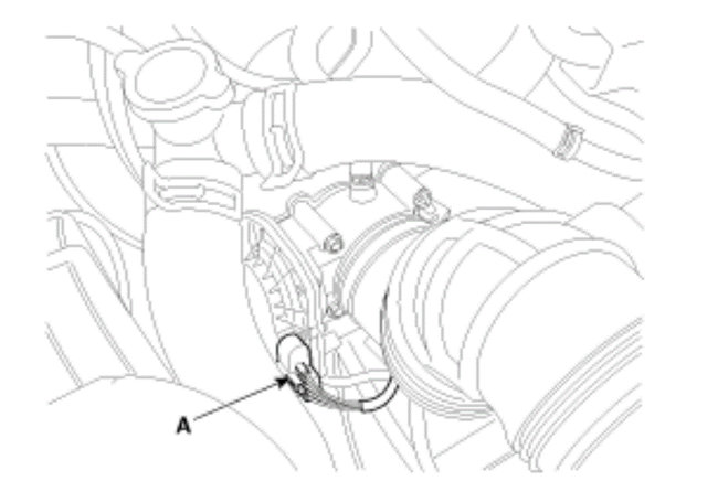

The idle speed is controlled by the Electrical Throttle Control (ETC) System. ETC system is composed of the throttle motor to operate the throttle valve and the throttle position sensor to detect the opening angle of the throttle valve, the accelerator pedal position sensor to detect the accelerator pedal position and the one valve type throttle body. The ECM controls the throttle motor to provide the proper throttle valve opening angle for the target idle speed.
We are going to try something simple first. The ETC has a relearn procedure. Try this and let me know if it makes any difference:
ETC module learning procedure
When installing new ETC module or re-installing it, ETC module learning procedure must be performed.
Hold the ignition key or the start button at the IG ON position during 5 seconds.
Turn ignition switch off and then start the engine.
I attached two pics below showing location. If the relearn doesn't help, check the connection for damage, corrosion, and make sure it's tight.
Let me know what you find.

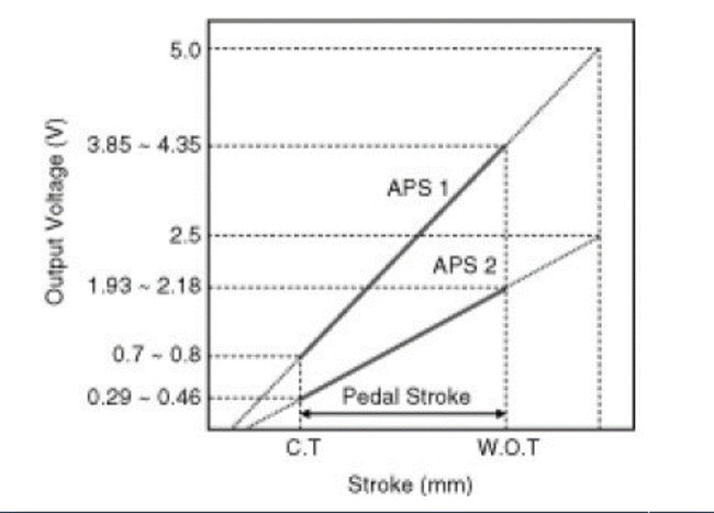

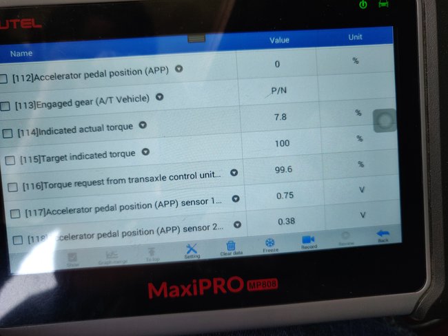

Here is the test procedure for the accelerator pedal position sensor. The attached pics are the electrical specs.
Lets start with that. Let me know what you find.
2014 Hyundai Veloster L4-1.6L
Component Tests and General Diagnostics
Vehicle Power-train Management Fuel Delivery and Air Induction Sensors and Switches -
COMPONENT TESTS AND GENERAL DIAGNOSTICS
Inspection
1. Connect the GDS on the Data Link Connector (DLC).
2. Turn the ignition switch ON.
3. Measure the output voltage of the APS 1 and 2 at C.T and W.O.T.
The two pics below show the voltages you should see when checking. Note CT stands for closed throttle. WOT is wide open throttle. I would think we are most interested in the CT to see if it is within spec and if there is any variation in voltage without moving the pedal.
Try this and let me know the results. If you have other questions, let me know.

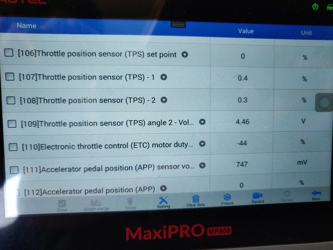

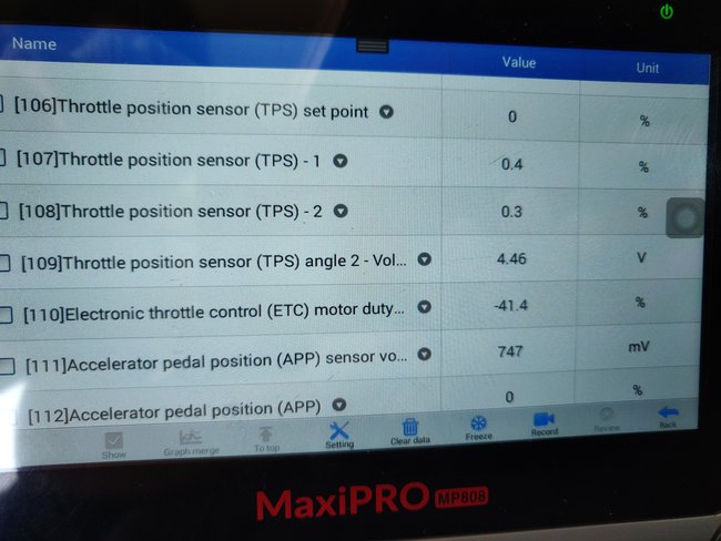

Sorry for the late reply, I did a can bus scan zero across all the systems. I did the other scan for the APS or in my scanner it was app anyway for me the numbers seems to meet the same numbers in the pictures I got from you, and I did upload some videos and pictures for the results, the video starts with closed throttle and I press the pedal to max so the video always starts with zero pedal to the max and the results in the videos will be from CT to WOT please check them, but according to my checking it meats the required specs, and by the way it shows also the numbers for the throttle body not only for the pedal so this may also be helpful.

Everything there looks normal. By any chance, was the problem happening when you were scanning it?

Yes, it was happening, but under the scan I can't confirm because the scan was while the car off and the switch on as the instructions, but before the scan it was happening ( while the car were running ). As I understand this scan should be while the car off and the switch on because this scan will show the voltage that's what I was able to gather. Now from the numbers it seems that's the pedal is working within specs, but the throttle body I can't confirm because I don't know how much the voltage should be, in the videos I did upload it shows the voltage for the throttle body so if you have anyway of making sure it's within the specs please check it. If all within the specs the throttle body and the pedal is out of the way. From your experience what might be causing this problem.
I know it's hard to know since you can't check the car in person but I am trying my best to get you in the picture about what is happening and I am really thankful for your help and what your are doing I really appreciate it. : )

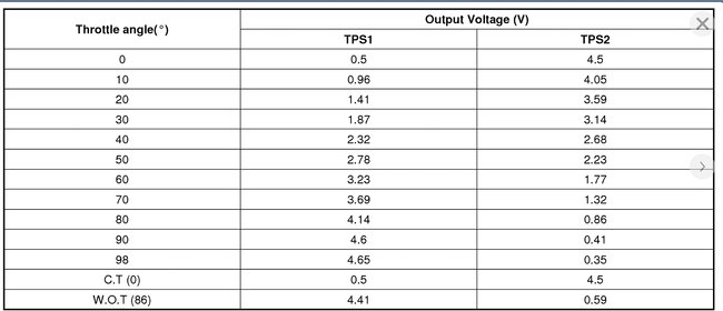

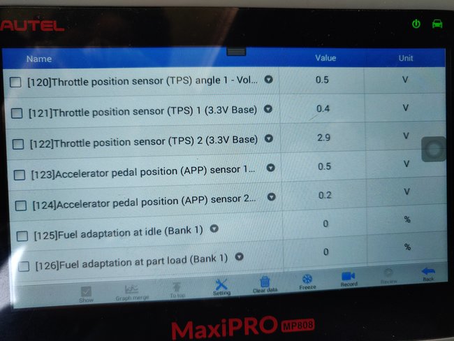

I attached a list of the TPS voltages for your review. I may have found a variation. Looking at the TPS2 readings with the APP @0, it shows .3. Take a look at pic 1. It shows it should be 4.5v. I am looking at the first pic you sent. Is that with the throttle plate closed?
If it is, I think the TPS is bad. However, I don't want to say replace it without a code to support it. Take a look through the specs I provided and let me know your thoughts.
Jul 30, 2020 at 12:45 PM
TIESTO870
  • 23 POSTS
You're right. The first picture with the plate closed CT.
The first video you can see it clear TPS1 and TPS 2 with CT and WOT the numbers don't match exactly can you check the first video, it starts with CT and after that WOT and CT and after that WOT, something I don't understand very will there was 2 types of TPS one just TPS and the other TPS 3.3V is there a difference? Or just another name for the sensor. Can you check it from your experience because for me the numbers seems different by a bit. Even TPS 1 starts 0.4 not 0.5 as the diagram and TPS 2 starts 2.9 not 4.5 CT and at WOT TPS 1 starts 2.8 not 4.41 and TPS 2 0.5 not 0.59
Should the numbers be exact or there's are room for error.
Thank you
Jul 30, 2020 at 1:01 PM
TIESTO870
  • 23 POSTS
It seems like both sensors are switched TPS 1 at the start close to the number from the diagram and TPS 2 is way of at CT, and at WOT TPS 1 is way of and TPS 2 is close to the diagram like they are switched or something.
