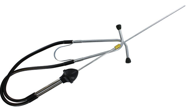

The alternator could be making that noise. Do me a favor. Here is a link that shows how to test an alternator to make sure it's charging. Try this and let me know the results. All you need is a multimeter or voltmeter.
Are you able to tell if the sound seems to be coming from the alternator? It's hard for me to tell. It sounds loud near the PS pump, but I can't be sure that is where it is coming from.
If you can't tell, you can get an automotive stethoscope and play doctor. LOL Basically, you place the tool on the components you suspect are making the noise to confirm. See pic 1 below. You can get these for under $10.00.
They are really cheap.
See pic below.

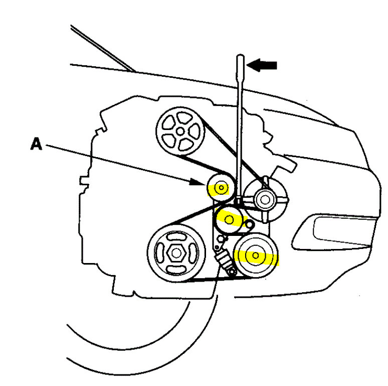

  • 110,193 POSTS
It could be the bearing in the alternator or other component. You may want to remove the drive belt and check each belt-driven accessory for play in a bearing or noise. Looking at the belt routing diagram (pic below) I see a belt tensioner, A/C compressor, and an idler pulley below and beside the alternator.
When you get back, let me know what you find. I would likely use a stethoscope.
Listening to your video, I have a feeling it's coming from the alternator, but listening to a recording could be throwing me off.
If you have a chance, let me know what you find.
