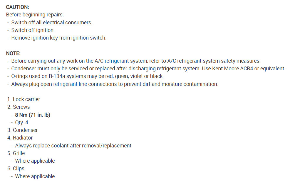

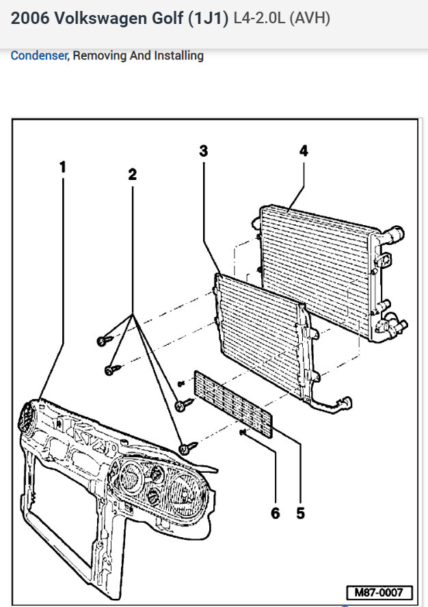

I would say the leak will be in the condenser which while in the flood something hit the core of the condenser and caused a leak. But to be sure I would add some refrigerant and then follow this guide to help you find the leak:
https://www.2carpros.com/articles/air-conditioner-leak-detection
This video will help you as well:
https://youtu.be/4EqdrBVb0sY?si=9h8CeGk6Cx-KBJZV
Please check out the images below to show you how to change out the part once you have determined there is a leak there. Check out the images (below). Please upload pictures or videos in your response to the problem so we can see what's going on.
