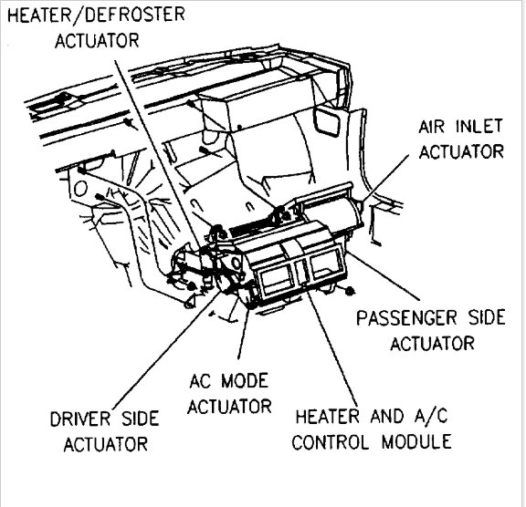

I recently replaced my entire A/C system: compressor, condenser, dryer, orifice tube, and charged with proper amount of r134 refrigerant. For a time it was cooling better but now not so much. I checked the system with a manifold gauge and got 45 on the low side and 225 on the high side while the temperature was around 88 F. After about 10 minutes of running it, I felt the low side pipe and it was freezing cold and a lot of water had condensed under the car.
Next I removed the AC blower from its place, and looked at it as I turned on the AC at different speeds. Speed changes accordingly, and at high speed it spins very fast as it should. My car doesn't come with a cabin air filter so I know it's not that. What else could be causing a weak and barely fresh air flow from the vents?
Jul 22, 2025 at 12:15 PM
  • 55,845 POSTS
Most of the time this will be a problem caused by "mode" actuator. I would remove the actuator but leave it plugged in and then turn the system on to make sure it moves when working the controls. You can also move the blend door pivot by hand to see if it makes a difference. Here is the location of the actuator and a guide to go over as well.

Okay, I just ordered it. Also, regardless of if it's just one bad actuator, would you recommend changing all of the 3 actuators on the driver side? Since they're all the same age. Thanks.
Jul 23, 2025 at 4:41 AM
  • 55,845 POSTS
It would not hurt since you will be in there anyway. Here is how to reset the system so they calibrate correctly:

I replaced the top 2 actuators. The bottom one (AC Mode) was the only one working fine. But it still doesn't seem to blow colder from the middle and driver side vents. Could it be some sort of blockage or a problem with the evaporator itself?
Jul 28, 2025 at 12:53 AM
  • 55,845 POSTS
O ya, what happens is people drop things down the vent system which can hold the blend doors open, such as coins, toothpicks, ink pen etc. I would remove the actuator on that side and work the blend door pivot by hand, see if you can hear it close in both directions. This guide may help:

So upon closer inspection the middle actuator (Driver Side Actuator) was not turning at all when operating the AC settings. I tried to turn the pivot by hand and I couldn't. But with some small pliers I was able to turn it. However I turned in both directions as far as I could but there was no change in the meek airflow coming out from the middle vents.
Aug 2, 2025 at 9:31 AM
  • 55,845 POSTS

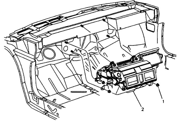

Hmmm this is a bummer, this means the blend door has fallen apart internally the HVAC box will need to be removed and disassembled, sorry.
Aug 3, 2025 at 4:55 AM
JUANEMMANUEL
  • 63 POSTS
Ok I see. Would you happen to have a diagram if the HVAC box?
Aug 3, 2025 at 4:59 AM
  • 55,845 POSTS
Sorry, this is all they give us.
