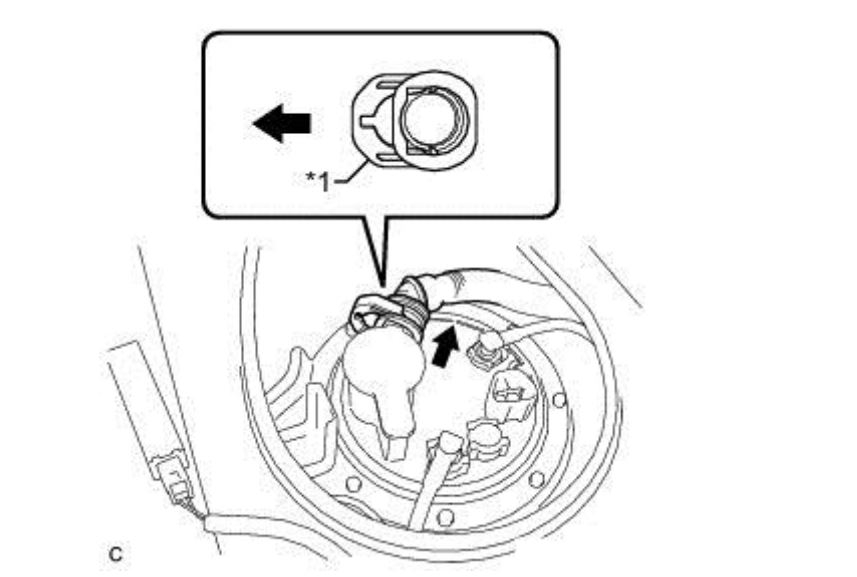

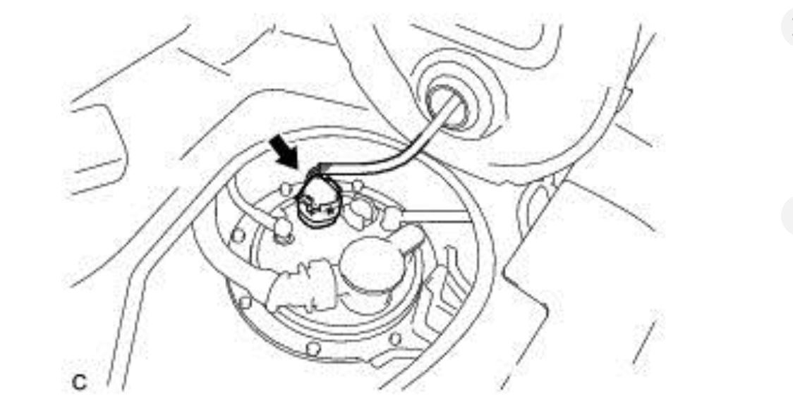

My car is the LE model and it has a weak start up.
Sometimes I have to turn the egnition and pump the gas to get it to start.
Once moving, it is fine. Sometimes at idle, it will turn off. It has a code for the
input start speed sensor, but I do not think that is this issue. I have heard it is
rarely the fuel pump and usually is the pressure regulator that is the problem.
Any advice? Is this a job I can do myself? Any instructional videos? Thank
you in advance.
Aug 15, 2018 at 9:22 AM
Good morning.
The fuel pressure regulator is part of the fuel pump assembly. You can just replace the regulator but since you are going to have to remove the pump, I would replace the pump assembly.
As far as the stalling, it may just be the throttle plate containing dirt and clogging up the passages.

6. REMOVE REAR FLOOR SERVICE HOLE COVER
(a)Remove the rear floor service hole cover.
imageZoom/Print
(b)Disconnect the fuel pump connector.
7. DISCONNECT FUEL TANK VENT HOSE
(a)Pull the tabs of the retainer to disengage the lock claws and pull out the fuel tank vent hose.
