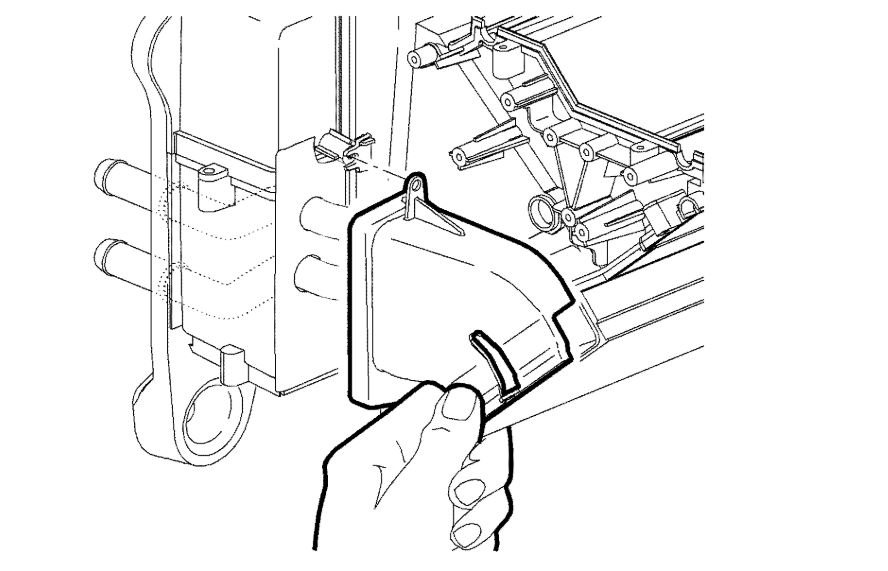

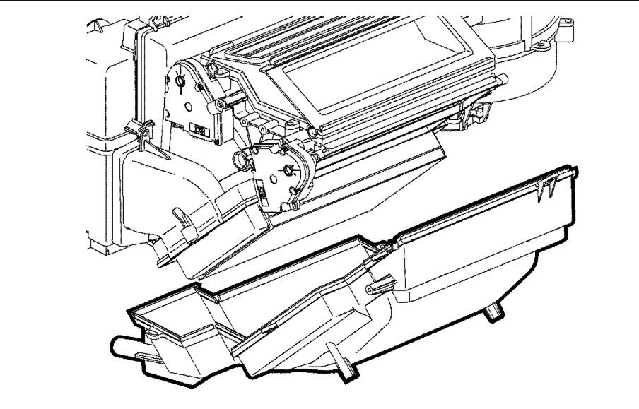

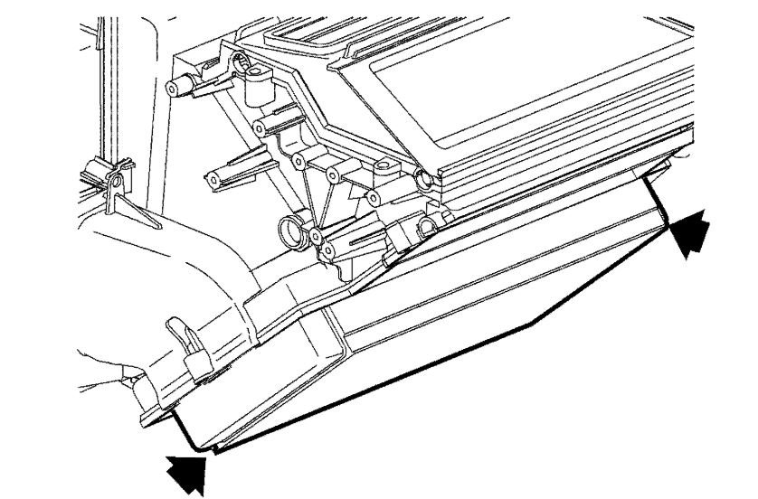

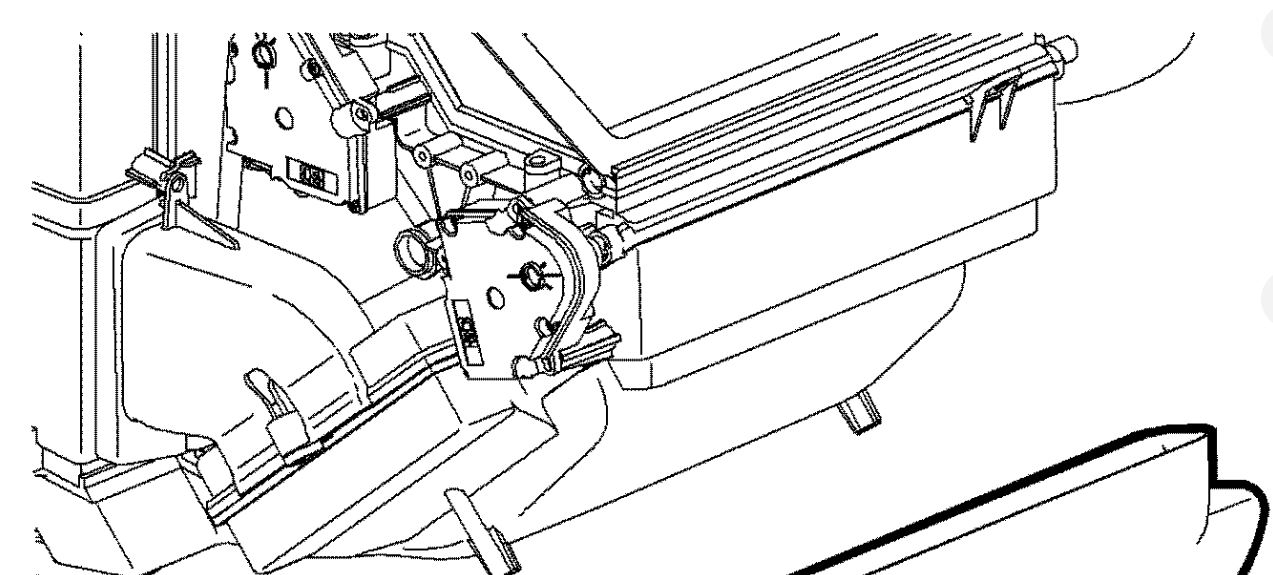

Removal Procedure
1. Drain the engine coolant.
2. Remove the heater outlet hose from the heater core.
3. Remove the heater inlet hose from the heater core.
4. Remove the instrument panel retainer.
5. Remove the shift control bracket. Bracket Replacement in Manual Transmission -- Getrag 5, Transmission Control Bracket Replacement in Automatic Transaxle -- AF33-5, or Transmission Control Bracket Replacement in Automatic Transmission -- VT25-E.
6. Remove the heater duct screws.
7. Remove the heater duct.
8. Remove the heater core cover screws.
9. Remove the heater core cover.
10. Remove the heater core pipe cover screw.
11. Remove the heater core pipe cover.
12. Remove the heater core pipe foam seal.
13. Grasp the heater core at end tanks and remove heater core. Spray the perimeter of the heater core seal and the heater core pipes at the front of dash with a soap and water mixture to ease removal.
