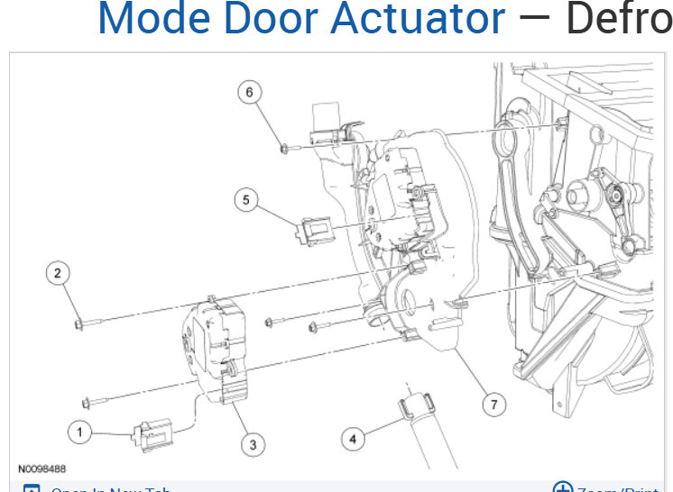

  • 55,423 POSTS
It sounds like the mode actuator is not working here is the location. This is a common problem. Check out the images (below). Let us know how it goes

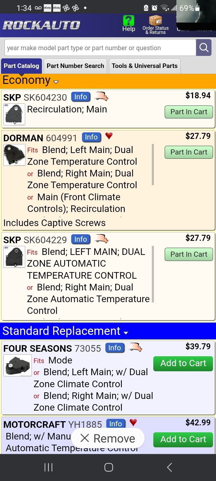

JUANEMMANUEL
  • 63 POSTS
Also do you know which of these parts would it be?
Sep 10, 2025 at 4:35 AM
  • 55,423 POSTS
It says to remove the instrument panel so I am going to say it is on the left side. I would go with the motor craft part. Make sure it says "mode" for the actuator.

So I changed the mode Actuator on the driver side and I didn't have remove any panels or dash pieces at all. I just had to reach up above the brake pedal. The mode actuator (lower one) was not moving at all when changing the temp from cold to hot and vice versa. I installed the new one and now it does move when the changing the temp. The other actuator on the driver side (above Mode Actuator) and the one on the passenger side, both work fine and move as they should. However, the airflow is still weak even when the fan is set to highest. Will the problem be a physical obstruction in the ducts? Thanks.
