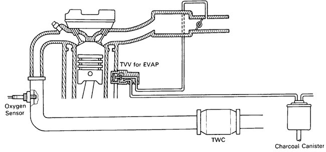

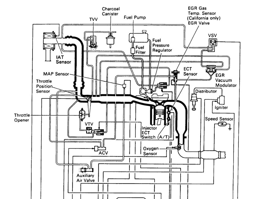

We need help hooking up vacuum hoses
1994 TOYOTA PASEO
250,000 MILES • 1.4L • 4 CYL • 2WD • AUTOMATIC
YOGI84
When did the throttle plate sadly I can remember I was just goes to what also undead two hoses from the throttle plate seem like they go to the coolant system

Here's a couple of schematics for you. One is the EVAP schematic and one is engine control. But they are both for your 1994 Paseo. The Evap is for Non-California models.
