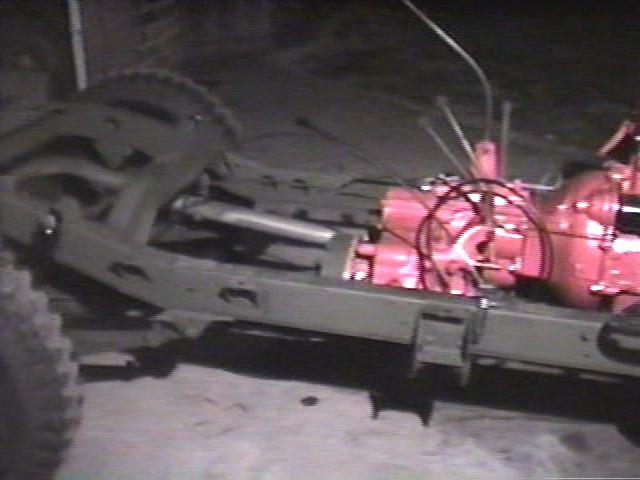

We have a body. Thank y'all for your help!! My main problem is getting an inventory list together and diagrams. He has worked on vehicles but has never basically put one together from scratch. We have transmission and motor runs. We are not sure the transmission works. The body is in good shape. There is no dash meters, head lights, parking lights, reverse lights the carb isn't in good shape we want this road and off road durable. We want a beast so to speak.

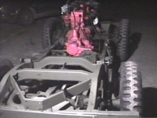

IT'S REALLY PRETTY SIMPLE
IN LESS THAN 5 MINUTES YOU COULD BE ROADWORTHY...

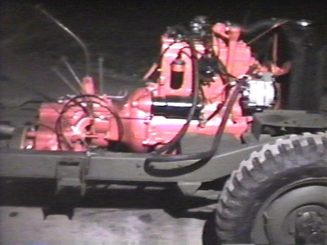

BEST-US THING TO DO IS START OUT CLEANING/ SANDBLASTING THE FRAME....PRIMING AND PAINT....ANY WELDING OR FIXES
REPLACE/ REPACK BEARINGS AND NEW SEALS IN THE AXLES AS WELL AS SEALS AND SUCH ON THE TRANNY AND TRANSFER CASE
THIS WOULD BE A GREAT TIME TO INSTALL A CLUTCH AND REPLACE UNIVERSAL JOINTS
THEN THE BRAKES....WHILE IT'S LIGHTWEIGHT AND EZ TO GET TO...ALSO KEEPS YOU FROM MESSING UP BODY AND PAINT LATER
.........I RECKON YOU SAW MY "WILLY" PICS IN THE 1ST LINK I SENT????

Thank y'all for your help. I will definitely have more questions I am sure. The frame on your pictures looks almost exactly like the frame we have. Those are some awesome jeeps!!!
